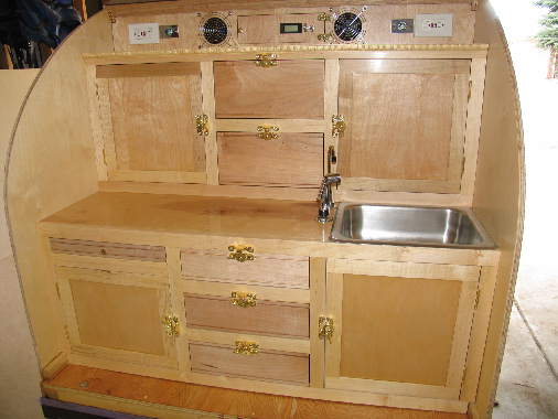

Postby tony.latham » Thu Aug 09, 2018 11:21 am
Sink in the galley, do you guys think it is REQUIRED or necessary?
I think they are a waste of space. They're tiny to begin with and require plumbing down below which takes up more space.
I build my gallies around the stove, a specific cooler and a 7-gallon Reliance water jug.
On my next build, I'm planning on using a 13" x 18" Partner stove that will be on a slider on the left and will come out at 90º. Below it will be the Reliance jug that's also 13" (or 12"?). That will open up more counter space.

Postby bdosborn » Thu Aug 09, 2018 8:38 pm
Isn't that funny, I always thought the the sink should go in the galley and cooler shouldn't.
I never regretted putting the sink in the galley but I did regret not using sliding doors above the counter. The swing out doors means you had to clear the counter to open them.

Re: Fiberglass Teardrop
Postby Staryder61 » Fri Aug 10, 2018 5:59 am
bdosborn wrote:Image
Bruce, very good point on the sliding doors, wish I had thought of that on ours.. :thinking: ;)
Postby tony.latham » Fri Aug 10, 2018 10:04 am
Nope, Bruce, you're wrong and I'm right. :frightened:
This forum would be the most boring place in the galaxy if we all built the same way.
Postby bdosborn » Fri Aug 10, 2018 10:55 am
Boy, you sure aren't kidding. :? :thumbsup:
