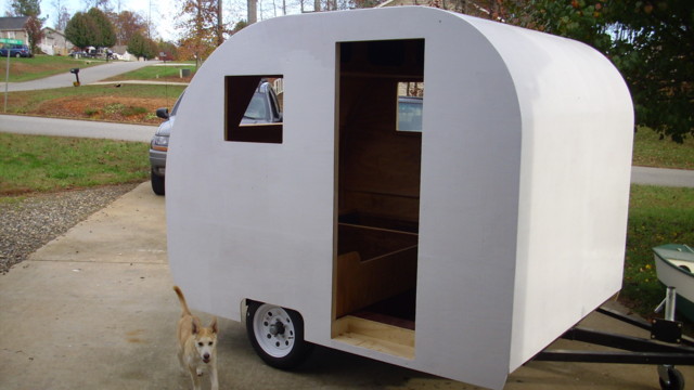

Postby shopfabricator » Sat Nov 14, 2009 3:16 pm
Inside Stained, Outside White Primed, Sam Close.

Postby Chris D » Sat Nov 14, 2009 5:01 pm
Gary,
That is one sweet trailer. It looks really nice painted. What kind plywood are ya using? Also sorry about ya boy I lost my guy about 3 months ago :( Sam will help ya heal though good lookin dog.

Postby shopfabricator » Sat Nov 14, 2009 6:17 pm
Hey Chris! Sorry to hear about your buddy. :(
You are absolutely right about Sam helping me heal. I hope you will be able to Adopt another friend too!
The ply is all BC Ext. with the B side IN. It still requires a bit of sanding, but for the price versus Cabinet Grade, I couldn't beat it. I have had to watch for voids and fill as needed, but it hasn't been a big deal.
Now that the exterior has color on it I can really see what it needs for final finish. I will be sanding and filling with body filler before what I am sure will be two more coats.
The interior required Stain Conditioner before staining to keep it from looking blotchy. I'm pretty happy with the color and consistency and the rag from the conditioner acted as the final tack rag too! It will be getting a couple coats of poly with 120 grit sanding in between.
Hope this helps.

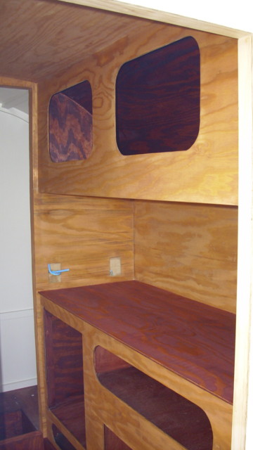

Postby mikeschn » Sat Nov 14, 2009 8:49 pm
Did you do any painting on the inside? Any pics?
Postby shopfabricator » Sat Nov 14, 2009 10:37 pm
Chris, That's right, If they want MY money.....
Mike, The only paint is the interior of the porta-potty closet. Used some high gloss latex ext. stuff that I use on small boats. To break up the solid wood stain color I have used a light pine stain on the "show" surfaces and a red chestnut stain on the floor, counter top and interior of the storage cabinets. The cabinets are of the "stuff hole" variety without doors so they make a nice accent to the overall look. Here is a pre-poly shot to give you an idea of the contrast.
I guess that by doing this, red will almost have to be the decorating "theme".

Postby grizz » Sun Nov 15, 2009 2:49 am
Sad news about one friend, happy you got another.
She looks very very bright..... you will have to watch her, she will have you wrapped around her puppy tail in no time.
Loving the interior and shape of the holes in there.

Postby shopfabricator » Sun Nov 15, 2009 11:37 am
Thanks grizz.
Another Stain Contrast Shot.
