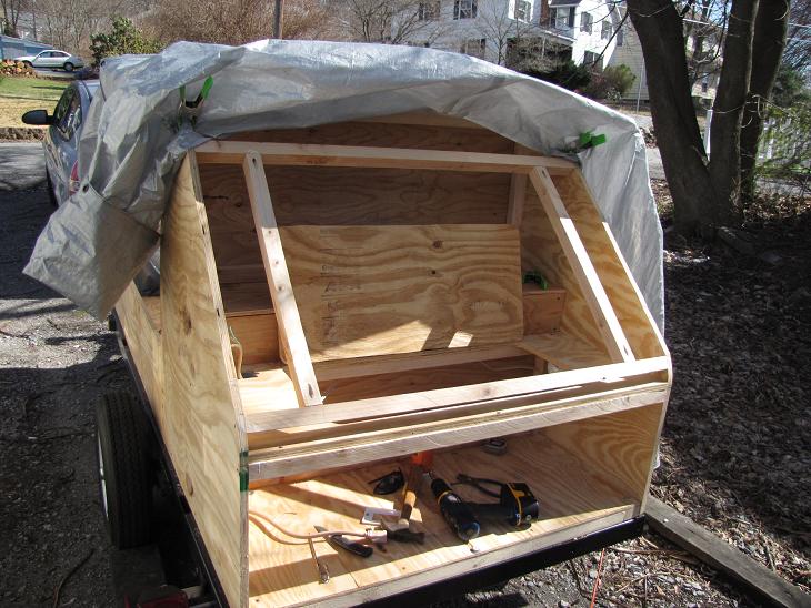

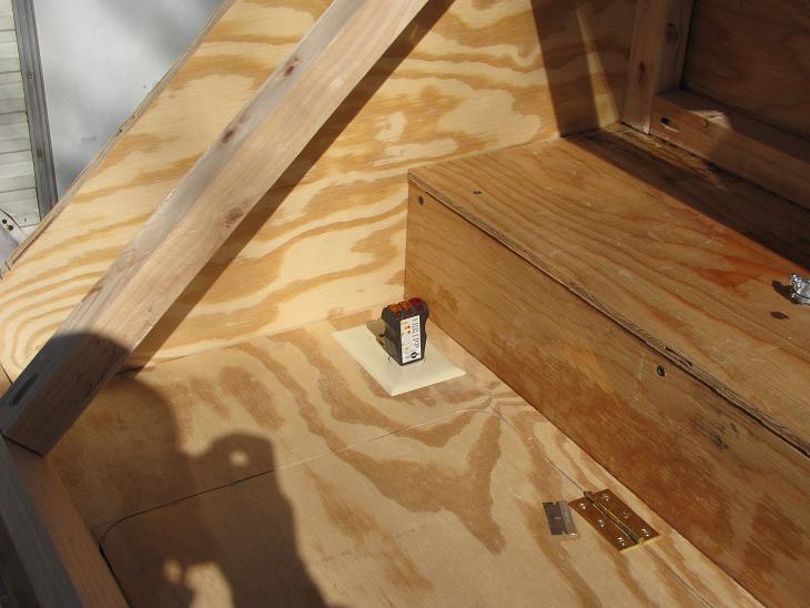

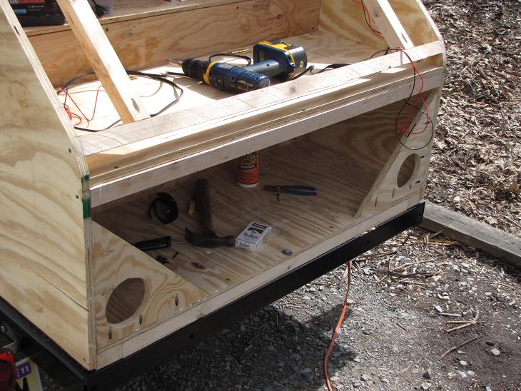

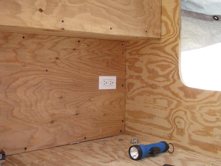

Last night I was able to start the 110v wiring, and even though the day was very cold, 38 degrees, I spent time between warmups working on the trailer. I installed the countertop..
and here you can see the access to the storage area.
ground fault outlet in the cabin area...
and power for the galley, with my tester installed. I doubt you can see it, but the two yellow lights are on which means... AOK!

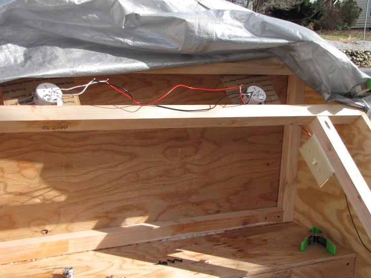

here you can see the switch for the galley lights, and the galley lights temporarily installed on pieces of cardboard. When it gets dark tonight I'll turn them on and see if I need to do some rethinking about the location.
I also got the interior light mounted, just inside the door so it is easy to switch on prior to getting inside. Because my walls are solid, the wires are dangling right now, but I plan to cut a piece of wood with a channel to hide the wires from sight, it's just too cold to drag the table saw out of the shed to do that today.. tomorrow's forecast is sunny and 50 degrees, so I hope to get that done, as well as shaping some of the spars around the curves. I still need to think about the tail light mounts too.

Looking great :thumbsup: As far as tailights go, you could run a 1x4,1x6 done the side of your storage compartment and they would be off to the sides. I don't know the thickness of your light but being close to the side, if you had to box them in it wouldn't protude into the compartment that much. Or go with some Model A lights and have one with licenseplate white light to be "Legal". Being an old biker/rodder, that way only the wires would be in the compartment with no wasted space. '39 Ford teardrop lights wood be cool :twisted: One question..why didn't you put that galley plug-in into the wall right above it so it wouldn't take up counter space?? Just asking for when I Steal your design :thinking: Isn't figuring this all out FUN!!! Keep up the great work!!
Til later by the fire--John T. & Linda 8)

Postby parnold » Sat Mar 27, 2010 9:10 am
If I mounted the box on the vertical wall, the wires would show in the cabin, that's just a 1/2 sheet of ply there, by mounting it on the counter, the wires are hidden in the storage area.
I have 4" round flush mount lights, so I just need to have something more substantial than the outer skin to screw them into, again, all the wiring will be inside the storage area. In the event of any future wiring issues, for the most part, all the wiring will be in one place.

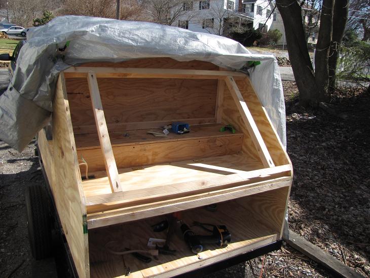

Postby parnold » Sat Mar 27, 2010 5:09 pm
Got some more done today, a few hours of sanding various things, rounding out the spars to ease the bends, etc. I made a couple mounts for the tail lights to screw into, so there is something more substantial than just the shell.

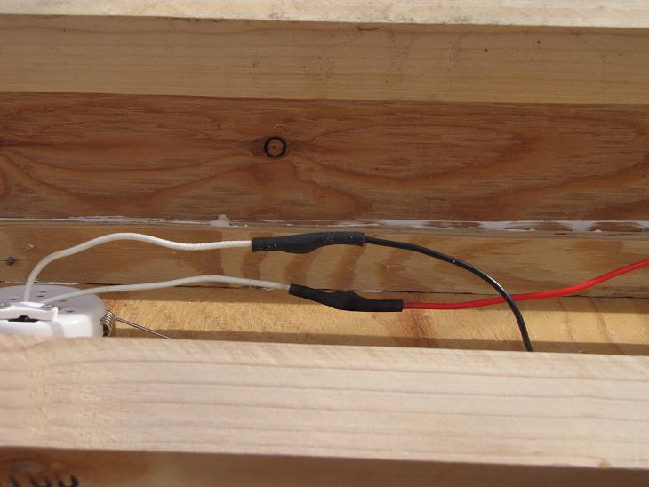

I changed the angle of the galley lights slightly, and built a mount for them, then soldered the wires and heat shrunk the joints.

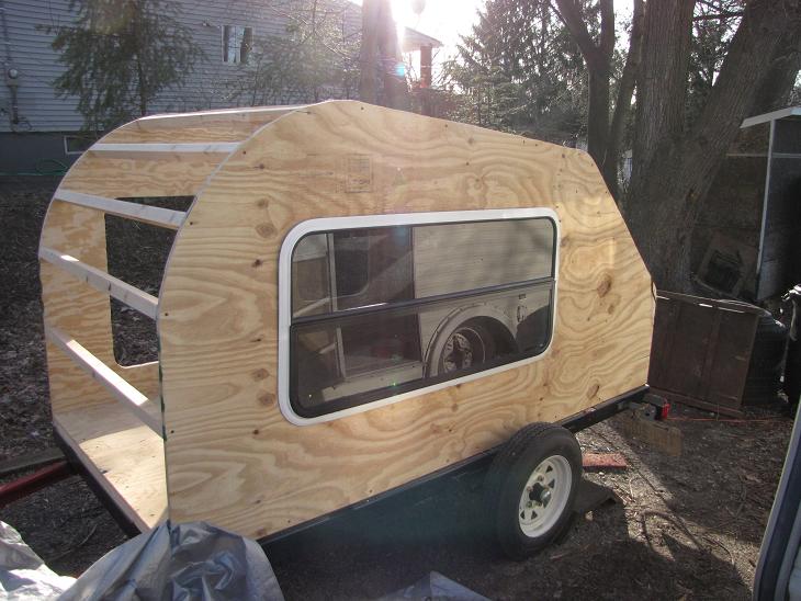

Before I ran out of steam, I fit the two windows and the entrance hatch. I had cut the holes just a slight bit to small, so some work with the sander to get them perfect and they all fit very snug!
I still need to run the tail light wires, and hide the wires in the cabin, but now I am just waiting for a couple days of warm weather so I can apply the luan skin and start applying the polyester resin. I figure with two warm days in a row, I can give it the first coat on the first day, sand it the morning of day two, and apply coat two on the second day. I want to apply three coats, but at least with two on there, I won't worry about the luan getting wet.
I went to Wally world and bought a quick up shelter since I discovered that the tarp I am covering it with leaks a little. I think with the shelter, and the tarp, I should be good..... and yes I will stake it down. It's supposed to rain here Monday and Tuesday.
