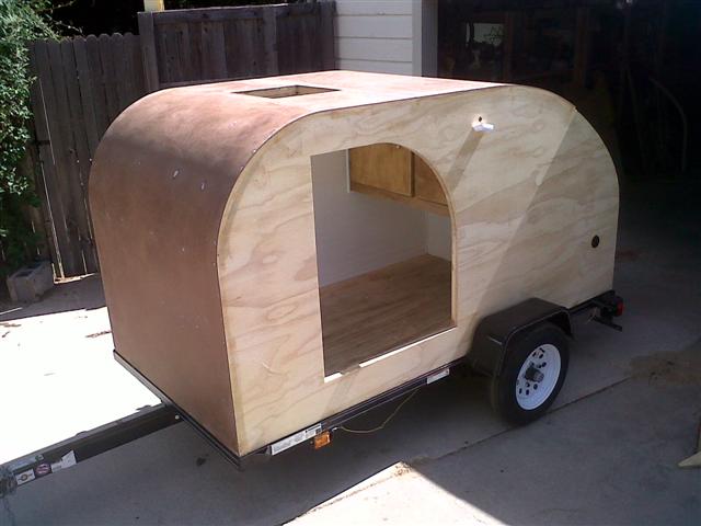

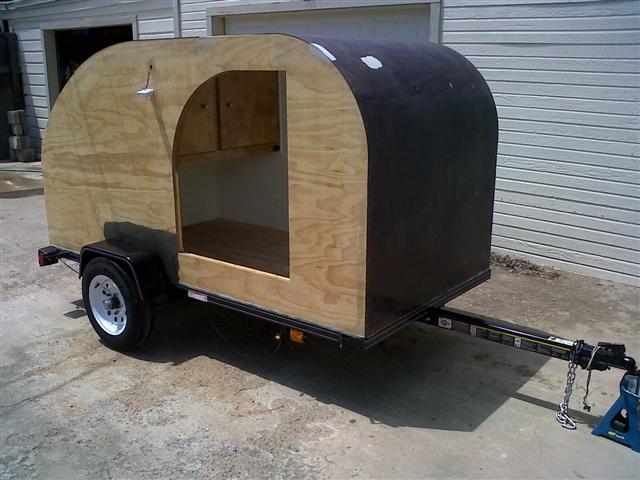

It's now completely skinned! The PL Premium was great. Plenty of working time in hot/dry weather and it bonded well. I trimmed the edges and cut the vent hole with my allmighty router trim bit.
I bought some epoxy filler ($18.26) for the staple holes. I'm going to be prepping everything for resin with a little fiberglass here and there for good measure.
This part went really quickly. I've worked about 5 hours since the last update.
RUNNING TOTALS: $1294.83 and 75 hours.

8 hours and $255.55 later I'm working on the epoxy. I bought a gallon of Silvertip, paint and misc supplices like chip brushes, etc.
It's been a love/hate part of the process. It's been really tough to get a smooth finish but it looks like it'll be really durable. I fiberglassed the roof seam and the rest is resin over wood in 2-3 coats. I didn't include pics in this update since there's not much to show!

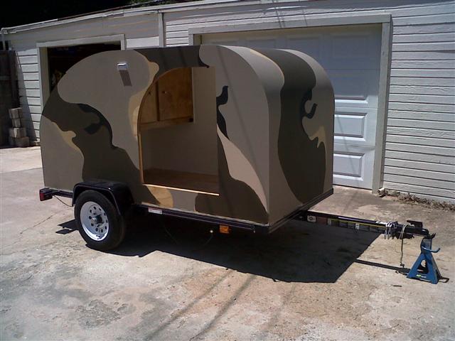

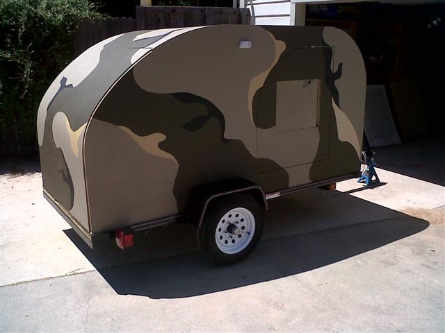

I took some time off work last week to work on the finish. The paint went over the epoxy MUCH smoother than I expected. Although the camo paint job takes a lot of time, I think it's worth it. I went with a MERDC Desert Gray scheme. My first choice of colors wasn't matched carefully and it came out pink and green. No, no pictures of that. I'm trying to forget it. Fortunately it was only a $20 mistake.
I'm going to finish sand the paint to even it out a little and finish with a flat enamel clear coat of some kind.
I guess this opens another realm for names!
15 hours since last update.
Here it is with the resin done:
And here's the camo paint (most of it, anyway!:

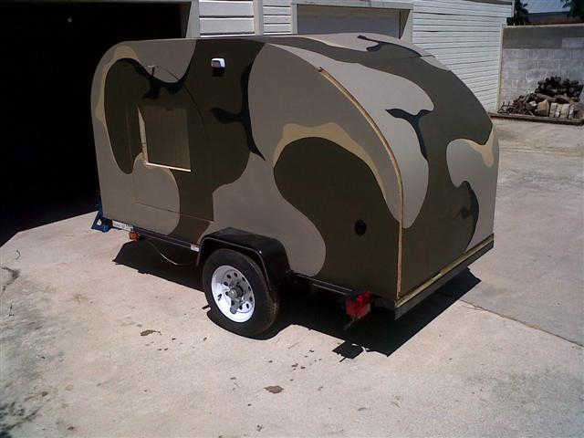

My wife and I spent 4 hours finishing the details on the paint. It has to cure for a week or so before anything else can be done. I'm in the home stretch!

Thanks, Ratkity! It looks like an oil painting up close but I'm happy with the "curb appeal."
Xddorox, some nose art sounds great! I'll start brainstorming.
The white porch lights are driving me crazy. I just may have to Krylon them a more suitable color.
I'm going to have the aluminim trim powder coated if I cant find a good way to paint it. The wheels definitely need to be black.

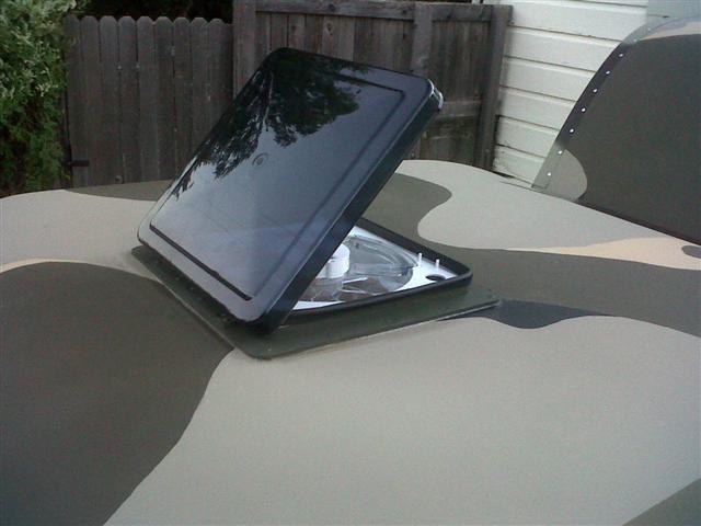

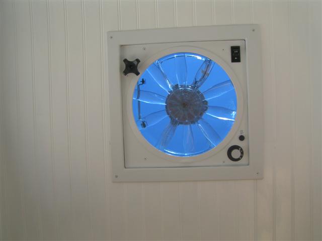

+1 hour and $143.99 for a Fantastic Vent 4000R. rvvent.com is awesome. I sent the dimesions and they pre-cut everything. It popped right in!
I also painted the porch lights to match the paint scheme. I'll do the same with the exposed parts of the fan after the caulk dries.

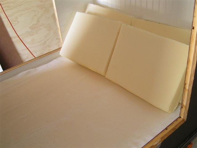

In two more hours I managed to get the body bolted to the trailer and the mattress cut to size and put in. I used the leftover foam to cut four pillows. I used the 4" foam topper memory foam that several people here recommended.
Since the last update I bought some extra paint, the mattress, hinge, windows, and drip rail.
Running totals: 105 Hours, $1872.03
