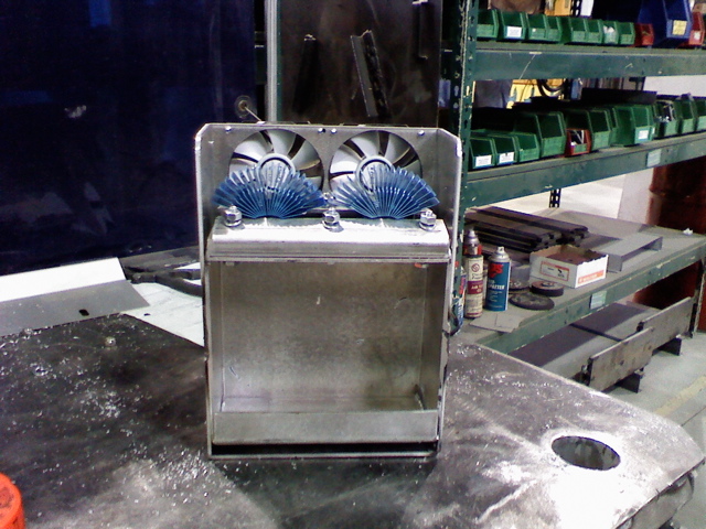

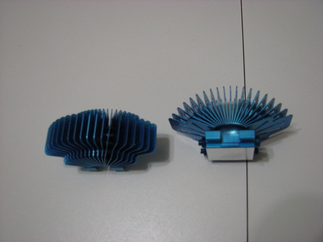

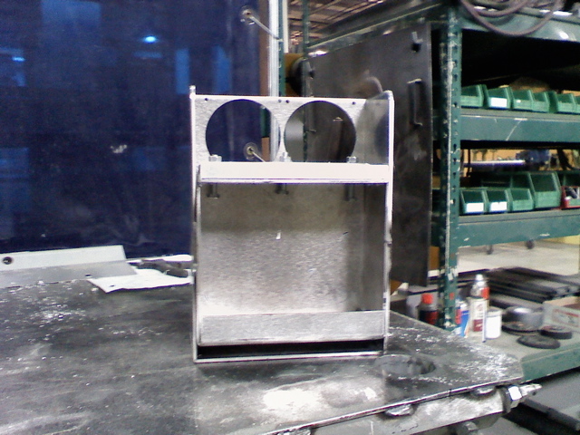

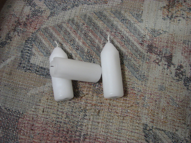

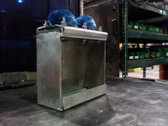

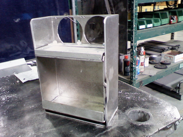

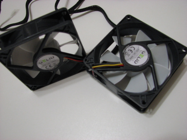

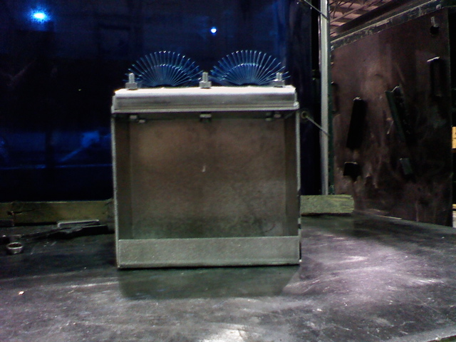

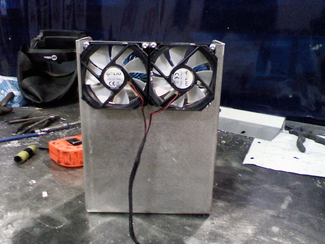

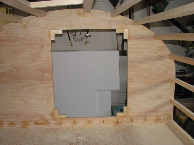

sdave209 wrote:I guess "forced air furnace" might be over selling it a little. Ya, it uses "9hour candles". Its just an aluminum box with a 1/2" aluminum plate on top and 2 computer heat sinks. That fits into another aluminum box that has 2 80mm computer fans in it and the whole thing has an expanded metal front on it. The candles heat the plate, the heat sinks dissipate the heat and the fans blow it off into the TD. Very simple, hardest part was thinking it up.
