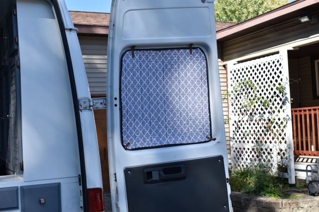

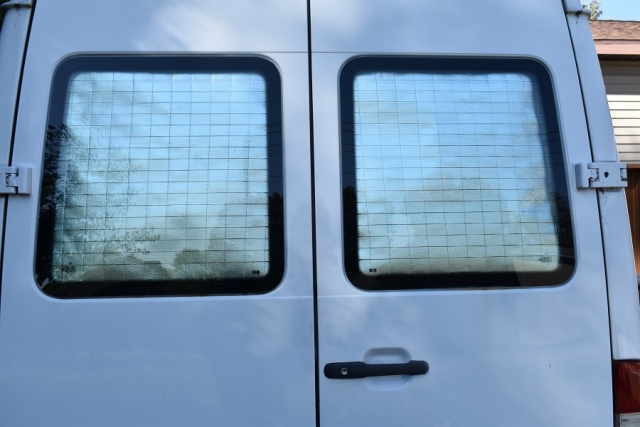

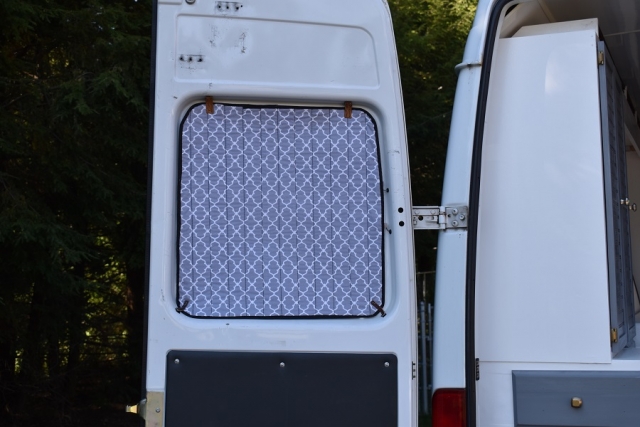

I finished the blinds for the rear doors.
Then I started on the gallery rail. After pricing the brass gallery rail for the complete job. I went into sticker shock. So changed plans and went with the wood railing.
In the pic above you will see I added a small cabinet. That's for electrical mainly. I don't have the time to finish a door before we leave.
In the first two sections of railing you can see the windshield and door blinds.

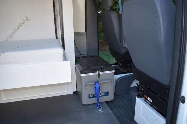

This pic shows where the cooler is located.

No swivel seat on eather side. I have been thinking about one on the passenger side. I can't do one on the drivers side. It would raise the seat to much for me plus there is electrical under the driver seat. A swivel would make it harder to get in there if the need comes up.
The house battery is under the passenger seat.
