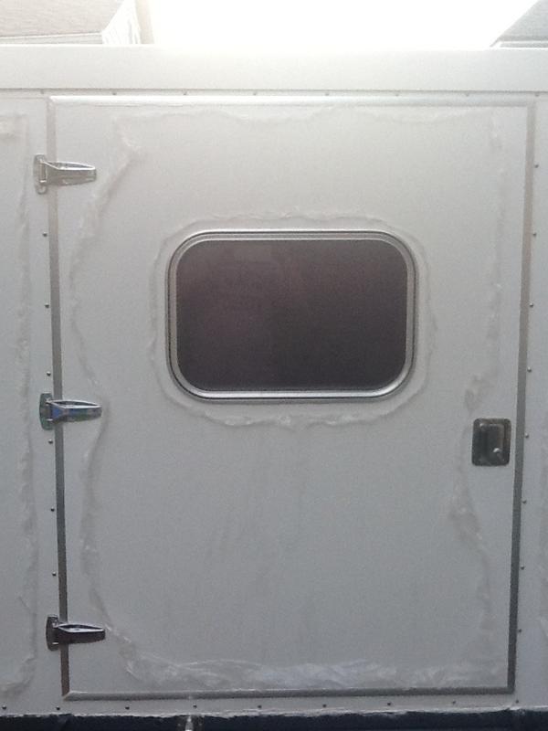

The majority of the day was spent on the rear door. I had dry fit the door components before, but today I put the door together with Sikaflex and made it permanent.
Looks like I could sell frozen meat from this thing! :lol:

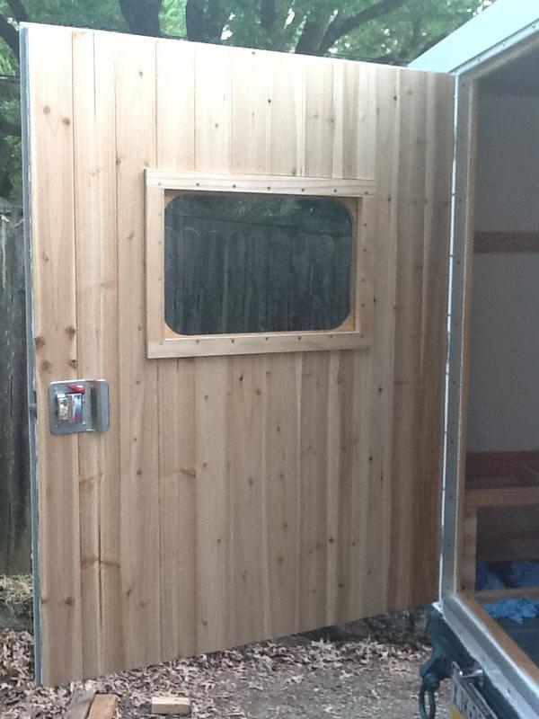

The inside of the door is 1/4 thick tongue and groove cedar planking. It came out great! Smells amazing too. I'll be using the cedar planks for the interior walls too.
The DIY trim ring I made for the window worked, too. I got a tight seal with the outside of the door using butyl putty tape. I need to make two more trim rings for the front windows at some point too, now that I know my method works.
The door closes well but still needs a few tweaks: The striker needs to move outwards 1/16 of an inch to match up with the latch. The inner door trim needs to be installed over the inner door edges, so that there will be a second, inner seal between the door and the frame when the door is closed. The outer seal using the T molding looks good and seems to work.
