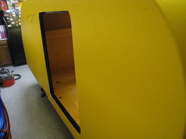

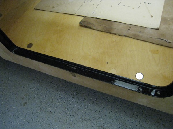

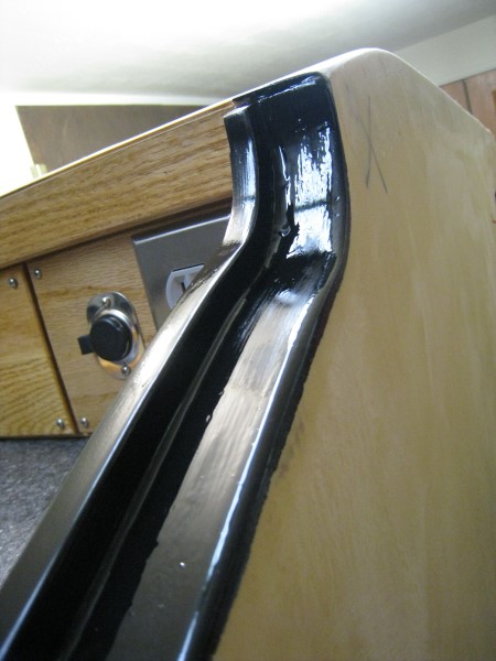

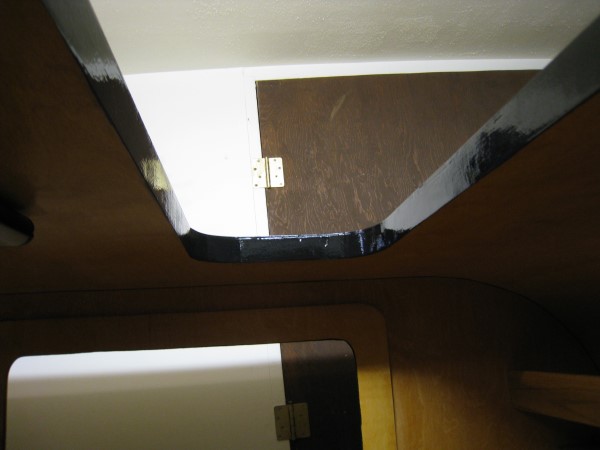

I got a lot of work done over the last 6 days. Over the weekend I painted the door seals, door edges, galley seals, and moon roof opening satin black using the Van Sickle two part paint. I rolled on two coats using a 4" sponge roller and 1" sponge brush for corners and small areas. I think it turned out pretty good and seems to be durable.
Door seal areas painted
Galley seal areas painted
Moon roof opening.

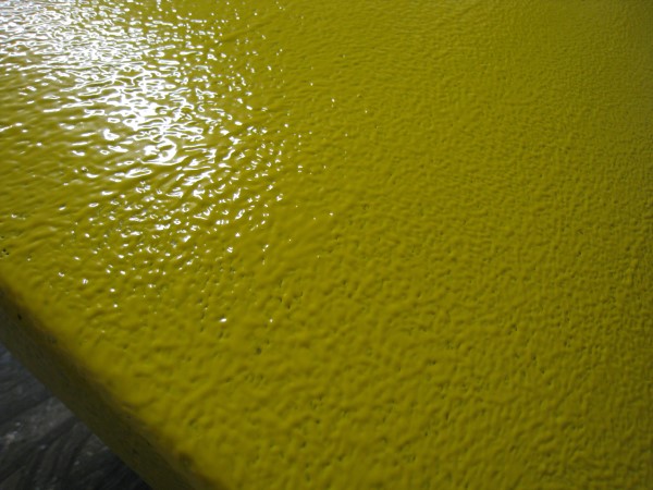

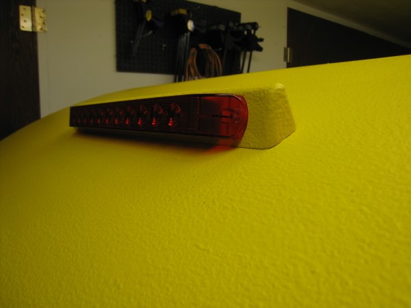

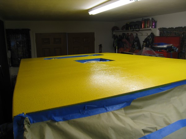

I then spent the next two days painting the body color Yellow. I use 1 1/2 gallons Monstaliner and gave it two costs with the their texture foam roller. It went on pretty good. I have a few spots I will touch up in the spring when it is warmer out. The paint stinks bad and for at least 2 days. It was hard to keep the smell out of the house. I painted in my utility room (basically a one car garage without a garage door) , I closed the door to the house, laid wet towels along the bottom seal, blocked the heating ducts with plastic etc but the smell still permeated throughout the house. We had to open the windows when it was 30 degrees outside to get fresh air.
I thinned the paint a little bit with MEK and got a pretty nice smooth texture. Here is a close up of the texture after first coat.
Here is the galley hatch lid painted
A side view after being painted and masking paper and plastic removed.
Here is a view of the roof painted

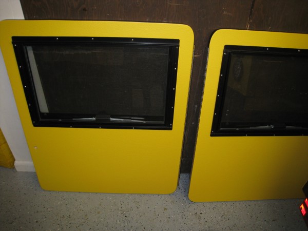

I had bought a roll of 1/16" black Butyl, RV, Camper, Putty Sealant Tape off eEbayt. I used it to install the windows, fan and moon roof.
Here is a picture of the door windows installed

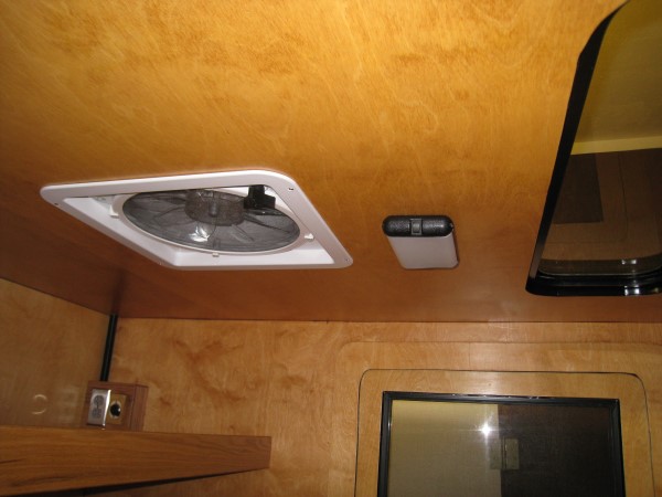

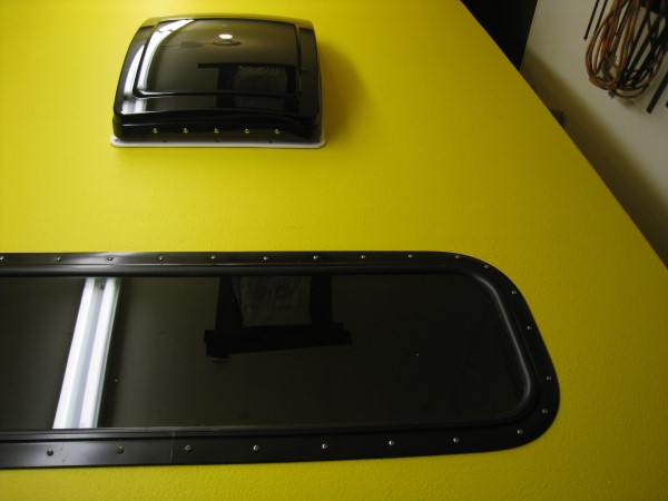

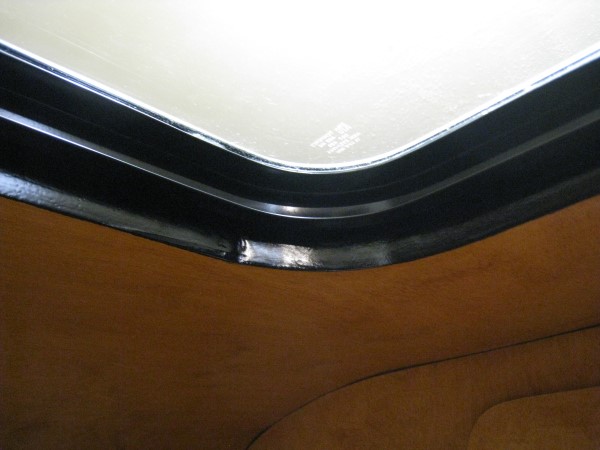

Here is an inside view of the moon roof installed without a trim ring. I just drilled holes through the aluminum on the outside and screwed it down to the roof through a layer of the Butyl tape.
Here is a view from the top of the moon roof and Max air fan installed

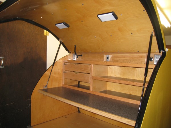

I installed the galley hatch lid and lights.

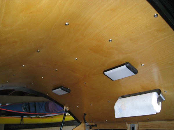

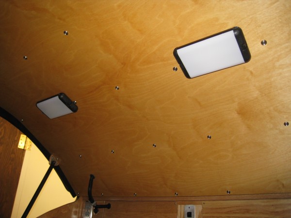

Ceiling view of light, moon roof and fan

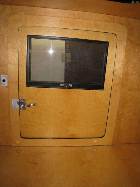

Door view with door installed

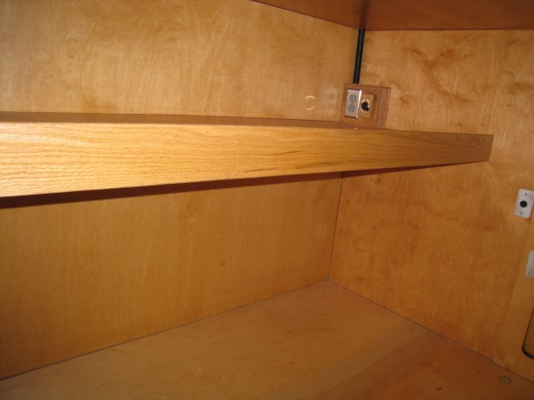

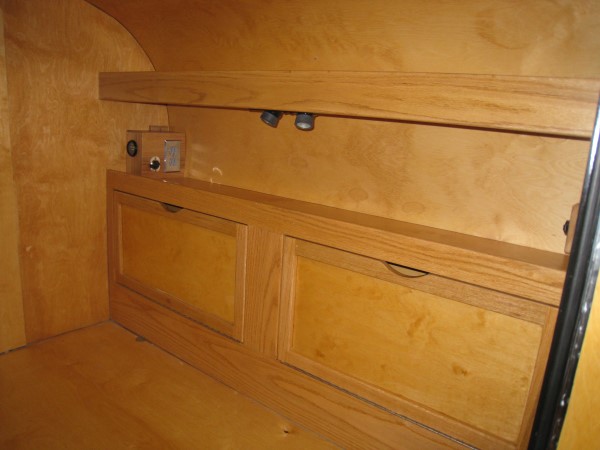

Feet view of storage shelf for gear
Headboard view with storage, shelves and reading lights
I also worked on the galley hatch and gas struts. I had bought 150 lbs struts but they were way to heavy and the hatch wouldn't close. I then tried 50lb struts and it works almost but won't stay up. I order 75 and 100 lbs and will return whatever doesn't work.
I installed my hatch lid inside panel and wired up the lights. I wanted the panel removable so I could get to the wiring. So I used 1/8" Baltic birch and installed with stainless steel decorated screws washers.

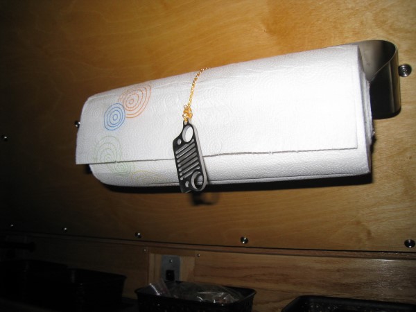

Here is my paper towel holder. All it needs is nice looking weight to keep them from blowing away.

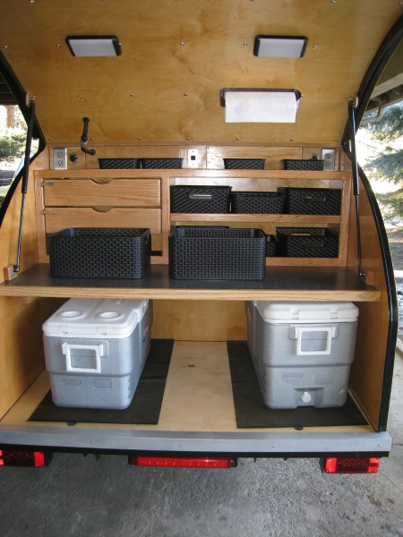

Here is the galley with baskets and coolers

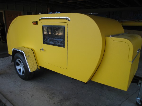

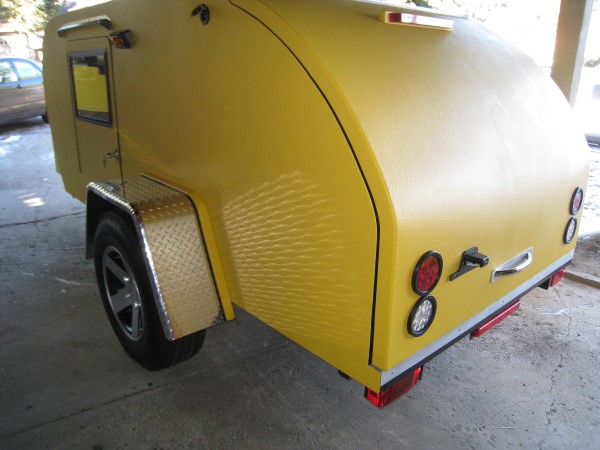

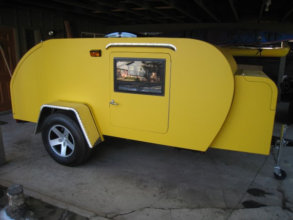

I move the teardrop outside and installed my axles, wheels and tires, fenders, and tongue box. Lots of detailed left to finish but I can now leave it outside under the car port and work on it as the weather allows and be ready for spring camping.
Rear side view
Front side view
Side view

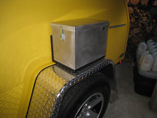

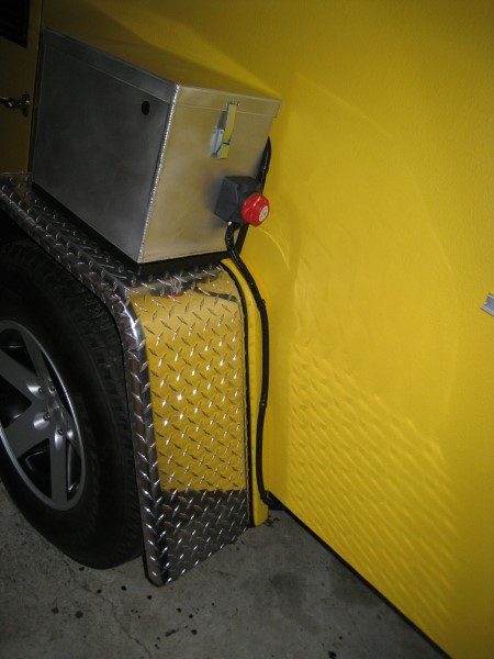

I bought and installed an aluminum battery box on the left side fender. I sanded the aluminum box with my orbital sander, coated it with Bull Dog adhesion promoter primer and then use Duplicolor high performance wheel clear coat. I built a wood spacer plate to allow the box to sit on the fender and bolt to the side of the teardrop. I epoxy coated and bed lined the spacer plate.
My original battery disconnect switch was to go inside the battery box but it was too big so I decided to use it on the Jeep and bought another disconnect switch and mounted it outside on the box. I ran 10 gauge wires to the junction box under the trailer.

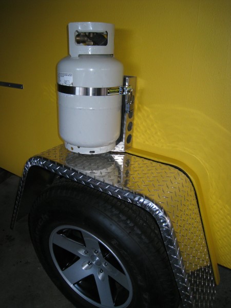

I found and bought an aluminum 11 lb propane tank mount from POWERTANK and decided to mount it on the right fender. I can leave the tank where it is run the hose to my stove on the side table and only need to remove the tank for refills. This frees up space in the lower galley and prevents the tank from rolling around.

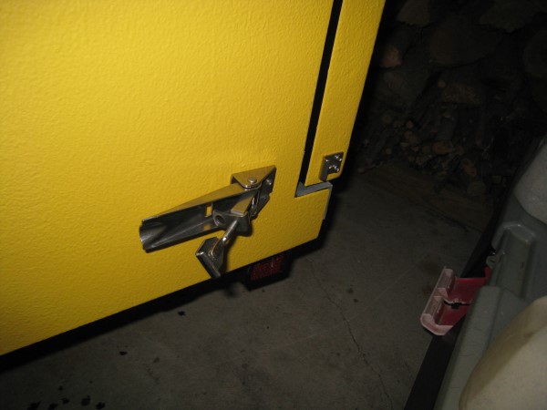

I installed my Tongue box clasps
and galley hatch clasps. The both close up nice and tight. I will need to wait until spring to test for leakage.

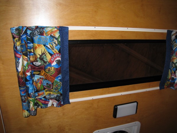

I installed my plastic curtain tracks that I got from Sailrite. I wanted tracks instead of rods so the wind wouldn't blow the curtains off the rods. Originally I was going to have a track on top and bottom of each window on the doors. I decided I didn't really have enough room on the doors for the tracks and to be able to open the curtain full window width so I installed one 4' track above the doors. This allows you to push the curtains forward or to the rear. I used a 4' track on both sides of the moonroof.

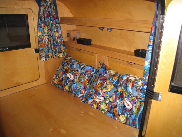

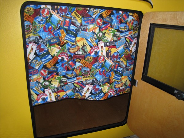

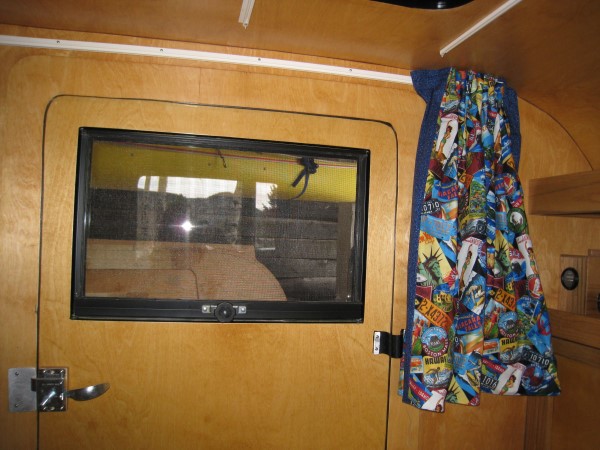

After Christmas my wife sewed the curtains and we installed them. This is a view with the curtain pushed to the rear.
This view is with the curtain pushed forward. This is probably the normal storage direction as it is out of the way and when the curtain is pushed to the rear (above) it covers the light switch.
Here is a view from the inside with the curtain closed

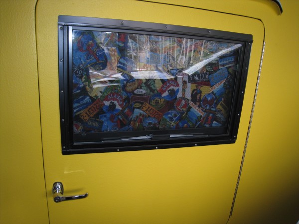

Here is a view from the outside with curtain closed

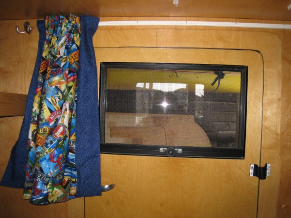

Here is a view through the door window

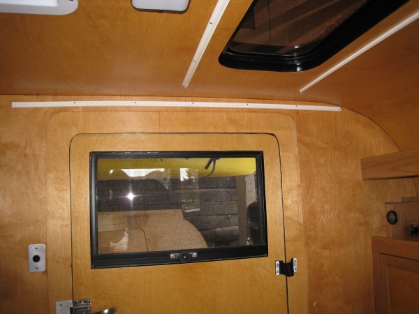

For the moonroof we used two panels. and you can slide them to each side for a full view of the window. Here is a view of the moon roof curtains closed
Here is a view of the moon roof curtains open

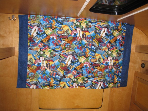

My wife also made matching pillow cases. Here is a picture of them
