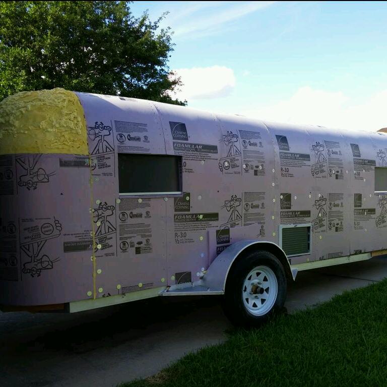

Postby noseoil » Mon Jun 15, 2015 7:40 am
Yep, newspaper & titebond glue in about a 50-50 mix with water should work OK for some fairing of the curves. Just make sure that whatever you use is compatible with the finish covering you will use. You can cut strips at whatever width you need, soak in a trough & just lay it on with a brush or roller. Good old Elmer's glue all might work just as well & be a bit cheaper. I wouldn't use a traditional mix with white flour & water, but whole wheat might be OK in today's PC world.......
Not sure about sanding the glue surface & paper once it's dry, might be a real booger to get it right if it's too lumpy. Bondo might be OK to use as well, but not sure about it with the foam & chemistry, plus it can crack where the paper wouldn't. The smoother you get the foam initially, the better it will finish whatever you decide to use for the filler. A sure-form would leave fairly small voids to fill for a surface if the foam is set hard enough. Best of luck!

Yes, I'm using a Surform for the shaping. It shapes well, if slowly. The foam is dense enough that it takes a while to make significant progress. I'm ok with this as it makes it idiot-resistant. Harder to accidentally carve out something important. I like the idea of the paper mache. I'm still leaning toward that for the interior ceiling.

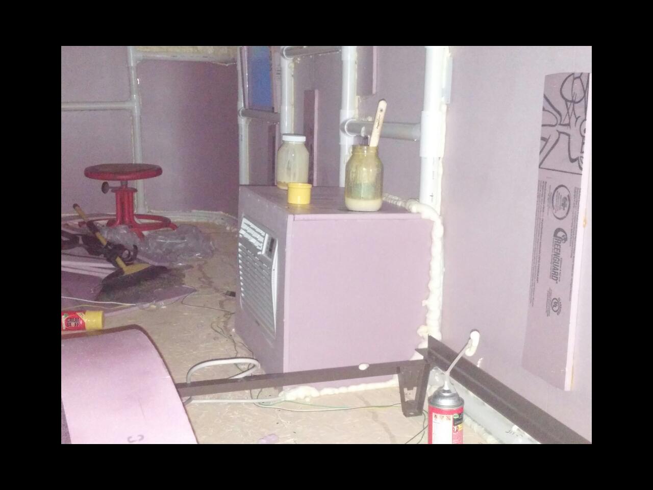

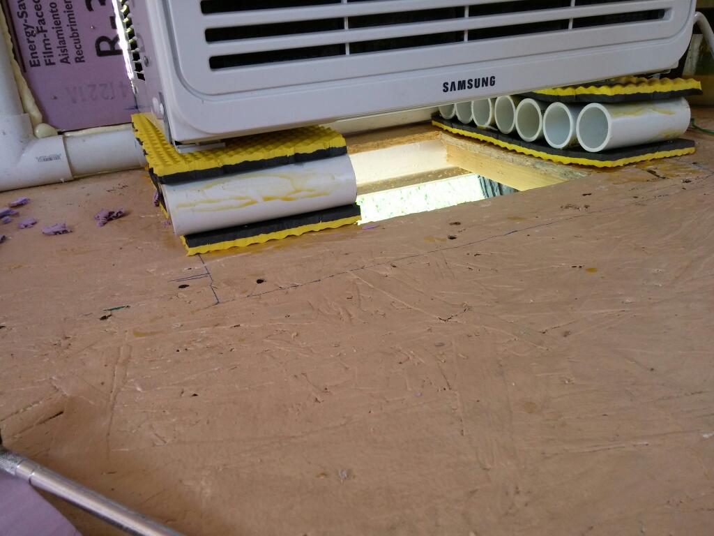

I started on my AC install today. I cut a hole in the floor for the air intake and a hole in the wall for the exhaust. I also put together what I thought was a pretty clever riser that won't obstruct airflow. My plan is to build a box around the AC routing the floor-hole air through the pvc riser into the "outside air intake" vents on the sides and top of the unit.

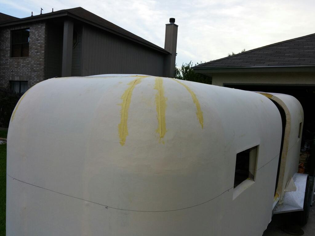

Postby Robot » Mon Jun 22, 2015 1:28 am
Update time. I tried Fred's pva primer / drywall mud combo and it worked great. I got a bunch of the countersunk screws covered and the first layer of mud put on the corners. Then I got rained out. Hopefully the weather will dry out enough to let the mud dry. Getting the whole thing smooth is about all that's left before canvas.
I also got the air conditioner box done. I haven't put a grill on the floor opening yet, but I intend to.

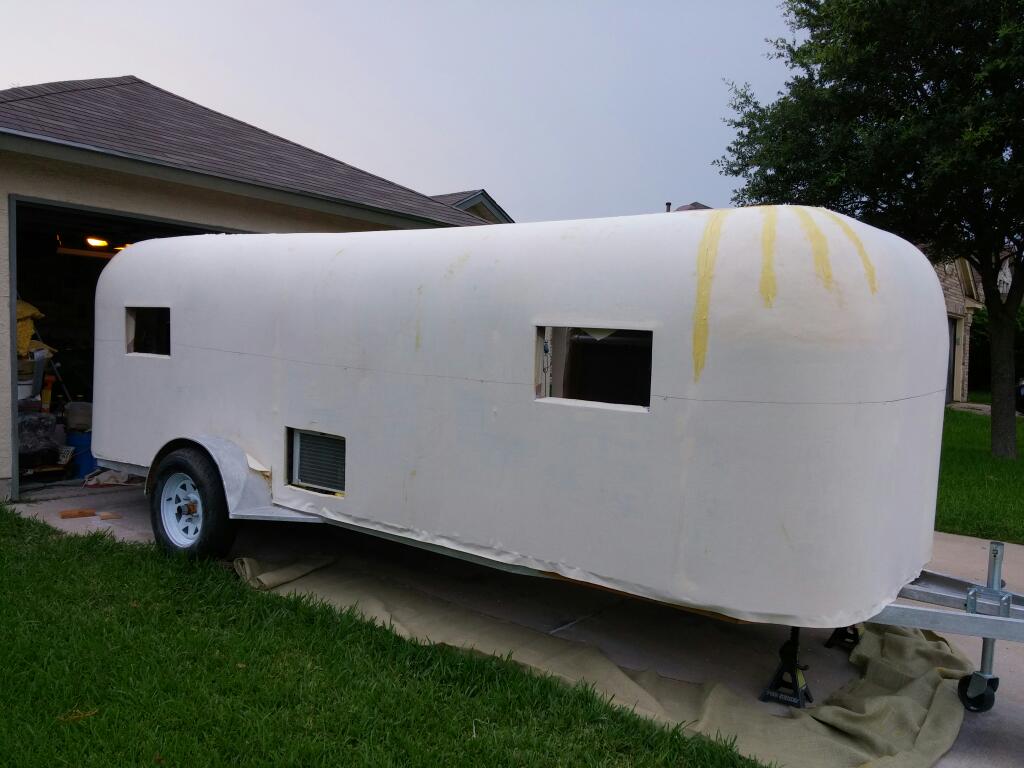

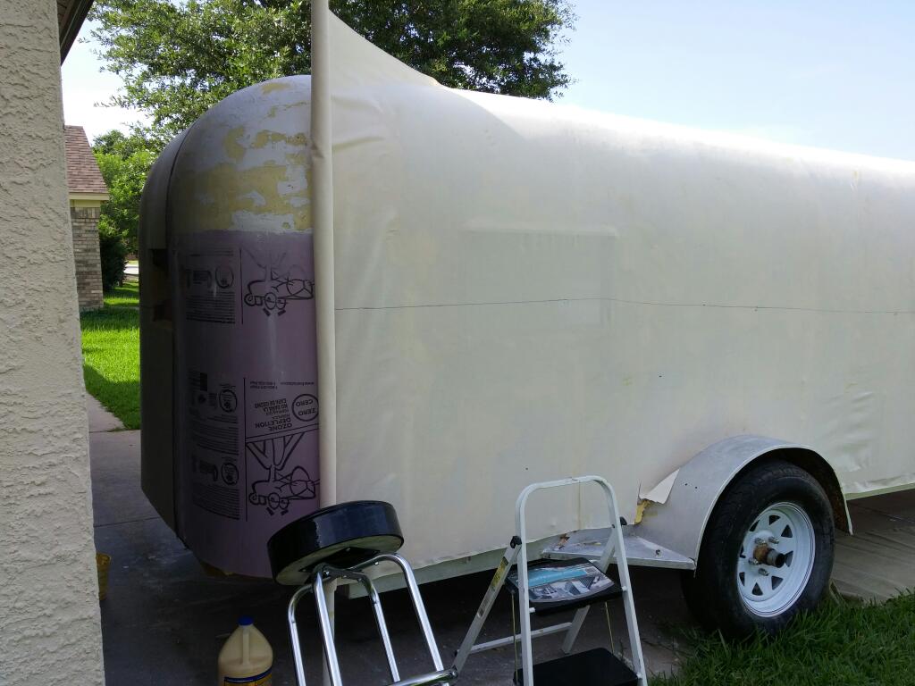

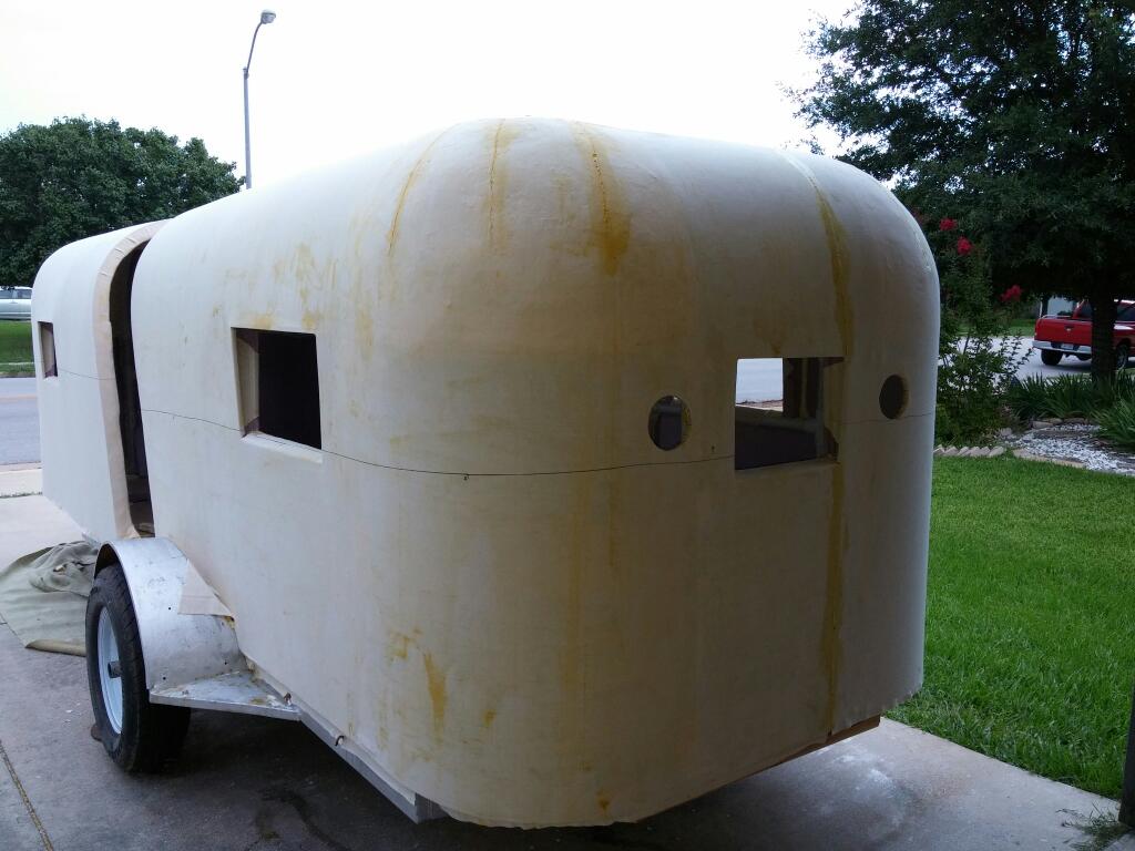

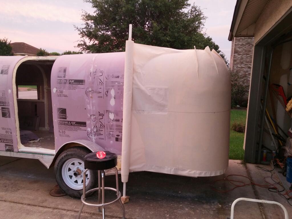

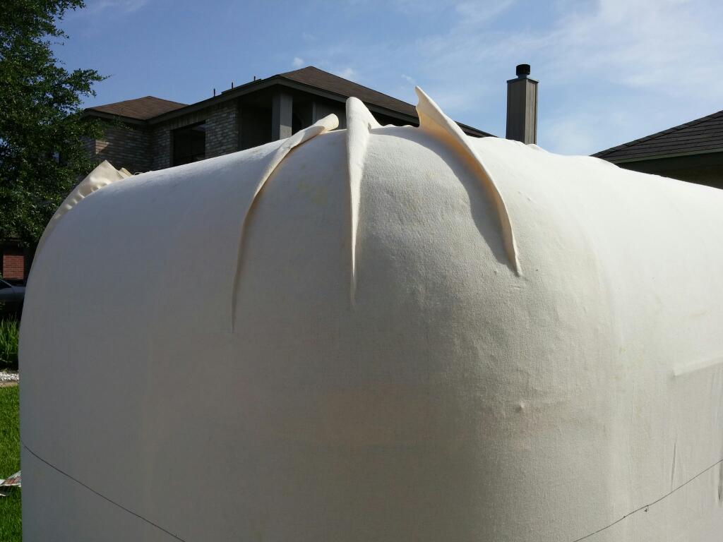

Postby Robot » Tue Jun 30, 2015 12:13 am
No posts lately because I'd been building without pictures. Mostly GS foam work filling & trimming.
I tried to get a couple of friends together this weekend to help me put on the canvas, but got no volunteers. So I figured out a way to do it by myself. It took a lot longer, but I got it done. I rolled the canvas on a pvc pipe and took my time, paint glue on 2 feet or so, roll on the canvas, smooth it out, repeat. For 7 hours.
I pulled the corners up into darts, then cut them off with scissors and then tried to smoosh the frayed edges together with glue. I have only done the initial "glue the canvas down" coat, not the "saturate the canvas" coat. But I'm pretty happy with my results. I had originally planned on having one seam at the back, however I didn't think about the door opening being a cut...I coulda/shoulda started at the door frame. Then I could have had no seams at all.

Postby Robot » Tue Jun 30, 2015 12:37 am
I still need to canvas the roof and the door. Then it's paint and....oh I'm sure I'll find 100 little things that need to be done. I have 8 days left before vacation. I'm still optimistic about finishing it, but I'm cutting it real close. 3 day weekend will help!
