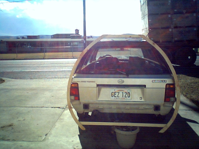

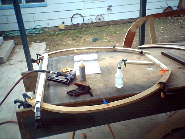

i have started the jelly belly build.
i am building it wider than andrews design (six inches) but narrower than mikes wide version (it will be pulled behind my subaru). it will also be 11 inches longer than original making the internal framing simpler (relatively).
so come back for a laugh or to give me advise (or both).
del

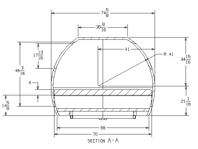

Are you sure that's wide enough to be a jelly belly? At the widest point it should be 74 5/8". Your wood doesn't look quite that wide...

Kinda looks like a Pinto. But that's ok because the shape looks better on a teardrop than a car. :thumbsup:

more like a Pacer, not a pinto.

the pacer had a lot of glass, why we called it a glass coffin. my trailer will have four neat little round windows.

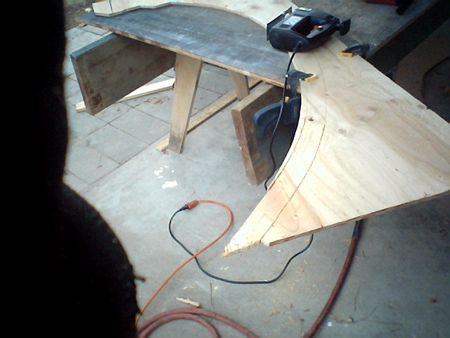

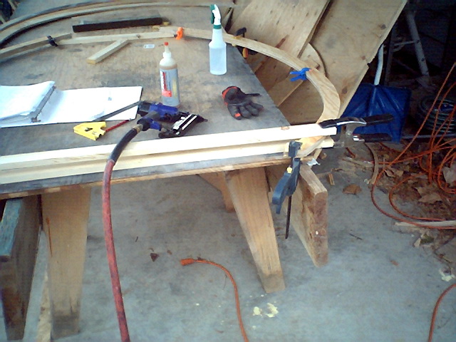

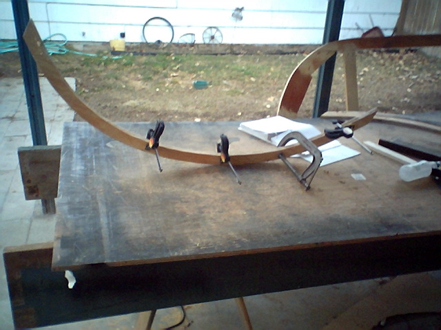

todays work included assembling a second spar assembly, and making a correction for my lack of counting ability. they have to be the same so i clamped them together to make the second one.
i remember a thread on the most important tool for building a teardrop, i think clamps should have made the list.(':laughter:')
lets see ein, zwei, drei, vier,...sechs spars.
now to make them the same, sander check.
hopefully more progress tomorrow and no wind.
del

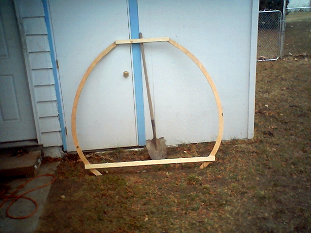

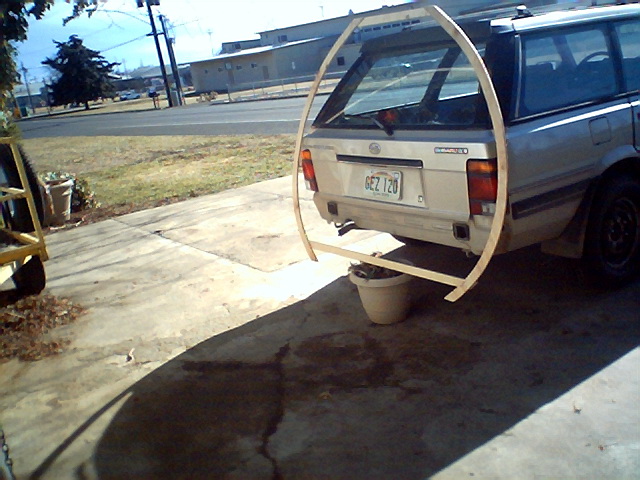

for those wondering why i choose this width.
i think this is about right.
