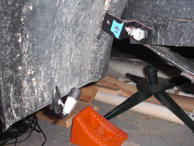

Postby Sparksalot » Sun Jan 10, 2010 11:55 am

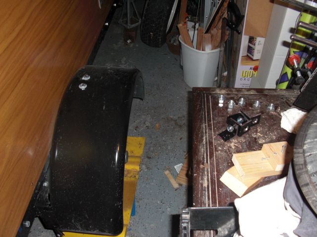

I have been bothered by my fender mounts for nearly a year. I re-used the "stock" bracket along with my cool fenders. That left the fenders about to wiggle and vibrate, swing in the breeze. Not ideal.

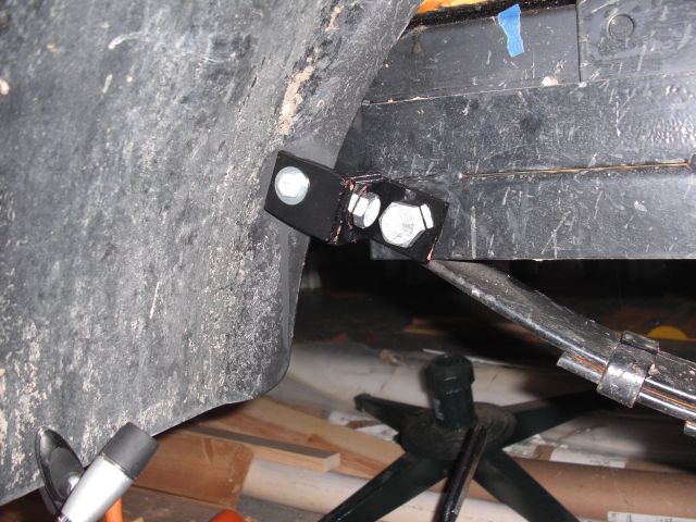

I've challenged myself all along to re-use and recycle as much of the original frame as possible. I had two 6 inch pieces of angle iron left from the caster mounts. So I cut them up and started whatiffin'.
Proof of concept shot. Note specialized work light. It was a cheap trade show gimme cap bill light.

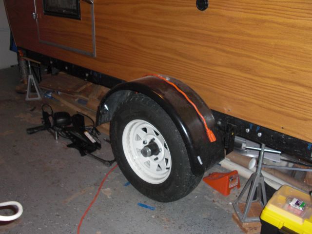

Left front after bolting in place.

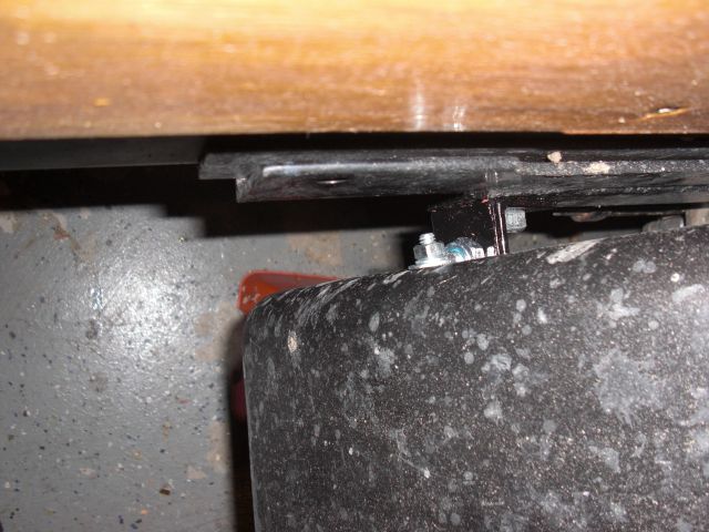

Left rear. Note tire scuff on the original "main" bracket. I bought the axle and wheel upgrade. The bracket was not replaced by mfr.
This will bear watching.

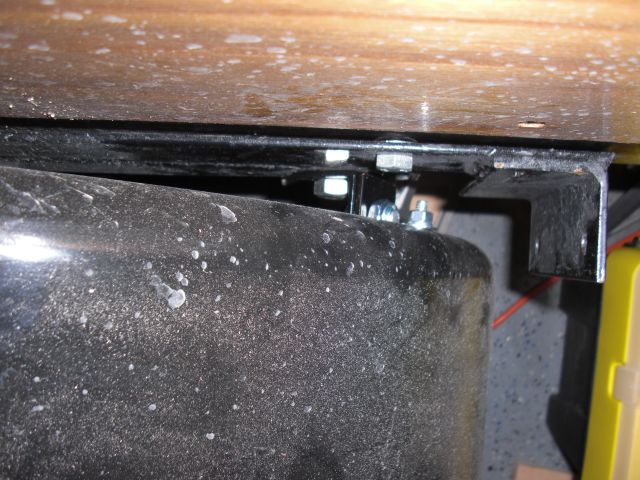

Views from above. Pretty low key really. Stiffness Quotient has gone much higher.

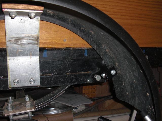

At the rear edge is the frame mount for the casters. I still have ideas swirling for those. Flagpole mounts? Antenna mast for the HF radio? They'll get used somehow.
Doesn't everyone have this much working room?
Finally, a tip of the hat to Hubcap Mike's and his Moon Discs. These wagon wheels take Rose to Dork Factor 10 in microseconds.

Postby 2bits » Sun Jan 10, 2010 12:52 pm
Those brackets look good, I like how you doubled the angle by bolting them together. Glad you noticed that inner tire wear, that could have been a tragic accident!

Postby Sparksalot » Sun Jan 10, 2010 1:04 pm
2bits wrote:Those brackets look good, I like how you doubled the angle by bolting them together.
That had been a hold up until the inspiration hit me.
I hear ya. I don't want to share the fate of the PT Snoozer.
