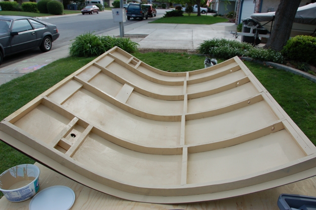

cdfnchico wrote:In anticipation of this long weekend we got our sides ready to go...we went back and forth about stain or not and finally decided to go with a light coat of golden oak to bring out the grain.
Next we masked off the bottom 3" of the interior (where it will set against the trailer) and applied a coat of CPES and a coat of sticky black goo.
Then, we flipped 'em over and applied a couple of coats of CPES to the exterior.
We decided to wait & apply a final coat of CPES just prior to applying the varnish because we read here: http://www.smithandcompany.org/varnishpriming.html this:
The final coat of CPES is the adhesion-promoting primer, and the first coat of varnish must be applied after the solvents have evaporated, but before the CPES resins have fully cured. If you apply that last coat of CPES in the afternoon, then apply the first coat of varnish the next day. The reason CPES works this way as an adhesion-promoting primer is that it is designed to be VERY slow-curing. It actually takes several days, so it finishes curing after the first varnish coat has cured, and thus glues down the varnish with a flexible epoxy glue.
Anyway, we were very happy with the color so far, with the stain and the CPES.
What kind of stain did you use? Oil or water based??

Terry and Sue, we used Minwax Oil based wood stain, applying it before we began applying CPES. We have been very happy with the color and the coverage of the CPES over the stain.

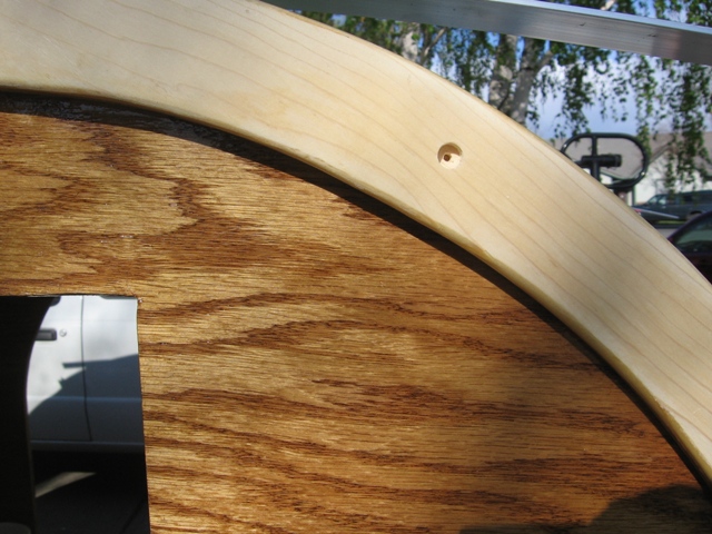

We marked and drilled the holes in the trim...looks pretty good. (There's no finish on the face yet) Above it you can see the 2" aluminum flat we'll be trimming it with.

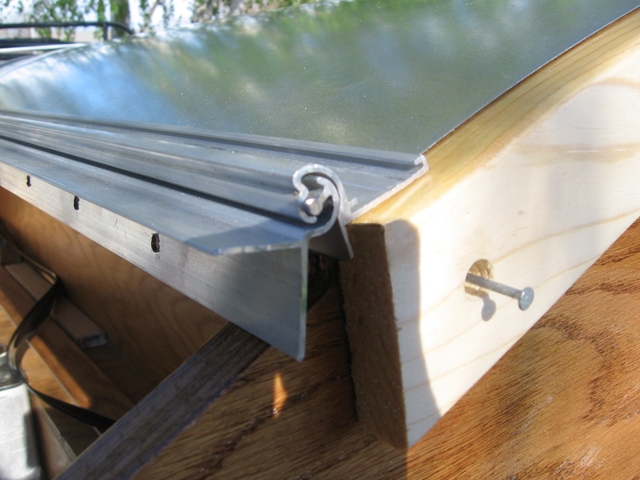

And then we dry fitted the trim, roof, and hurricane hinge...and discovered a problem...we bought the hinge several months ago...(when we had the $$) from Grant. Our trailer is a 5' wide trailer...so we got a standard hinge, which allows for 3/8" overhang on each side...except for the 3/4" trim!!!!!! :shock:
So gang...what do you think?? We need a new hinge??
Bring it back up ... I'll exchange it straight across for one that fits better ... ;) ...!

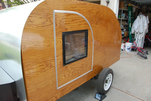

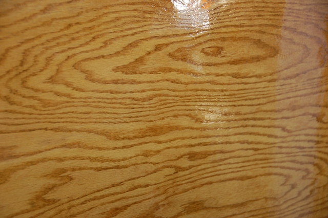

As promised...Grant switched out the hinge for one that will extend past the wooden trim. We put 5 coats of varnish on the sides...whew!! But it looks great!
Finished the hatch this weekend...skinned with metal and then predrilled all the neccesary holes for trim, lights, license plate holder, etc. Both trailer and hatch will head off to get painted next week.
One door in...with window mounted. This week we'll get the drip moldings, weatherstripping and latches on. Finished trimming second door last night...and dropped it! :cry: ...tweaking the trim...sorry I don't even have a pic of it... might be salvageable...we gave up for the night. Sometimes feels like two steps forward...one step back!

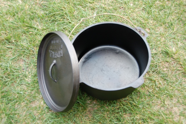

Feeling optimistic...I reseasoned our DO and got it ready for the Dam Gathering!

So...this week we'll finish the doors, hopefully!!, and the wiring. We're planning on using 1/16 aluminum angle from underneath to mount the wooden trim on the hatch...so we made a template of the radius. Any suggestions on annealing??!!
