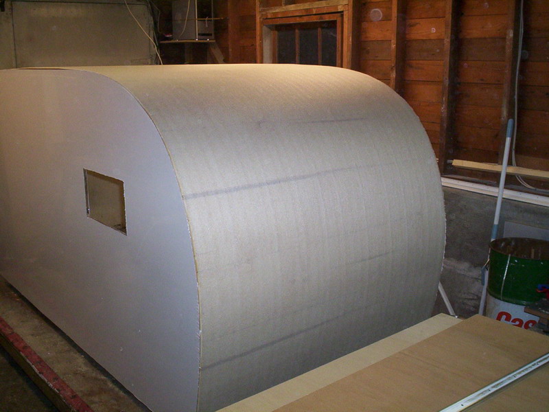

Thank god for long weekends. If it weren't for them I'd be in real trouble. However, I've made significant progress since I last checked in. The roof skin is on and two coats of epoxy have been applied. This would all go so much faster if I didn't have to wait for epoxy to cure :lol:

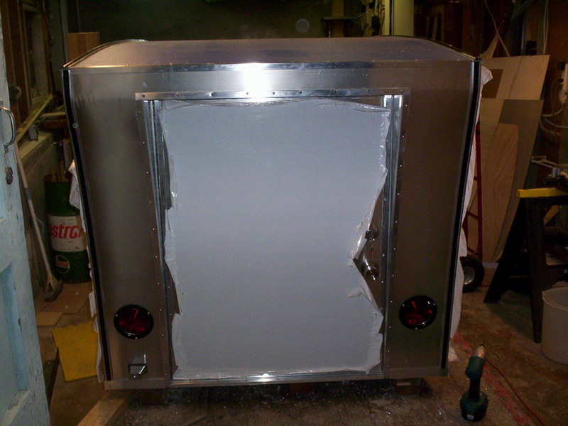

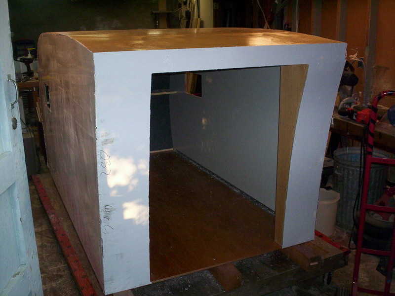

I've framed up the rear door opening. I made a design change there. Rather than making the whole back flat and inset into the curved sides, I decided to curve the rear and only inset the door. Like so:
I didn't take any pictures but the door is built too, though it still needs to be skinned with aluminum. When I decided to change the rear end I also decided to lose the shelf at the rear, and have it come straight down instead. It just wasn't looking right. So now the floor and trailer are about eight inches shorter.

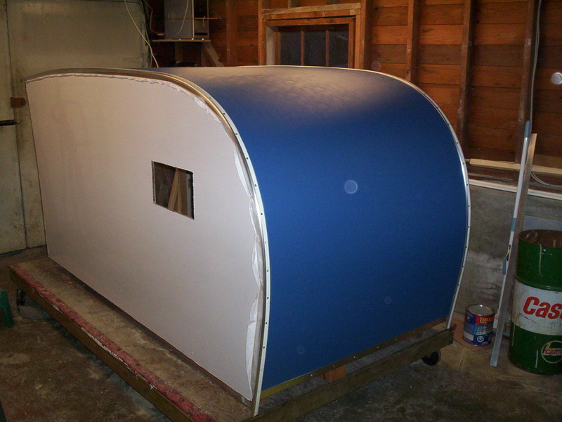

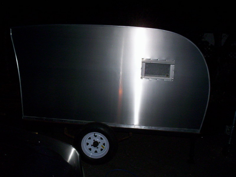

I also put the aluminum on the sides and back, and even laid down the underlayment for the vinyl roof. The vinyl is waiting at the post office for pickup tomorrow. Here's how the shell looks now:
I picked up a couple of lengths of insert corner trim, but all anybody in town had was polar white, no mill finish, so I've been using an eighty grit sanding wheel in my dremel to remove the paint, then hand sanding to 150 and polishing with 0000 steel wool. It's slow, but it looks pretty good.

Postby halfdome, Danny » Tue Aug 04, 2009 7:48 am
W0W Greg your smokin'. Lookin' good :thumbsup: . That's a lot of progress for such a short time. Will that eight inches change your tongue weight much? I'm sure you'll make your deadline. :D Danny

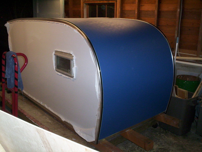

I picked up and installed the roof today. Genuine Naugahyde, although I understand that it's from farm raised Naugas, not wild ones. The corner molding is roughed out, and now it's time to make the big push to get the trim all done. I sure hope my new fenders show up soon. It's almost to the point where I'm going to need the trailer frame :thumbsup:
Look it's blue:

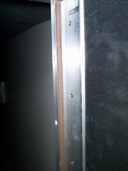

I've been madly making and modifying trim and the last pieces just went on. These are the inside door weatherstrips:

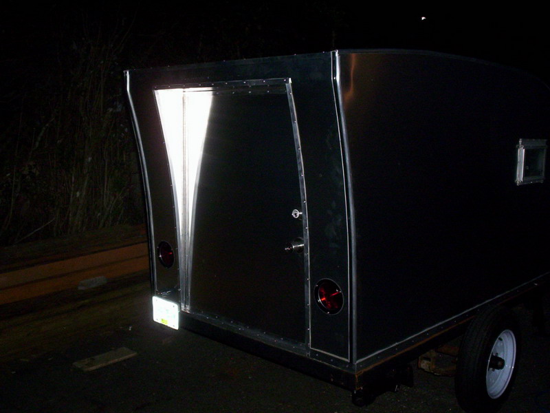

Most of my time Friday and Saturday was spent working on and around the rear door, but I'm very happy with the results and, amazingly, the deadbolt and door strike actually lined up perfectly :thumbsup:
A last minute addition was the tail-lights in the back wall. What do you think?

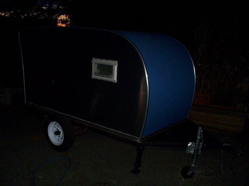

I've got a couple of more hours of build time left, and all I need to do is put my temporary fenders on. The shop seems to have lost my order dangnabbit :cry:
I put the body on the frame, and wired up the lights. Then I put a platform on the frame of the tongue because it just looked too bare with nothing there. After I'm back I'll work on building a proper tongue box for it.
Here's how things look now. Sorry for the darkness, that sun just doesn't seem to stay up as late as it used to.
