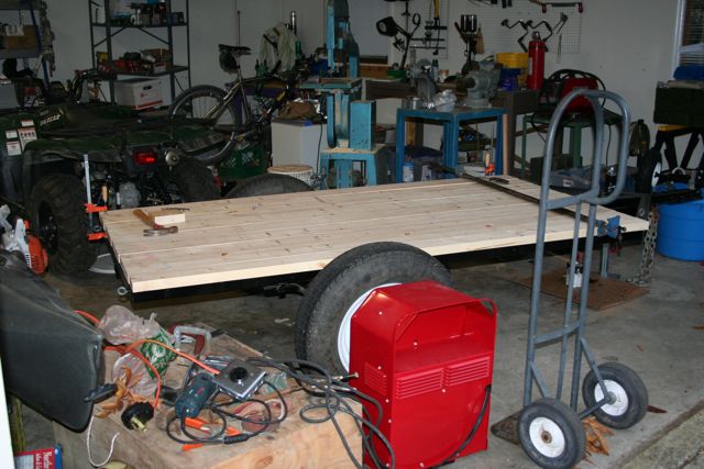

Postby Lawnjockey » Mon Dec 07, 2009 7:04 pm
Well I was lazy today and goofed off, went for a run, etc and didn't start work on the TD until 4:00 pm. In the few hours I worked on it I got the deck layed out, cut and clamped into place.

Postby Lawnjockey » Tue Dec 08, 2009 2:09 pm
Photo test
