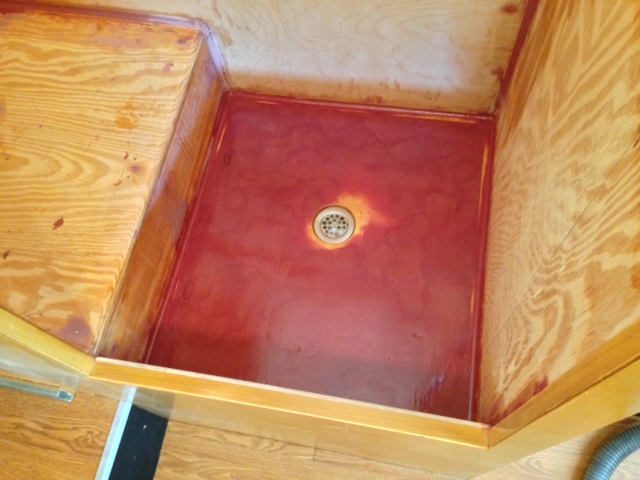

Making slow but steady progress. Finally got the shower pan built-up with epoxy to my liking. It passes the "golf ball test" now (a golf ball set anywhere on the pan will roll to the middle). The color is funky, but the whole bathroom will be painted white when complete. I also have a few imperfections I will fill in before the paint.

Hi all. Just checking in. Work continues on the bathroom. I've applied the first layer of epoxy, sanded it, and applied the second layer. I plan to do at least three coats. Not much point in posting pictures; not much to see.
Did I mention how much I hate sanding? :? And I especially hate sanding epoxy.
I hope to paint the bathroom in the next couple of weeks.. THEN I'll have more pictures. :)

I have machine sanded the second coat of epoxy, and now I have to hand sand all the corners. I had filleted them all with epoxy, so the sanding consists of wrapping sandpaper around a small, deep well socket (12 mm or so) and just rubbing it back and forth along the fillets. I have also filled in some voids with more epoxy and filler.

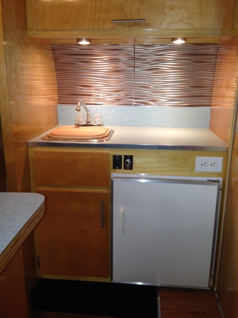

I haven't been on here for a while, but have made some more progress. The icebox arrived, but as luck would have it, the WFCO power converter burned out. Specifically, something went wrong with the 12V converter portion of it. I ordered a new one and replaced it. You know your build is taking too long when you start wearing out parts before you are ready for camping!
To install the icebox, my framed opening where the thermoelectric refrigerator previously sat was the right width, but I needed to fill in some space vertically. I decided to add the space above, not below, to give me some room for electrical stuff. I cut a piece of wood to fill in the gap, coated it with polyurethane, and discovered that it was lighter than the wood around it. This stuff yellows over time! It is a close match, however, and should be an exact match in a few years. 8)
Next, I mounted a 110V AC outlet, 12V receptacle (I still want to call it a cigarette lighter outlet), and a relocated switch for the lights over the sink. I also took time to properly run the wires below the cabinet-they were previously connected in a very temporary fashion! I'll get pics of that next time I yank the icebox. Here's where we're at now.
