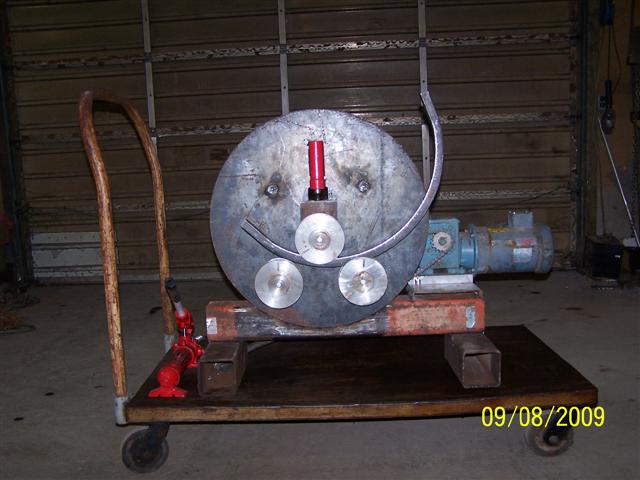

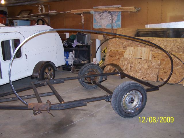

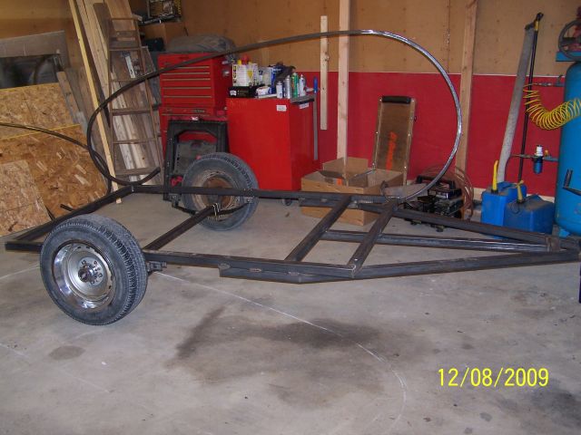

I started designing and collecting parts a few months ago, for TD #2. First thing I had to do was build a roller for the 1" square tubing framework. It took a few modifications and a larger motor to get the roller to work right.
I next built the 2" x 11 Ga. Sq. tubing frame and 4" dropped axle. I used the spindles and brakes from a 3500# axle that I had laying around. I hope the brakes are not over kill for a 1000# trailer. {Any comments would be welcome}.

Here is a picture of the roller I used to bend the tubing.

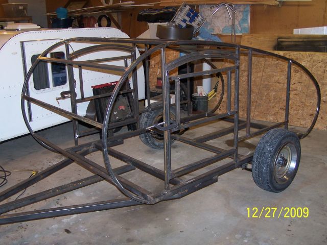

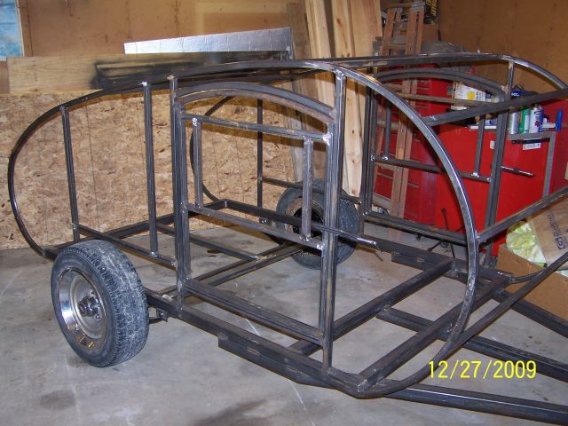

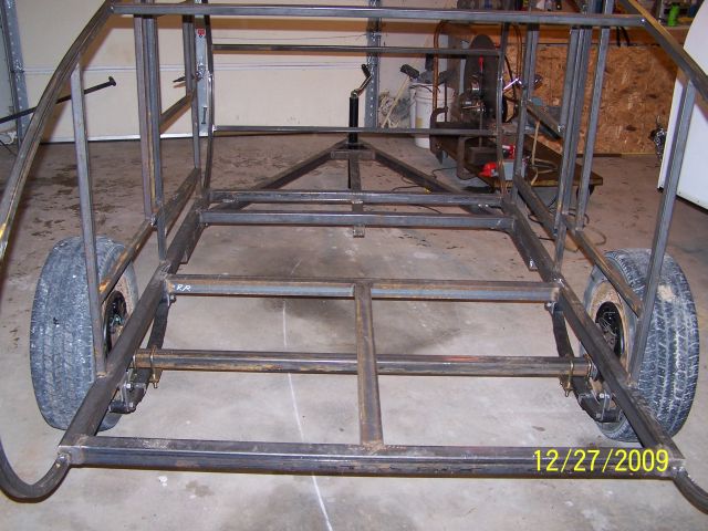

Had about two days to work on the tear. I got most of the framework done. I still have to bend the tubing for the hatch, that might be a little tricky.
Here are some pictures of the progress so far.
