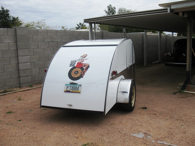

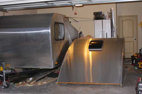

emiller wrote:Here is my nose art

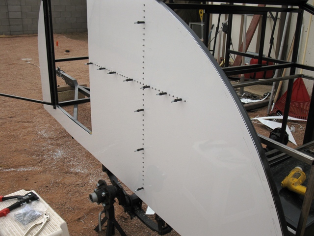

Here is the rivet pattern I did

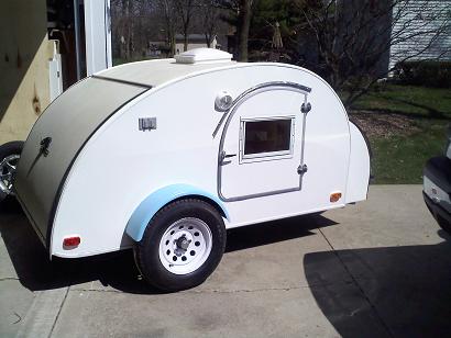

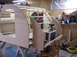

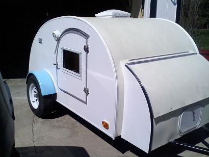

prohandyman wrote:Have a customer that wants this camper, so bomber tear is put on hold.
The build pics are here. 5 ft wide Kit Profile with tongue box and air

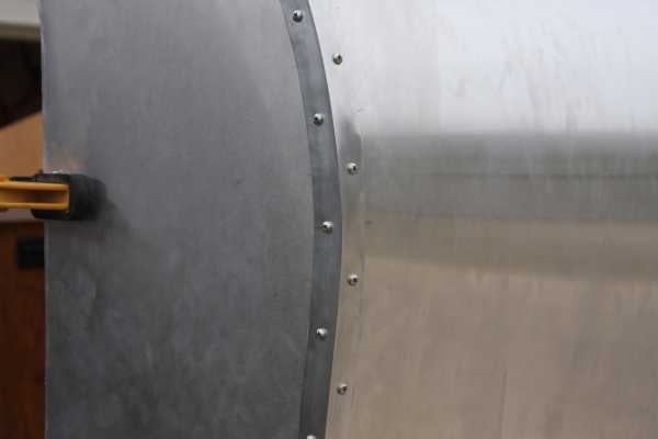

prohandyman wrote:These are aluminum drive screws hammered thru the skin into 3/4 ply walls.
prohandyman wrote:Heikki
I am using 3/4" Baltic Birch for the walls.
Wolfgang
I stock the screws. They are actually Nichols aluminum twist nails, $9.95 a 1/4 lb box
