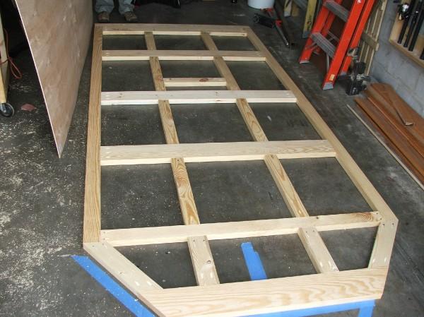

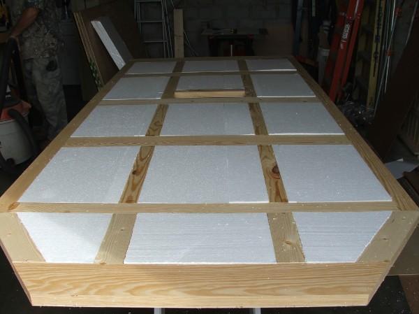

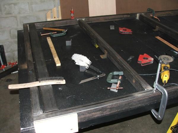

Heres the base built
Postby Mikey1975 » Thu Mar 25, 2010 5:21 am
As you can see its 1 1/2 thick plenty of room for insulation
and here it is painted with roof paint 15 year warranty

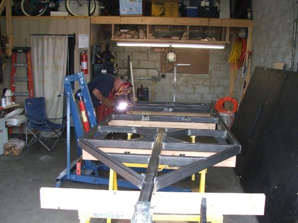

Postby Mikey1975 » Thu Mar 25, 2010 5:25 am
well i decided to build the trailer also heres its beginning I used the above base as a template.
Now the trailer is built out of 2x3 1/8 thick.
and the tonge is 3x3 3/16 thick.
tabs to hold it down is 2x2 angle 1/4 thick
thats my dad i let him weld some :cry:
Now you may think this build is going quick but i'm unemployed so i have only been working on it 2 weeks so far :lol:

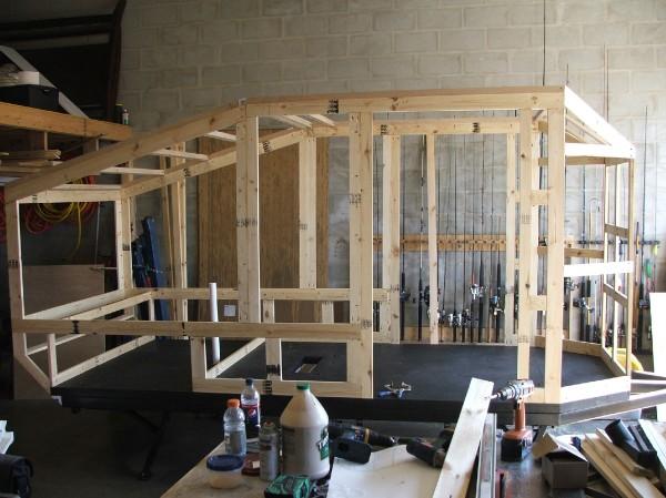

ok
Postby Mikey1975 » Thu Mar 25, 2010 5:32 am
well trailer took 5 days to build alot of welding and 10 lb spool of wire for my mig.
heres the base mounted to trailer

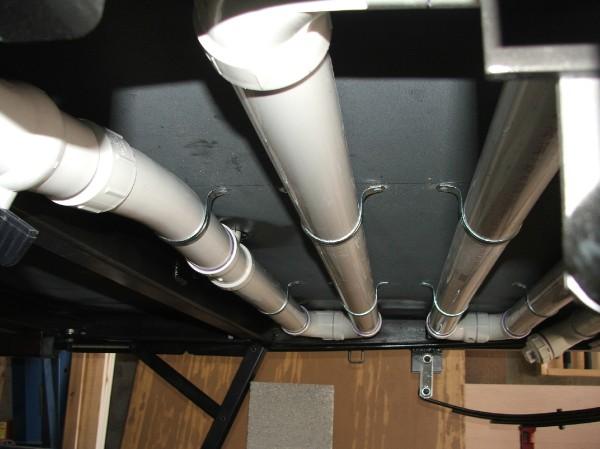

now the pipe in the middle is not a urinal thats what me and my dad told my mom it was :lol:

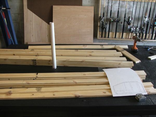

the ext framing is built out of 1x2 and 1x3 pine no money for good wood but it will work once the plywood is up all will be good.

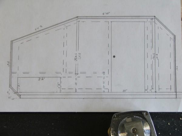

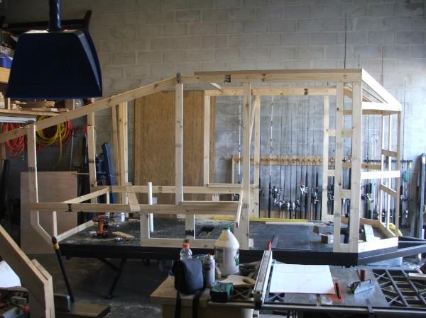

Postby Mikey1975 » Thu Mar 25, 2010 5:56 am
well theres the profile for it still alot of wood to go in it by the way it is 12 foot interior maybe little more it will have queen size bed, AC, TV, Refrig, micro, dvd and much much more in it when its all done.
heres the underside of it and what that pipe goes into.
Grey water tank 20'of 2" pvc hope it hold enough. :roll:
well i have alot more pics but left camera at my shop i will post more later SEEYA!!!

Postby Mikey1975 » Thu Mar 25, 2010 4:20 pm
interior is 61 inches finished width and length is little over 12 foot ceiling height at the highest is 5'7" most normal size people will fit :lol:
I'm 6'6"-6'7" :roll:
so in the rear its a queen size bed and in the front it will have a entertainment center with refrig,micro,dvd,tv,and maybe xbox360 :lol:
theres also a AC under the queen size bed in the front i forgot my camera at my shop i'll try to get more pics up tomorrow.
Also i am trying to design a drawer on the exterior that will have a sink and a grill in it that will be my kitchen area instead of in the rear.
