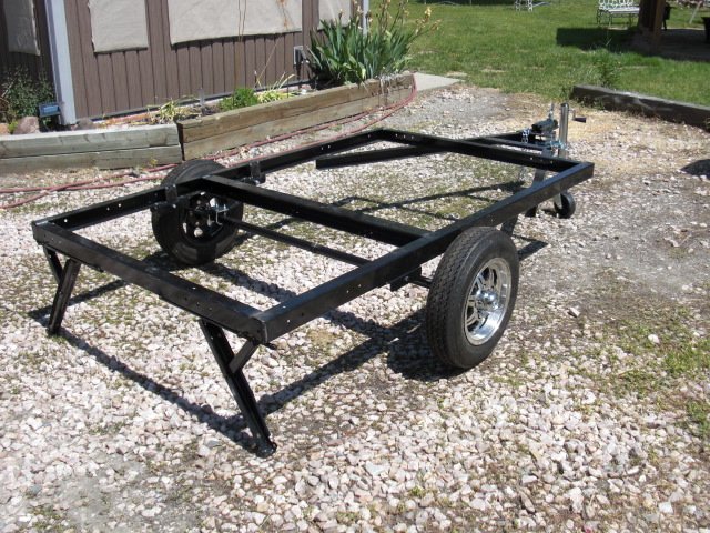

I started putting the trailer frame together minus some shortening of the trailer length by 9 inches and the width shortened by 5 inches using a small angle grinder with a 4 1/2 inch cut off wheel. I lucked out on the axle placement. After taking off the 9 inches off the back of the frame. The location of the axle was within 1/8 of an inch so I did not have to do any drilling.
[/img]
Next on the list is the floor.
