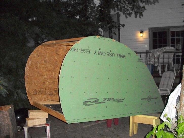

Postby bobhenry » Thu Jul 08, 2010 7:41 am
OK ! Up at 5:00 and snapping pics at 5:45 am.
Here are a few.
This is only about 6+ hours into the project so progress is a little limited but it is starting to look like a teardrop.
Profile pic looks a bit funny because it is not setting level but it was do to rain today so I lifted the front so the water would shed off. Used the fence post treat on the 3/4 floor on all sides

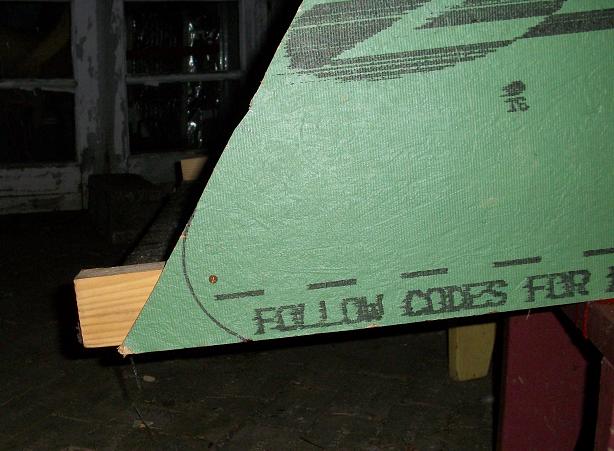

I let the rear run long and decided to radius cut the rear.
What do ya think ?

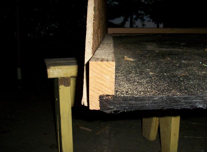

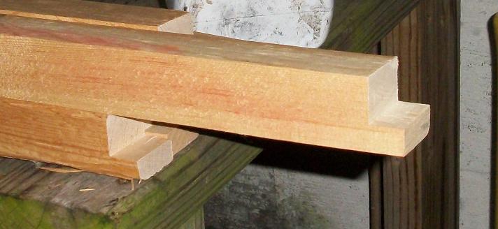

Here is an end shot of the rabbet I was describing in an earlier post

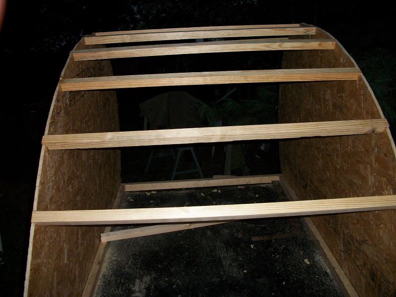

Obviously a shot of the spars.
Here is how they attach. A lot of glue and one 3" construction screw angled up into the spar so it will travel cross grain. They run a fuzz long and will be sanded flush with the side later on.

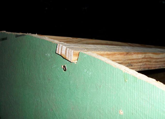

Here is a closeup of the spar rabbets. They are supposed to be 3/4" deep this one looks a bit deeper.

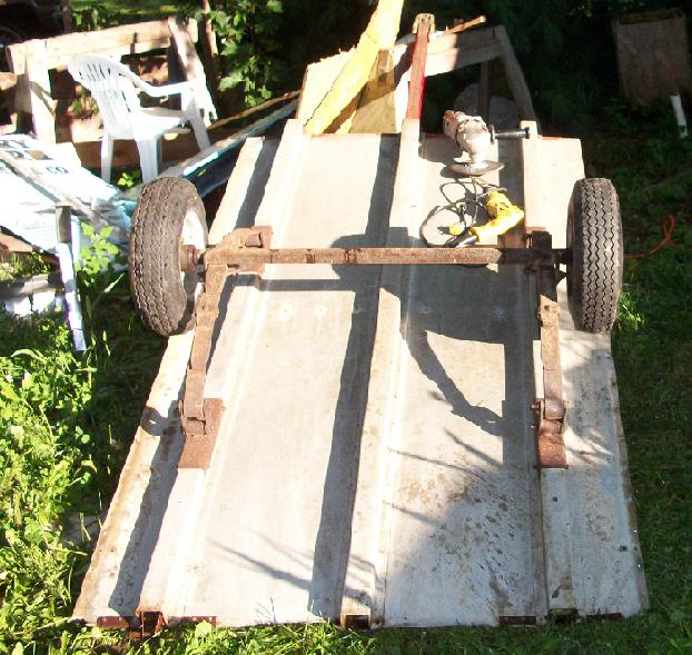

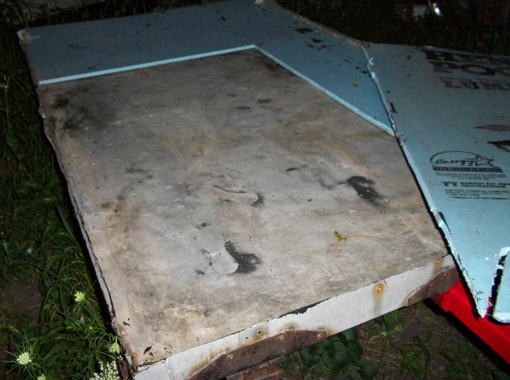

Here is the little 4x7 I purchased abandoned and ignored in a back yard. I just walked up and knocked and $60.00 later I hooked it up and took it home.
It has an all aluminum bed and weighs 195 pounds total.

Postby Miriam C. » Thu Jul 08, 2010 8:09 am
:lol: :thumbsup: ;) Looking good so far! The lil trailer looks like in need some love! I sure hope that is not a 2"x4" I see... 8) Keep up the good work and let us know how the panels work; especially if they give off fumes. :thinking:
Postby bobhenry » Thu Jul 08, 2010 9:27 am
No that is not a 2x4 in the frame pic. It is a 2" x 2" fold of
heavy wall aluminum rivited to the aluminum pan floor as
reinforcing ribs. Why they chose to use the mild steel clip
on the end I don't know.
You were right about it needing a little lovin'
all new bearings and seals had to be installed and the
dust caps were missing and needed to be replaced,
Tires are "tired" and will also be replaced soon
