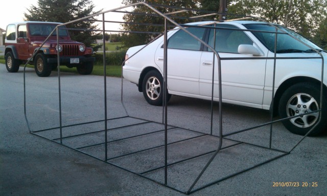

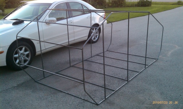

I love the weekender idea, quick build and very useful. Since I have a background as a semi-trailer mechanic (quite a few years back) and still have the skills I decided to modify the weekender to use steel tubing exo-skeleton and either steel or aluminum sides applied with VHB tape.

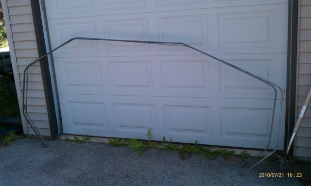

Built the bender for the tubing
Bent up the sides following the posted dimensions
Tack welded the x-members into the capsule

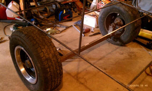

Taken a trip to the salvage yard and picked up wheels and tires

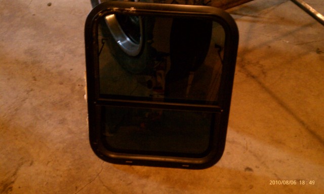

Salvaged some excellent tinted windows/screens for the doors from a newer travel trailer

Build the sub-frame that will attach to the salvaged torsion axle and have the capsule mounted to it
