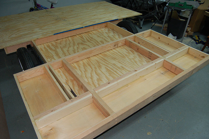

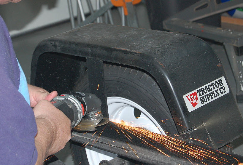

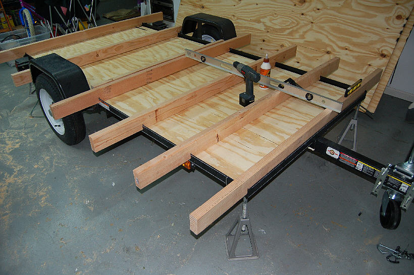

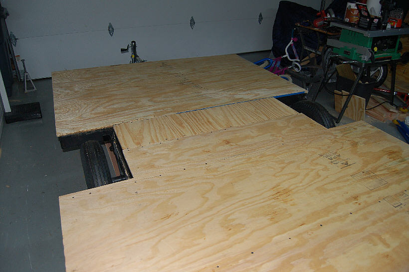

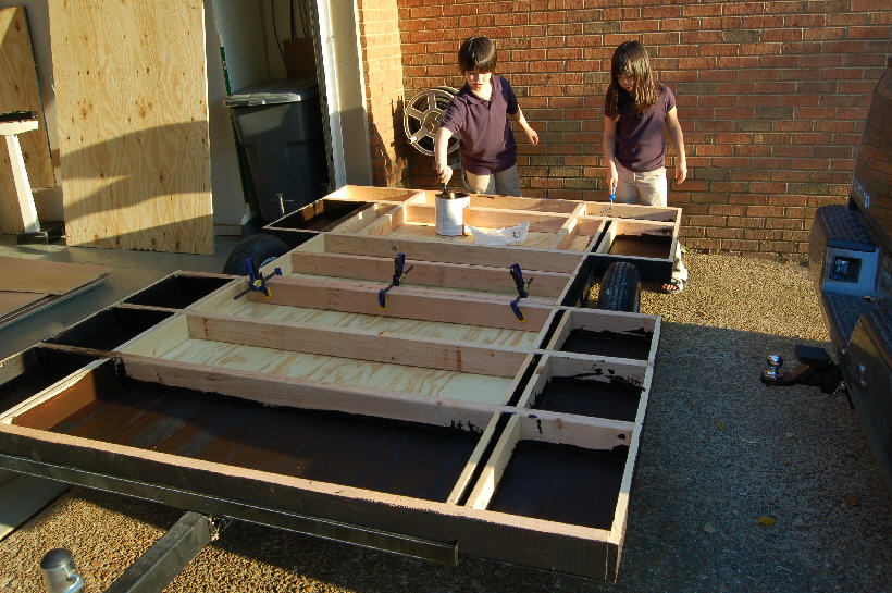

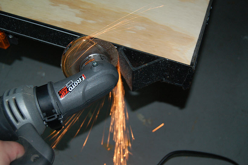

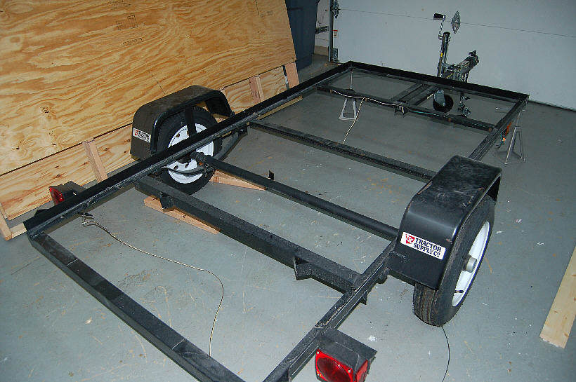

Postby Cyclicpitcher » Sun Oct 03, 2010 7:27 pm
Here is a walkthrough of where I am to date with my Bugout Box project.
Started with TSC Trailer Frame, added front leveler and wheel.
Cut off stake bracket so as not to interfere with wooden floor deck. Removed lights and fenders, ground smooth and repainted exposed metal.

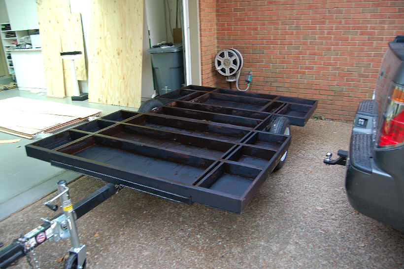

Layout floor joists and glue to 4x8 ply base.
Clamp and glue outboard flooring and add a one foot expansion off the back of the frame. Plans are to build from a 6x9 foot floor.

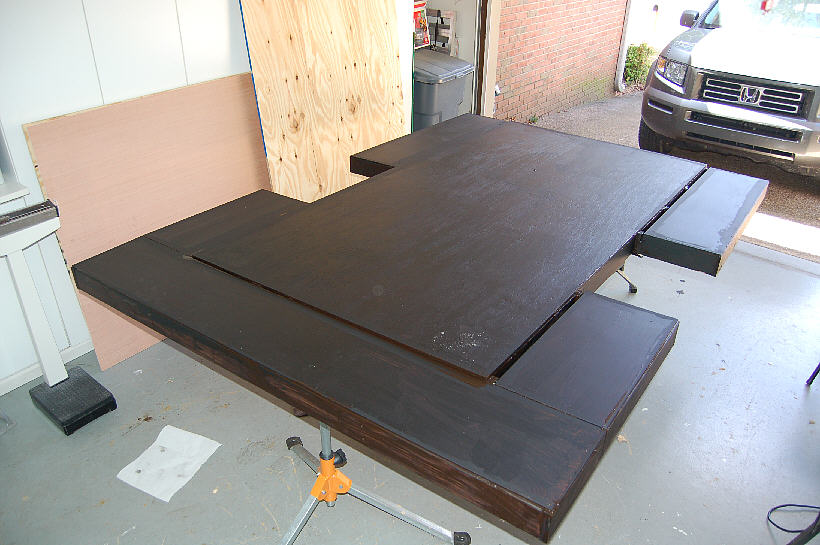

Flooring is removed and put on saw horses and painted with fence paint sealer. At this point the whole assembly was weighed in at 142 pounds!
Rough cut the top decking and then to insulate the cavity before the top deck is glued and screw shut.
Then to edge route the top panels and off to the hardware store to pick out vinyl flooring! Hopefully next weekend!
Thanks for viewing my build pics!
CP

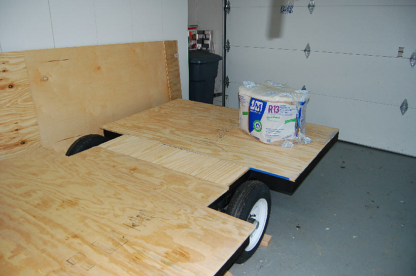

Postby Weirdnerd » Sun Oct 03, 2010 9:40 pm
Wouldn't be better to use styrofoam insulation?, it occupies the whole space, does't absorb moisture ( easily) and there is no space for bugs to roost ( spiders/wasps, etc), just a friendly opinion.
This is my build thread...
Weirdnerd's teardrop
Weirdnerd
Posts: 318
Location: Denver, Co ( USofA)
Styrofoam
Postby Cyclicpitcher » Sun Oct 03, 2010 10:23 pm
Styrofoam would be better. I planned to use it in the walls.
I bought the fiberglass because it was cheap, 8 dollars for R-13 value and it is designed to fill a 3.5 inch space.
My local hardware doesnt sell the thick stuff. I really need to locate a real builders supply in my area.
I will do some looking around this week to see if I can source some thick styrofoam.
Thanks for the feedback!
CP

insulation
Postby Cyclicpitcher » Mon Oct 04, 2010 9:45 pm
I will call Midsouth and see what they say,
I did some checking today, I found out 2 inch 4 x 8 sheet R-7 Ownings Corning was $25 a sheet.
That's way to much to spend on this project, I dont plan on camping in really cold weather. We like the fall when there is no bugs but once it gets bitter cold, even the kids dont wanna go.
The R-13 glass wool is cheap and is 3.5 inches thick. I don't like the itch but the price is right to fill the cavity. I guess it's better than putting nothing in there. I weighed the bundle and it's 9 pounds.
So far I am leaning towards the wool for the base but I been dreading the itch and cutting that mess.
Cheers!
CP

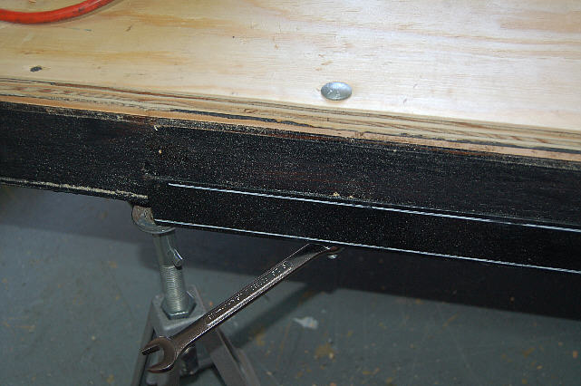

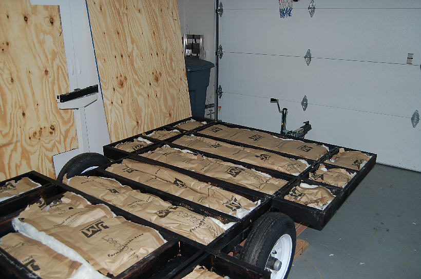

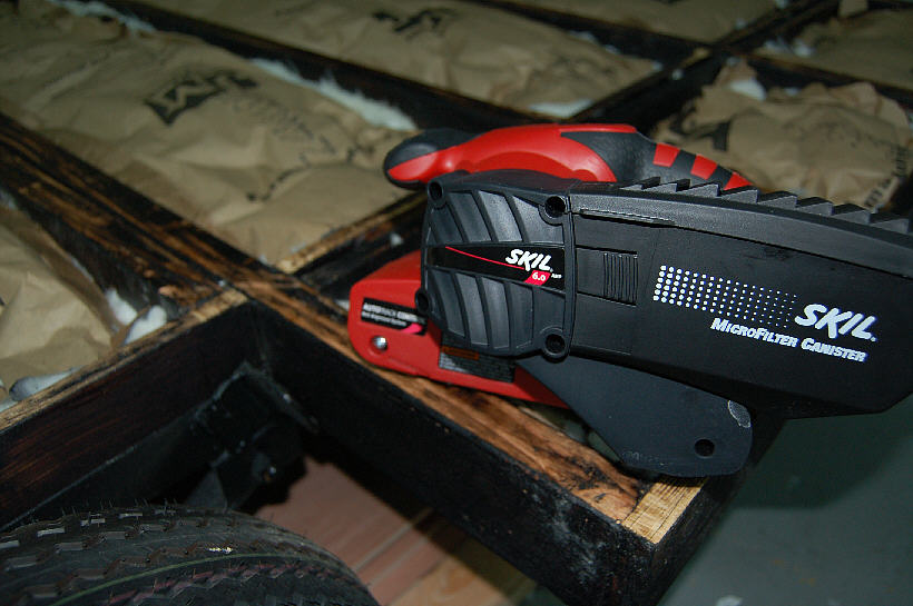

Quick Update
Postby Cyclicpitcher » Fri Oct 08, 2010 2:18 am
Here the kids apply the top side of the Fence and Post Sealer (asphalt paint)
Fully Sealed top and bottom
bImage
Install the Glass Wool insulation.
Belt Sanding the tops of the frame to level and remove asphalt paint for better bond with Liquid Nails.
Decking is now glued and screwed down and once the glue has dried its on with the edge routing.
Thanks for taking a look!
CP

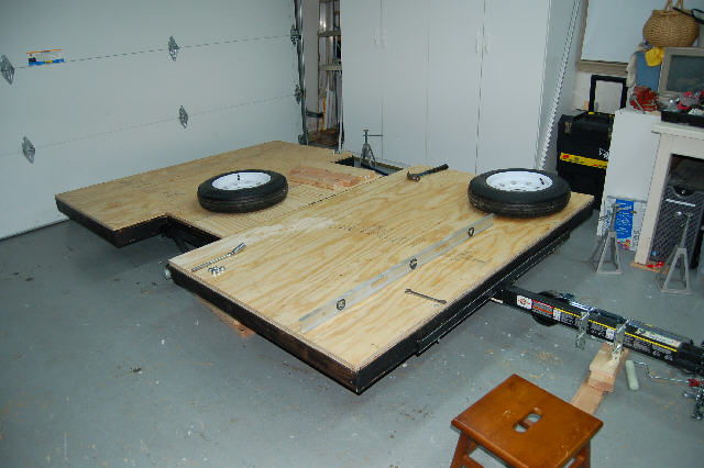

Moving forward
Postby Cyclicpitcher » Sat Oct 09, 2010 9:30 pm
Grizz, I am having a great time with this build. Being a first timer I am sure I am over building but if it comes out a little heavy then it will pull good. As long as I dont exceed the axle rating. So Far my 2 x 4 box frame weighs about 250 pounds.
Tinksdad, I think your right, if I added some ply to the fresbees, Right now just using 1x4 scrap but once I have to pull it out into the driveway that has a pebble finish I need something slick. The U-bolts are alreading digging into the scraps. Walmart sells a cheap generic fresbee for a buck or two. Hope to pick some up soon.
Here is an update to the build this week.
Removing the wheels to allow a 5'9" interior height to the build inside the garage.
Edge Routing the top ply.

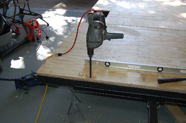

Drilling through the frame for the bolt down.
Installing carrage head bolts.

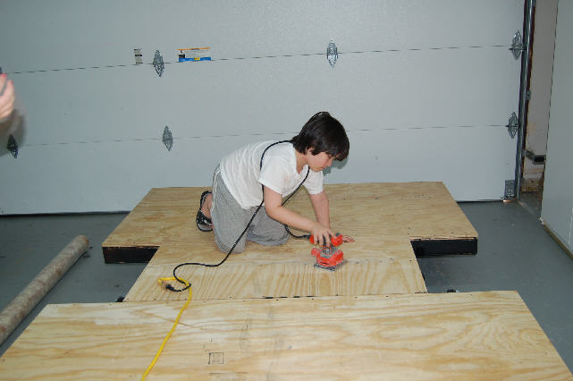

Sanding and filling to prep for the vinyl flooring glue down. Got some help from the chairman of the board!

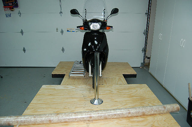

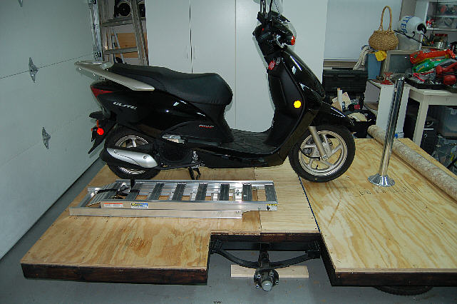

Now for a little test fit of the main cargo of the bugout box! Yes, it will be a tiny trailer with a dinette that makes into a bed and it should be able to have some tiedowns on the floor to act as a toy hauler.
Front view shows room to have all the side cabinets. I will have a full door in the rear using a plastic piano hinge I purchased on ebay. I want rear to double as a galley but will have a cooler and small gas stove to remove to an external table.
Next stop vinyl flooring!
Thanks for the comments guys!
