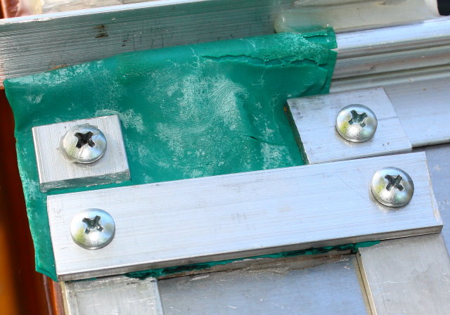

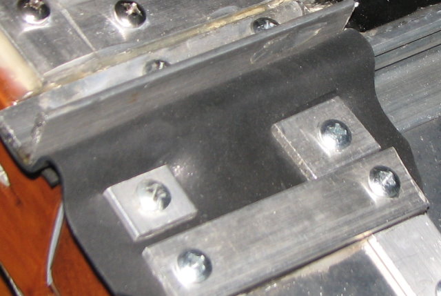

This next picture is about non-UV protected rubber. My Shack is about 6'2" and the hurricane hinge is only 6' long. I took some rubber from an "exercise band" and clamped it over the extra inch on both end. Little did I know that after a year of "periodic exposure" to the sun, no more than maybe 6 weeks total exposure, the rubber was drying up and just falling apart on me. Take a look at the picture and you'll see what I mean. Last fall before putting the Shack away for the winter I replaced those pieces of rubber. I used rubber membrane left over from when I had my flat roof installed over 20 years ago. The rubber I used has been kept in the basement out of sunlight, and the rubber on the roof is 20 years old and still holding up OK. Second picture is with the replacement rubber.

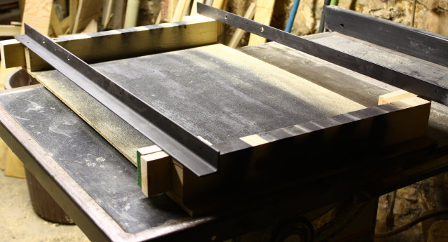

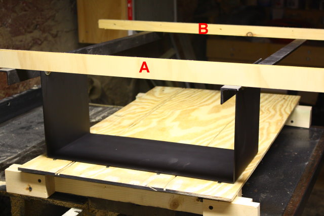

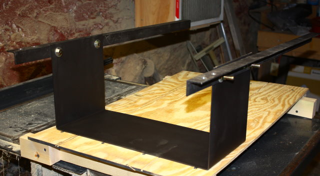

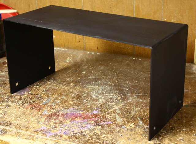

Postby Jim Edgerly » Thu Jan 31, 2013 3:15 pm

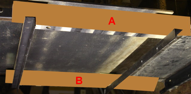

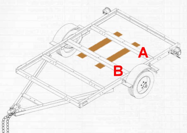

The battery cage is coming along well. It is simplistic in design, as is most things I build. The cage is basically a flat bottomed "U" to hold the battery, bolted to a pair of 3 foot long heavy steel L brackets, which are then bolted to the trailer frames C cross members. Inside the cross members I bolted a 1 1/2" L beam, 4 foot long, to spread the battery weight out over just about the entire 5 foot length of the cross member. I will use grade 8 bolts throughout. I will clamp the battery to the middle of the "U" using a standard battery hold down, and bolt a 2x6 board in front of and behind the battery to make sure it is going no where. Here are pictures of what I mean, but it will be a couple months before I can bolt the L beams to the trailer cross members. Once the L beams are bolted in place I will drop the "U" shaped battery cage, install the battery, then put it back in place and bolt it secure. I'm using "A" and "B" in the pictures to represent the steel trailer cross members. The battery/U bracket will weigh about 70 pounds, so I plan on making a little lift, on top of a bottle jack, to lift the battery the last 5 inches into place while I bolt it secure. I don't need a 70 pound battery falling and altering my smile getting this thing into place. I figure every 4-5 years or so between battery changes, so it may be awkward to change, but once every 4-5 years is not so bad.

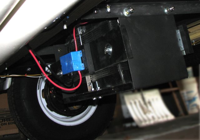

Re: The Shack - updated 04/12/13 - battery cage installation

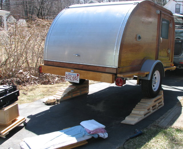

Postby Jim Edgerly » Fri Apr 12, 2013 10:00 am

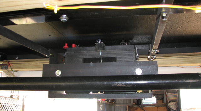

The weather in MA is now allowing me to working on the camper. It may be hitting a high of 40 degrees today, but the last couple of days have been in the mid to upper 60's. The long planned for battery cage installation was time to implement. My tongue weight was right at the maximum of 200 pounds for my car so it is time to shift the battery (60 pounds) from the tongue further back on the trailer. There is no place to mount it above the trailer floor so I have no option but to mount it below the trailer bed.
The first picture is just getting the camper up on the ramps so I can get underneath. You can see the battery cage at the left side of the picture, and in the next picture. It is on a creeper so I can move it into place under the camper. You can see it sitting on a box, which I call my "battery elevator." The battery with steel cage and wood weights about 70 pounds...much to heavy for me to lift into place with one hand while I secure the 4 grade 8 bolts with the other hand. The "elevator" is 2 wooden boxes, one inside the other, top one upside down. I then inserted a bottle jack inside with a 4" lift capacity. By jacking up the top box one pump at a time I can life the battery less than 1/4 inch per pump, gradually lifting it into place to allow me to insert the bolts.

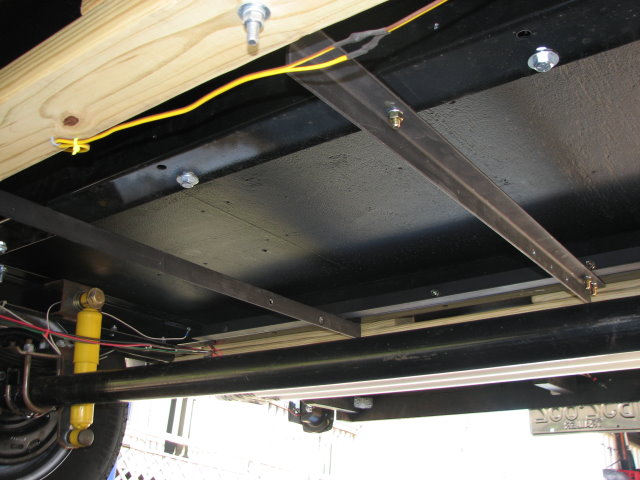

The next picture shows the battery cage rails installed under the camper. They are bolted, again with grade 8 bolts, through the frame with additional angle iron for additional support.

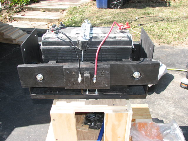

The next 2 pictures shows the battery cage installed, from the front, and from the rear.
This final picture shows the battery wired into the 12V circuit and ready to do it's job.
Before with battery on tongue...tongue weight 200 lbs. Battery moved to just behind the axle and underneath...tongue weight 135 pounds. Well worth the approximately $60 invested to move it.
