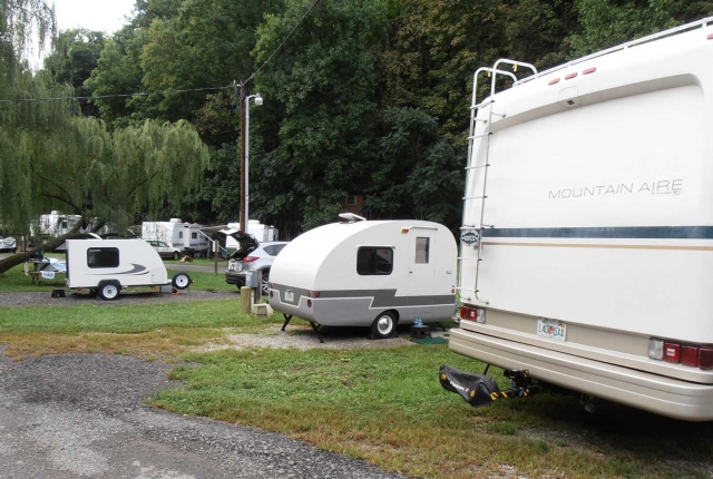

Well -- took it out for a much longer shakedown... discovered some foibles and shortcomings, but all in all a good trip. Oh. And it rained.
(Wouldn't be camping if it didn't rain.)
But also found out that it's not the smallest TTT in the park...
Kinda puts it all into 'scale' doesn't it?
