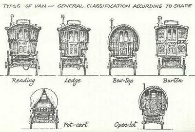

Well I made the 1st step in starting my Reading Vardo. I purchased the trailer this past weekend that will be the rolling base. I will be using a VW Beetle as a tow vehicle. I was originally considering a teardrop design but in my research found that the Gypsy Vardoes reflected more of my Flamboyant personality as well as my taste in what I want out of my traveling rig.
The trailer has a load footprint of 4'x7' & because the tow vehicle is a VW Beetle I have wt concerns. Because it is a Vardo aerodynamics is not something I am even going to concern myself with for obvious reasons.
I will be building on a slide in camper design so I can still use the trailer as a trailer. I am going to replace the tung with a longer one & add Y braces then weld it all together. I will also go up to a 2" trailer ball. With a base footprint of 4'x7' I will be able to work with living space dimensions of 6'x8' and standing height of just under 6' in the center incorporating the Reading Style wagon design.
Overall wt will be a factor so I am going with an uninsulated single wall construction with an external skeleton that can be used as decorative features consistent with a Reading Vardo. The interior will feature Tapestries, Curtains & Valences along with an Electric Fireplace for heat and atmosphere. The space will be small and cozy but large enough to put a bed sideways in the nose with 4' of space in front of the bed.
