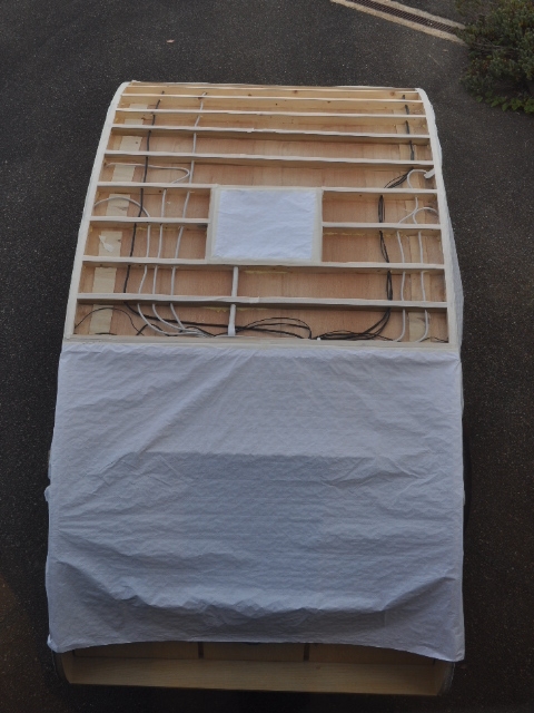

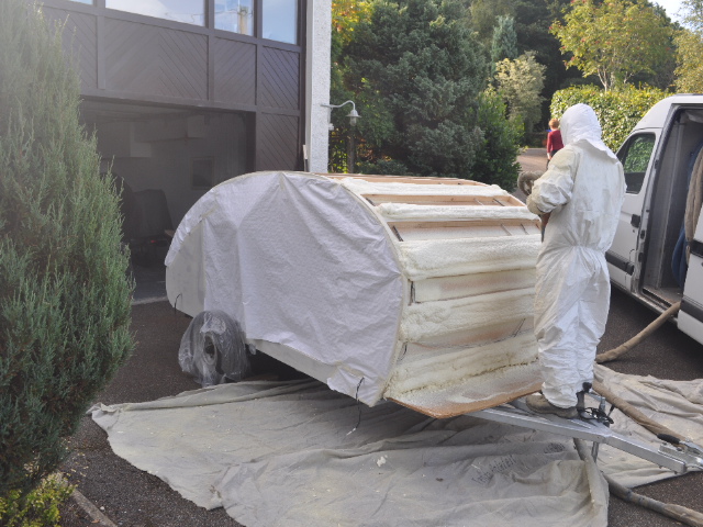

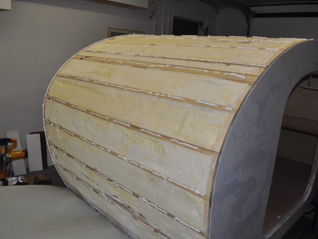

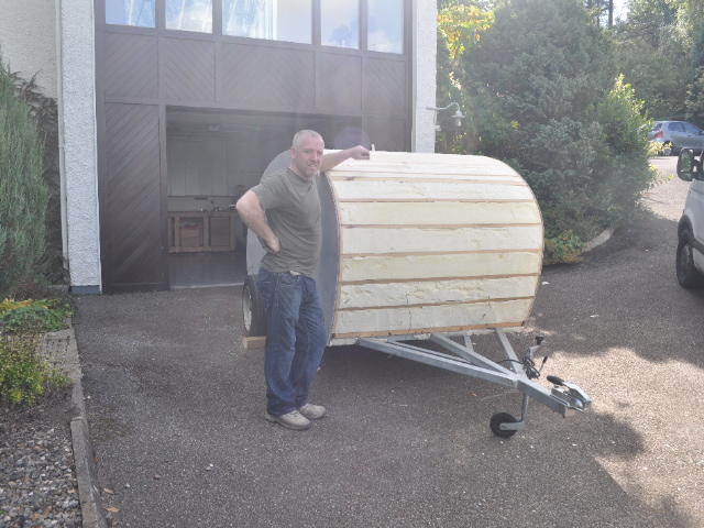

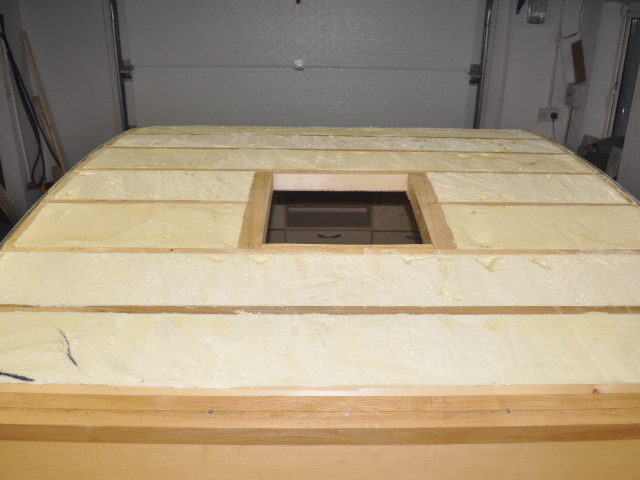

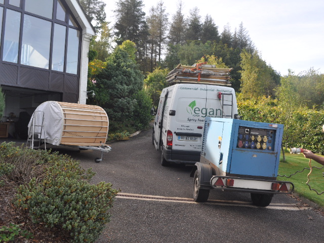

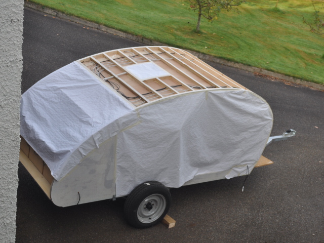

Today I managed to get the roof insulated. In the end I decided to go for a professional closed cell foam spray because it would add to the strength of the trailer as well as insulating it. The first thing I had to do was some masking using banquetting roll (disposable paper table cloth that comes in a 100' roll):

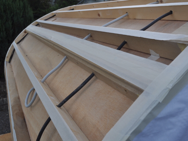

I taped up the spars and the sides too:

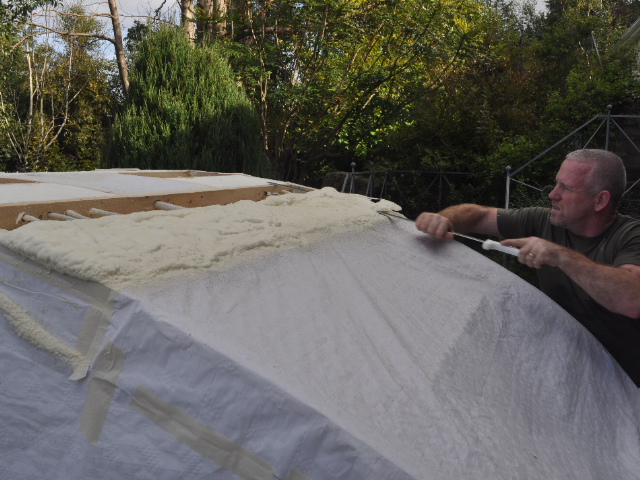

Then the professional arrived! Fintan decided to spray up alternate voids first:
This meant that it the excess could be cut off easier. He had a samuri sword sized breadknife for this bit:
Then the rest of the voids were filled and trimmed - voilla!

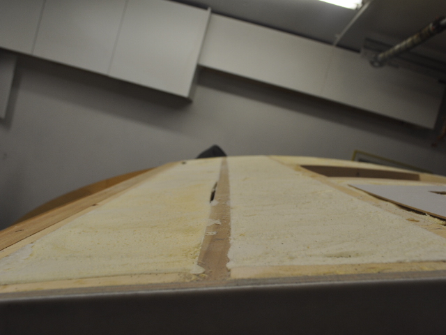

This method of insulation has made the trailer really strong and rigid. It has in effect glued everything together to one uniform monocoque structure. It means as well I don’t have to skin the roof with plywood.

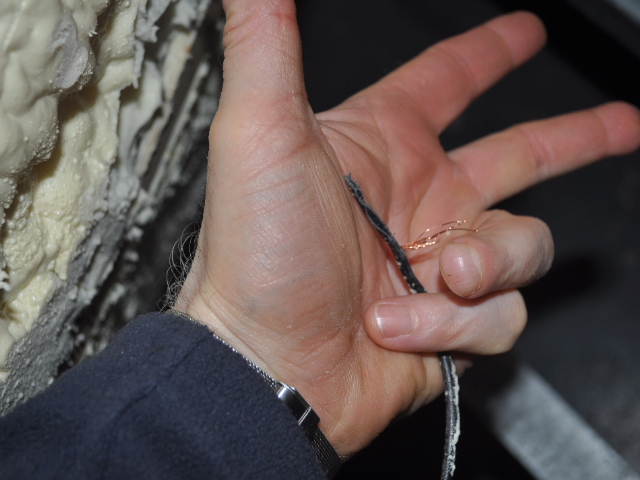

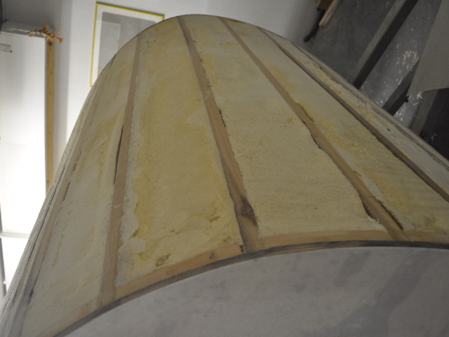

One mistake I made however :shock: was that I did not sufficiently tape down one or two of the stray wires in the roof voids and some of them floated to the top with the expanding foam and then got cut with the big serrated bread knife:
No real damage done though. I'll just have to splice and join the wires before the roof sheet goes on.

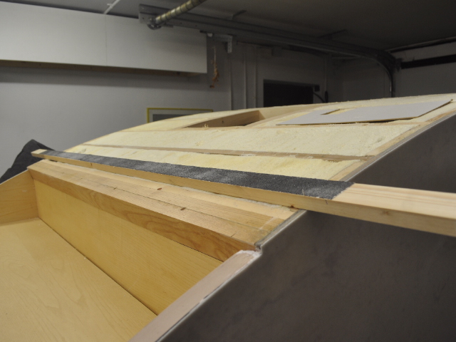

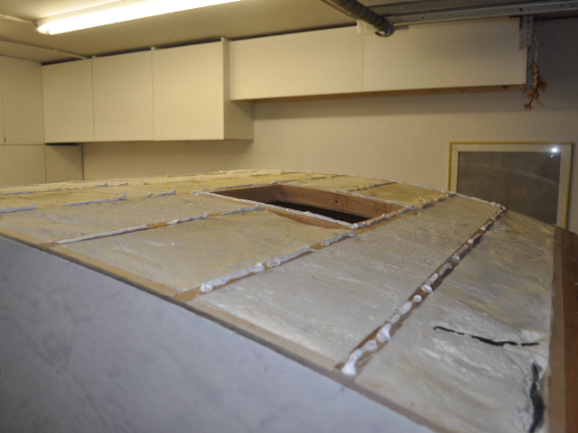

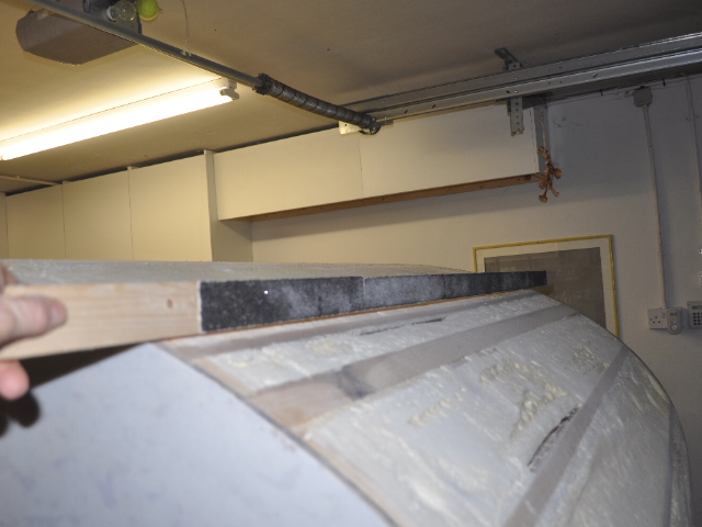

Yes the foam worked out great. It is very messy to do but it conforms really well to the shapes.
I used a bit of 2"x1" timber with some sandpaper to form the shapes
I got the sandpaper and 2"x1" idea from Tim of the the "Tucon Tortoise"
Cheers Tim :thumbsup:

Thanks very much. You're right the foam will make everything super airtight and that will mean that ventilation is key also. I am fitting windows that crack open by tilting out so keepin a trickle of ventilation should be possible.
The remark about not having to sheet outside with ply means that the FRP goes on to the roof directly I am not required to put down a covering of luan first.

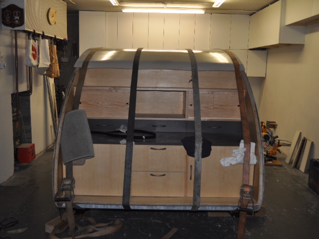

Postby McGuffin » Wed Sep 30, 2015 6:39 pm
Atomic77 wrote:If you get a chance you might check out my build where I initially installed the Filon on the roof. This material is very unique and has weird expansion rates. Taking into consideration what I learned from my build, I'm thinking I would still use a thin plywood, then glue the FRP down with contact cement. I tried a couple of ways and the latter method is the only way that didn't go crazy when it was in the sun.
noseoil wrote:Larry, Michael has a good idea here. Even if you use the method which you're planning, & it's a food one, at least try a test panel to see how the glue & structure beneath it are going to work together as temperature changes things and the skin trys to move & crawl around in the heat. I still remember the picture Michael posted, when he had been away for a week, opened the doors, & saw what had happened!
It wasn't a pretty sight & the amount of re-work was very time consuming & involved for him. It turned out very well, but it was a lot of work to make things right again. Just sayin'.....
Oh Feck!

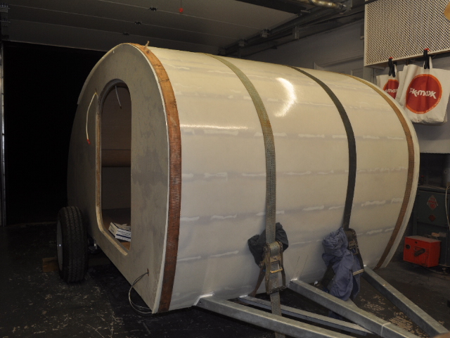

Thanks Michael and Tim, I have just read your posts AFTER I stuck on the FRP !! :cry: - exactly how you advised I shouldn't !! So in a blind panic, I went back and looked again at the Astroliner build. I see the problems you had with heat and expansion but I don't think that the stuff I have used is the same material. Here is the stuff I have:
http://www.grpconsultants.co.uk/translu ... sheet.html
Then I saw this photo that you posted Michael. It appears that the Filon is much more flexible by compasison. The stuff I have could not curve like that.
Also elsewhere you said that
Atomic77 wrote:The Filon I used comes in 7 and 8 foot rolls. There is a good side that has a peel-off protective coating.... .
My stuff has a smooth side and a reverse side which has a fibrose (fibreglass finish) so it is definiately different material.

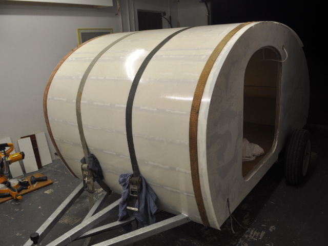

So .... in my ignorance and optimism I just put beads of glue on the roof spars and down the outside edge.
Then folded back the FRP sheet onto the roof (with about an inch overhang on each side) and scrinched the whole thing together with cargo ties. Because the material is translucent I could see the material squishing out the glue underneath!
KCStudly wrote:Don't forget that heat expansion is a linear phenomenon. Meaning that the magnitude of the effect is dependent on the length of the material in question. Every inch grows the same amount, so the growth is proportional to the length; so a longer piece (bigger camper) will have more of a problem than a smaller one.
I'm not saying don't consider the issue. Far from it, but I think part of the reason Michael had such a dramatic occurrence on the Atomic build was due to the much larger than typical TD size of his panels.
Thanks KC - That is food for thought. I'm hoping that FRP will stand up to heat fluctuations OK - but I don't know for sure yet. I found this statment on the web:
" FRP composite panels ....[are] unaffected by a wide range of temperatures, (-65 °F to 135 °F). FRP panels are used in designs where a certain measure of strength or modulus of elasticity is required ..... the fiberglass reinforcement increases strength and provides good performance over a wide temperature range versus thermoplastics which are greatly affected by temperature. "
This might also explain why the UV protected corrugated plastic roof in my greenhouse cracks and creaks when the sun shines on it - being thermoplastic.
I'm hoping that the fibres embedded in the back of the FRP sheeting will hold the roof panel together and sufficiently resist the heat expansion caused by our mild Irish summers (when they arrive every 5 years or so). Incidently, I'm hoping as well that the glue I put on does it's job too ;) .... watch this space !! I'll let you know in four or five days when I pull off the straps.
Thanks for all your input and great suggestions,

Re: Tigin Linn - Little House and Us
Postby noseoil » Wed Sep 30, 2015 10:58 pm
Larry, I'm NOT familiar with your product! It's actually a bit thicker & much more rigid than I had thought it was when you mentioned it initially (about 0.05" thick at 1.3mm is how I have to think of it in 'Merican). Judging from the pictures you've posted, it took the curve very well & looks like it is working the way you have it strapped down now. It's acting more like the aluminum skin I used this weekend than a light fiberglass, which I mistakenly thought it was.
Are you planning on using some fasteners along the edges & molding to secure it at the corners? If so, I think it should be fine the way it is now. If the adhesive bonds well and sets for a long enough time, it should stay put & once it's painted should look very nice.
About the expansion, I ran the numbers for the aluminum I used and it came out to about a 4mm total movement in an 8' sheet. My temperature range is a bit more extreme than you have where you live. You may be able to find a data sheet giving you the coefficient of linear expansion (per length, per degree of temperature change). I'm sure it's out there, just a question of finding it & then doing the math to predict how much movement you can expect from winter to summer.
Again, looks like it went down very well!
