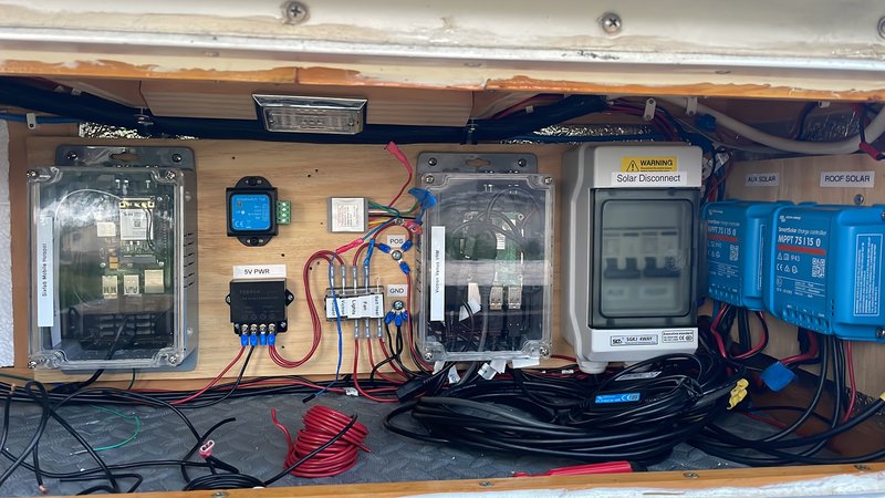

Hi Bruce and Featherlite, I am still mulling the best way to deal with adding more solar capacity. Money seems to be the common denominator!
Currently, the roof is 210 watts, potentially expandable to 410. The aux panels are 200 watts, potentially expandable to 400.
Two 100 watt panels for the roof are $175, plus $150 for mounting (aluminum angle, stainless hardware, 3M VHB tape, and cables). = $325
Two more matching 100 watt suitcase panels for the outdoor auxiliary system are $280 (eBay, as they are out of production) = $280
Perhaps the more challenging aspect of the project is getting the electrical system to absorb double the watts of solar.
Option 1: Buy bigger solar charge controllers.
The Victron 100/30 can convert 440 watts of solar on a 12 volt system. The more I think about it, the more I think I would want this controller and not the smaller 100/20 which has a 290 watt max. The 75/15's in there now have a 220 watt max. The 100/30 controller costs $214 and potentially I should get two. Another problem is the space constraints I have in the electrical cabinet. The 100/30 is a big unit.
One 100/30 will take as much space as both 75/15's at the right side of this picture. That would cause another redesign/reorganization of all the components you see here, and even then I am not sure there would be enough room.
Option 2: Convert to 24 volt and continue to use the same charge controllers I have now.
On a 24 volt system, the 75/15 controllers can convert 440 watts of solar. Normally 24 volt would not be a real option, except that in my case, I built my LiFePO4 battery from 8 cells:
The bus bars could easily be reorganized for free into a 24 volt battery, and a 100 amp 24 volt BMS from Overkill Solar goes for $139. If I go with an 80 amp 24 volt BMS instead, I could get it for $97.
So far this sounds great! Except...
I would now need a 24 to 12 volt converter. Victron sells those, but we'd be looking at about $103 for a 40 amp version or $72 for the 25 amp version. I would need the converter to run the 12 volt equipment, like lights, fan, Propex heater, and the USB chargers. Victron's units are 95-97% efficient.
So far, this still sounds good. Except...

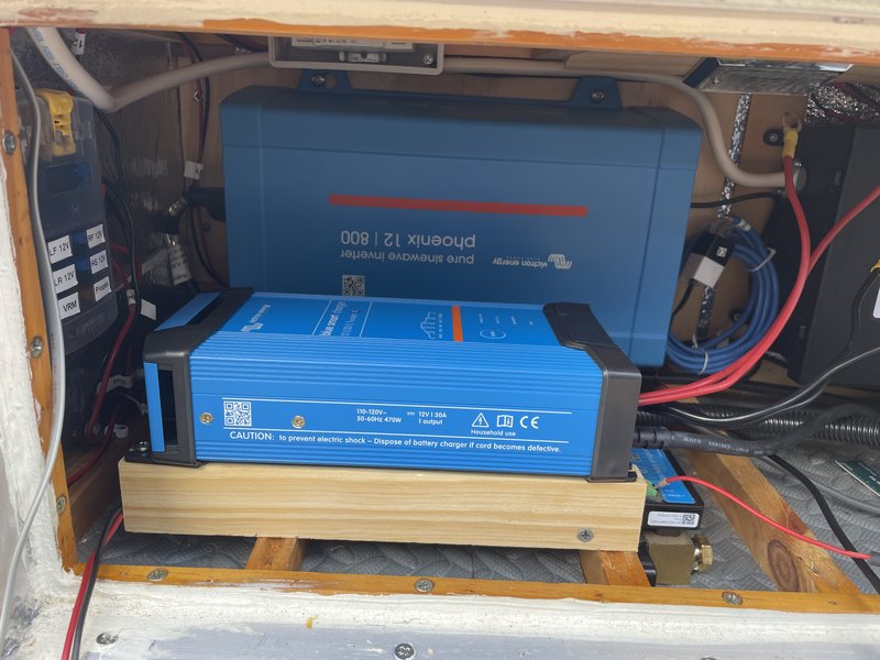

I would need a 24 volt version of my 800 watt inverter and 30 amp battery charger.
At this point, things are getting much more expensive. The 24 volt inverter is $271 and the 24 volt 16 amp charger is $207. I could potentially step down to the 500 watt inverter which is only $151.
So the damage (not including new solar panels & mounting options) would be:
Option 1, 100/30 charge controllers: $214-428 depending on if I get 1 or 2 of them. (And lots of work reorganizing the electrical system to fit the available space.)
Option 2, 24 volt conversion: $527-720 depending on if I get the lower vs higher wattage components listed above. (But no real change in layout of the electrical system.) The cost of the 24 volt setup could be lowered a bit by purchasing used/open box Victron equipment on eBay, or by selling the existing 12 volt equipment to recoup some cost.
Option 3, stay at my current 12 volt (non-expandable) 210 watt roof + 200 watt aux solar setup: Free.
Option 3 is looking pretty good!

I am wondering if you have enough room in your electrical cabinet to install a wood partition wall, vertically in your electrical cabinet, and then mount a third Victron MPPT on the partition wall.
I am visualizing a partition wall installed perpendicular to one of the walls, attached to that wall and to the ceiling and/or the floor (or some variation thereof or somewhere else in the electrical cabinet).
My thinking is that you could keep your existing system and use the extra MPPT to run the extra panel(s) you are thinking about. For example, maybe use the new MPPT to run your ground deploy panel(s) wired in series to accommodate a long wire run.
Just thinking out loud.

Would it be more cost effective, and easier, to devise a way to tip your existing panels toward the sun. Seems like some sort of tilting frame would result in much better output of your current setup. (Keep in mind that I am so far down in the weeds in my solar energy tech knowledge, compared to y'use guys.)

Thanks for your suggestions. I will definitely think about adding partitions in that electrical cubby to create more surface area for larger charge controllers to be mounted. I have my eye on some used 100/30’s on ebay, which are going for almost half the cost of new. I have no idea how much life is left in them, but that is a seriously good price for Victron stuff. Unfortunately I find myself in the midst of expensive Jeep repairs and don’t think I can carve this out of the budget just yet.
Angling the panels gets up to 30% more power compared to flat panels, so it is definitely a good idea. My roof panel can be angled up, but the trailer has to be parked facing south for that to be worth it. I often do this when storing my trailer in the winter, as the short cold days in December make it hard to recoup the power used to warm the batteries and run the VRM. It does work. I usually look at the aerial photos on Google Maps when making campground reservations, not just to see if there are too many trees shading the campsite, but that the driveway faces a southerly direction. The mobile auxiliary panels I have are great for catching sun at an optimal angle all day long, as long as I am there at the campsite to periodically reposition them. They can easily out-produce the roof panel with some attention from me.
Here is a photo that shows the camper in the shade but the auxiliary panels making nearly maximum watts.
The wiring and input connector on the side of the trailer will allow me to double the aux panels if I can afford to buy them. These particular panels are no longer being made unfortunately, so the only option if I want them to be the same is to find them used.

lfhoward wrote:I will definitely think about adding partitions in that electrical cubby to create more surface area for larger charge controllers to be mounted.
That's what I was going to suggest as well. I ran into this same problem with my trailer; the electrical system evolved overtime and took up more room than I planned for during the build.
