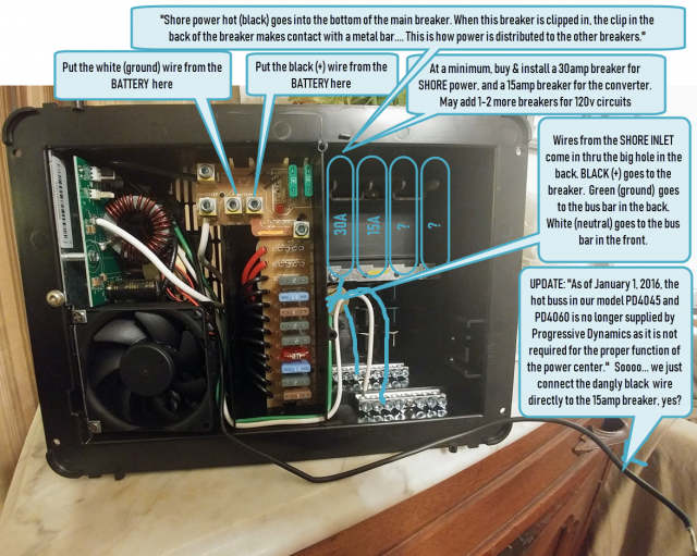

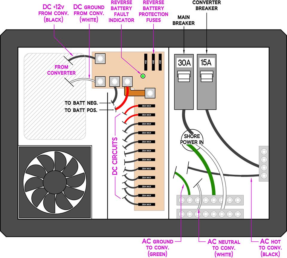

Over the past couple of months I've acquired my PD4045 and a battery, so I'm ready (mostly) to move on to the final stage of the electrical work: hooking up the juice.
I've spent the past week or so poring over the instructions that came with the PD4045, springdew's installation guide http://www.tnttt.com/viewtopic.php?f=30&t=67143, and this diagram http://www.tnttt.com/download/file.php?id=9796, plus some other wiring diagrams from the forum.
Everything finally makes sense to me, except for two things.
QUESTION ONE
Springdew says, "Run a green wire from the ground buss to the frame." Well, that's simple enough. But some of the diagrams I've seen run a wire from the ground buss to the BATTERY, and then from the battery to the frame.
Is that approact NOT appropriate in this case because the negative terminal will already be hooked up to the PD4045? So I wouldn't need to hook anything else up to the negative terminal, and would instead connect directly to the frame?
QUESTION TWO
What do I do with the neutral wires coming from my light fixtures? The positive wires get connected to the 12 pre-installed wires on the PD4045 that connect to the fuses. But where do the neutral wires connect? The neutral buss bar doesn't have enough holes to accommodate all 12 circuits. Do I need an external buss bar to receive all of those neutral wires? And if so, do I then run 1 wire from this external bar to the neutral bar in the PD4045?
In case you need to refresh your memory, here is a pic of my PD4045, with annotations that are basically an updated version of the diagram above, translated into plectrudis-speak.

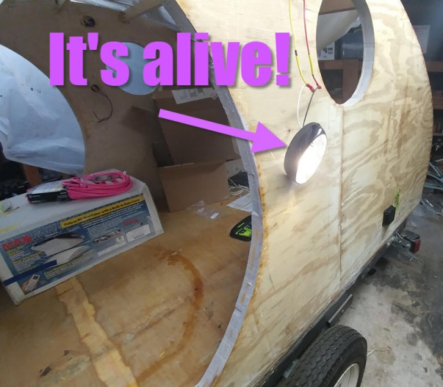

I hooked up the PD4045, the battery, the grounding block, and one light fixture, and--to my everlasting astonishment--I made light happen!
(Actually, at first it didn't, and I thought, This thing is so complex, I haven't a hope in hell of tracking down the problem. Despair. But then Mr P pointed out that the porch light has a switch on its base, and maybe I should turn that switch on? Clever Mr P.)
This is actually kind of a dry run, just to see if I've actually understood what I was doing so far and that everything is hooked up right. Plus, I need more light inside the trailer as I work on the interior. But I'll probably have to disconnect some of what I've done once the bulkheads and galley shelves are in place. That's okay. If I've gotten it to work once, I can do it again.
Some elements to note:
1. For some reason, the PD instructions said to use the black wire coming from the battery for the NEG terminal, and the "white" for the POS terminal. This is weird on a couple of levels, since the battery itself is color-coded for black = POS, and RED = NEG (there is no white). Mr P suggested that I match the colors to the battery, since it's more standard. So I used black wire for POS and red for NEG.
2. I made a grounding block to receive all the negative wires from the 12v circuits and ran a wire from it to a bolt on the trailer. Then I ran another wire from the bolt on the trailer to the red/NEG post on the battery. Evidently, this is a fine thing to do.
3. I still need to install the battery switch and fuse/breaker.
4. I've wired up the power inlet, but haven't plugged it in yet. So I have yet to test the charging function on the PD. I'll also need to put a switch on the POS wire from the inlet, so I can shut it down, if needed. I'll probably install all the switches first, then turn on the juice.
