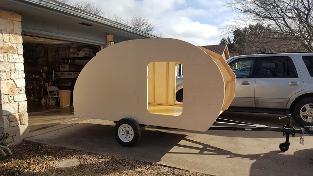

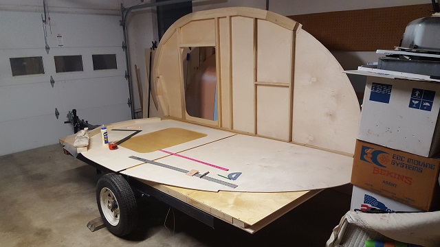

Well, things are progressing slowly. Over the past month or so I've been working on the starboard wall framing. I have most of the framing in place forward of the galley bulkhead. I'm still working out the details of the hatch to sides joint so I wanted to get at least one wall vertical and temporarily in place so I could visualize things better.
This is a wide angle photo so some of the framing looks skewed. It really isn't. Everything is nice and plumb and level that should be. Rather than finish the wall framing aft of the bulkhead I have gone ahead and started framing the port wall. After that piece has caught up to it's twin I'll continue designing and building out the wall design before starting on the galley area and the cabin interior cabinetry. I've also started planning out the electrical systems. At this point I think I'll go with a 12V deep cycle battery on the tongue and charged from the Jeep to power all the lighting and a few USB charging ports and a separate 120V system to power a few outlets in the cabin and galley from shore power at established campgrounds. I plan to use propane canisters for cooking and possibly for lighting in the galley while boondocking. No solar and no battery charging from shore power at this point.

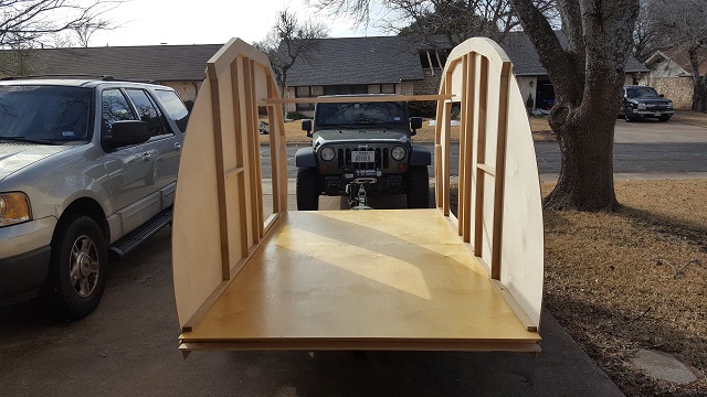

Today wasn't really a build day. The only tools I used was a ruler and a pencil. This was the first day in about a month that the weather and my health allowed me to even play with the project. I rolled it outside into the driveway and stood up the port side wall and temporarily braced it to get a give me an idea of the size of the finished project.
It is bigger than I have been imagining for the past two years of looking at drawings. It is going to be interesting to see how the Jeep behaves when I try to go somewhere with the teardrop in tow.

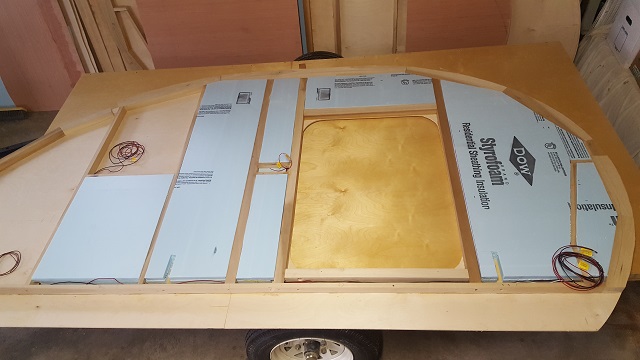

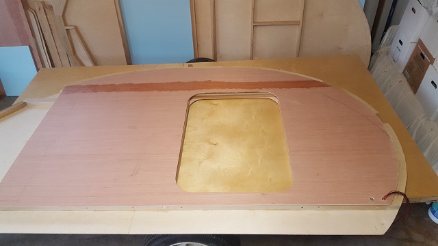

It's been a while but today the stars aligned (weather, health, time, money) enough for me to spend the day working on the teardrop again. I glued in two layers of 3/4" foam panels into the port wall framing and ran most of the wiring for that side of the trailer.
After that I decided to cut down the wall template from it's exterior wall skin profile to that of the cabin interior. That involved cutting about 5.5" off the bottom edge of the template, cutting off the aft end of template at the interior edge of the bulkhead, and trimming the roof curve down 1.625" which is the thickness of the headliner and roof foam and fiberglass.
The interior wall template is just laying on top of the port wall to help visualize the interior wall at this point. Ignore that extra hole to the left of the one with the wires! Measure once, drill twice, not!
Next up will be finishing the port wall wiring, cutting the interior wall out of 1/8" birch ply, and routing out the ledge at the top of the wall for the roof system to rest into. Then on to the starboard wall. Forward!

First I finished running the wiring in the port wall. My fuse block and ground buss bar will be in a cabinet in forward end of the cabin. When I cut the foam for each wall cavity I left an inch open at the bottom of the wall and drilled holes thru each wall stud as a place for the wiring bundle to run. Wires go from the floor up inside the the wall just aft of the door frame (for the cabin and porch lighting and for the roof vent fan) and just forward of the aft bulkhead (turn/brake/licence plate on galley hatch and power for galley lighting).
Next I sanded down the foam insulation in the wall cavities. The walls have 1.5" framing and there are two layers of 3/4" rigid XPS foam. Unfortunately, the XPS is actually .8" thick so I have to sand it down level with the framing before I can apply the interior wall skin.

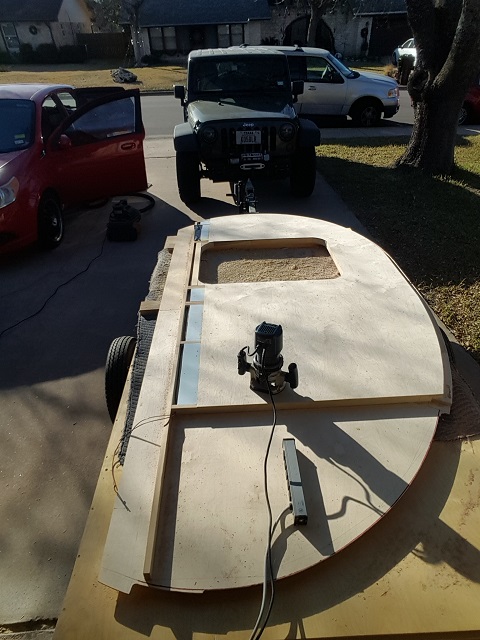

Postby Lou.Catozzi » Thu Dec 27, 2018 2:00 pm

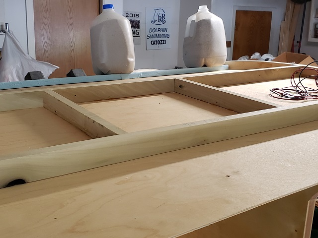

Well, I've been picking away at the project for months, just doing a little this or that as several design challenges percolated thru the grey matter. I finally got thru some of those issues and actually spent most of a day back before Christmas working on the tear again.
After checking that I had all the wiring that I wanted run thru the starboard wall framing I dumped about a pint of TB2 all over the inner wall framing and insulation and lay out the inner wall skin - a 4x8 sheet of 1/8" BB ply. There is a 5" gap between the bottom edge of this ply and the bottom edge of the wall. I will fill this gap with a removable piece of ply later. This removable piece will give me access to the wiring and to the bolts that will help attach the walls to the floor.
Image]
Here is the starboard wall the next day after I removed all the weight and trimmed the edge with the router.

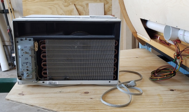

Wow! My last post was over 6 months ago! Where does the time go. I haven't really done much of any work on the camper lately but over the past few weeks I've finally made up my mind on the first major upgrade. I've decided to replace the springs, axle, hubs, and tires that came with the 5x8 trailer kit from Northern Tools. The more I looked at those stock tires and wheels the more doubt kept creeping into my mind about their quality and durability.
I am probably going to go with a Dexter Torflex axle with electric brakes and 13" wheels and passenger tires. I've also decided to go out and buy a 12,000 BTU window a/c unit for my two-car garage where I am building the camper. The attached garage is probably not insulated but it should make it a little more bearable to work in there during the Texas summers.
