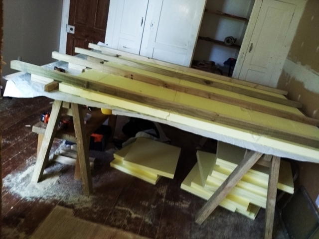

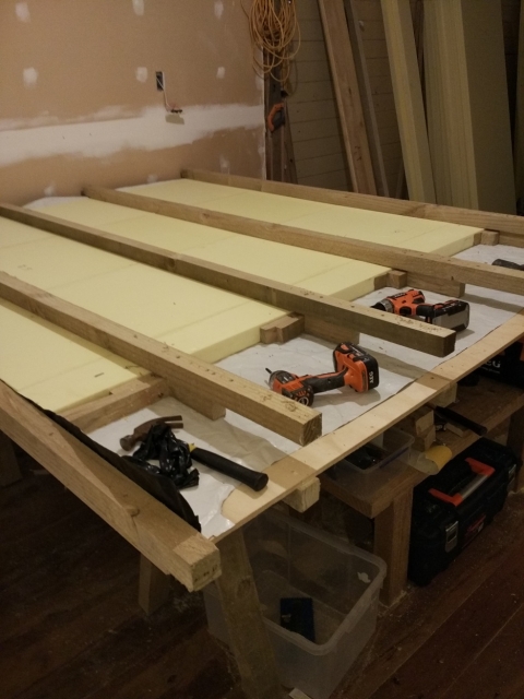

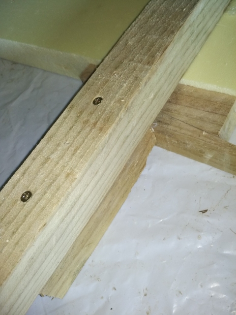

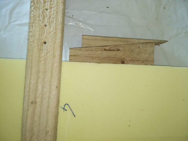

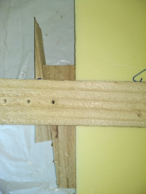

Been busy for a fortnight on other stuff. Today finished the sash clamps and epoxied some foam together as an experiment. Decided to cut off the shiplaps and do a ply tongue instead. The fitup of the shiplaps is too terrible to work with ...nothing is straight, tongue thicknesses vary etc. :? Easier to start again. :roll:
Here is the gear.

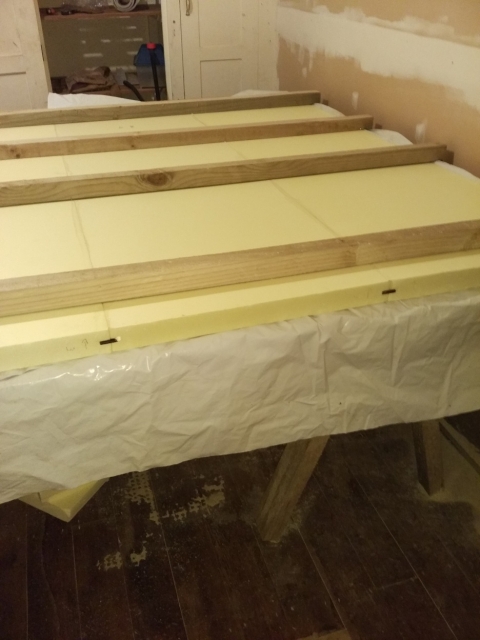

Here are the sash clamps being used for a test epoxy run:
Firstly, the sash clamps work with simple wedges:
The bars have a moveable lump of pine screwed to them

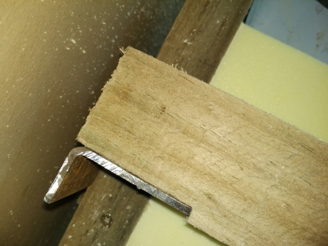

This is a shot with the wedges hammered (rubber mallet) into place:
Here are the angle iron "hooks" at the other end of the bars:
Here are the hooks on a rail (the same thickness as the foam) that is screwed to the table:

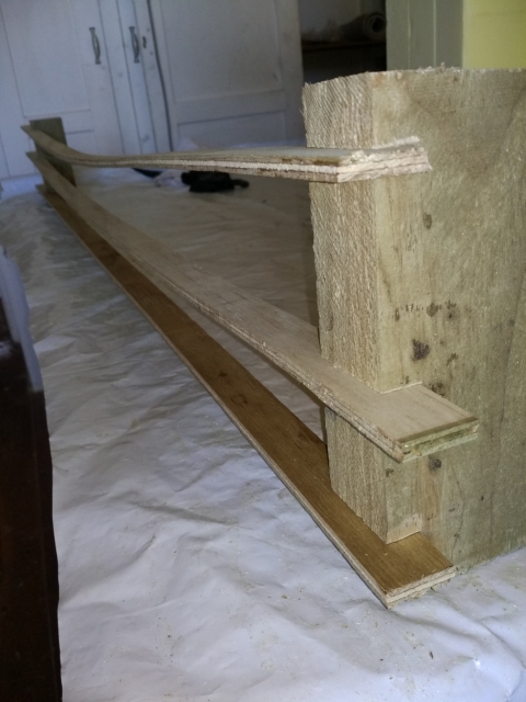

Here, for those of you with good eye sight, :( is the reason why the shiplaps have to go; the impossible fit-up!:
I am going to set up my saw and router and process all the foam at once, I think.
It's a fair bet that Dow Corning wouldn't be able to sell this foam in America, with such a poor finish. I had to drive one hundred miles to pick it up. No real problem, I can work around it.

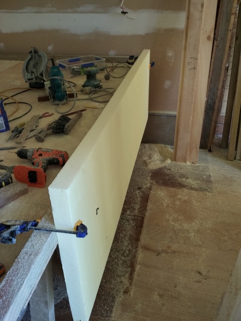

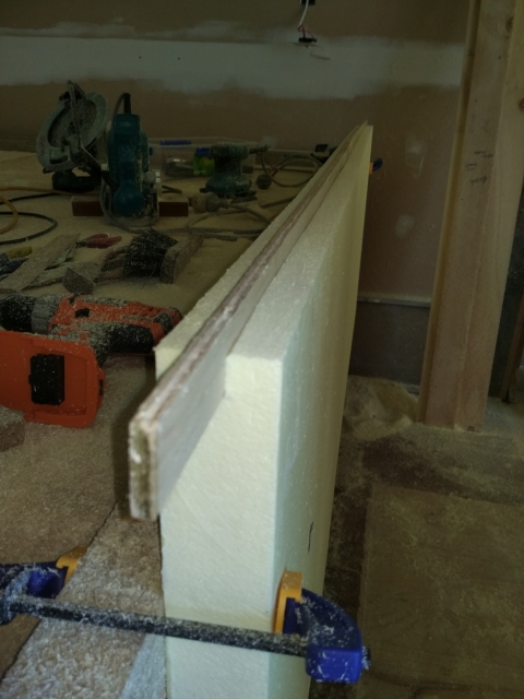

Postby hossesdad » Sun Apr 23, 2017 4:03 am

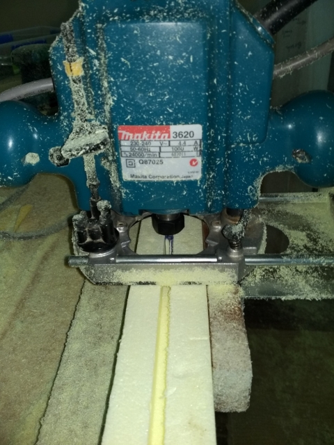

Cut off shiplaps and squared and straightened the foam boards for all the walls. Here is one squared board.
Trusty Makita router cut 8mm grooves to take 7mm plywood splines. Following previous experiences , rather than try and centre the groove in unreliably thick material, I set it slightly to one side and marked all the boards appropriately. All small variations in thickness are gathered on the inside.
Board with splne in it, dry run.
Splines were painted with neat epoxy, then thickened epoxy was made up with microfibres (West) and the grooves and board edges coated, then the spline was coated with thickened epoxy and the whole lot assembled and firmly (but not brutally) clamped.
The finished boards while epoxy is curing. This is half of one side wall. The white/black plastic protecting the table is old sileage cover, about 250 micron I believe, washed, I have 200 square metres of it. Epoxy doesn't stick to it....or not very well.
