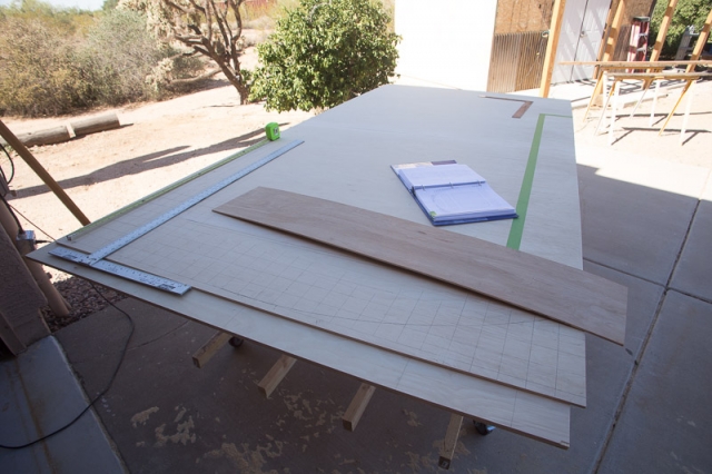

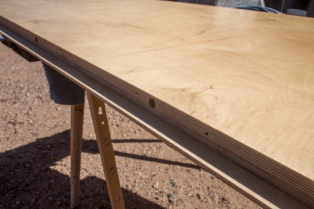

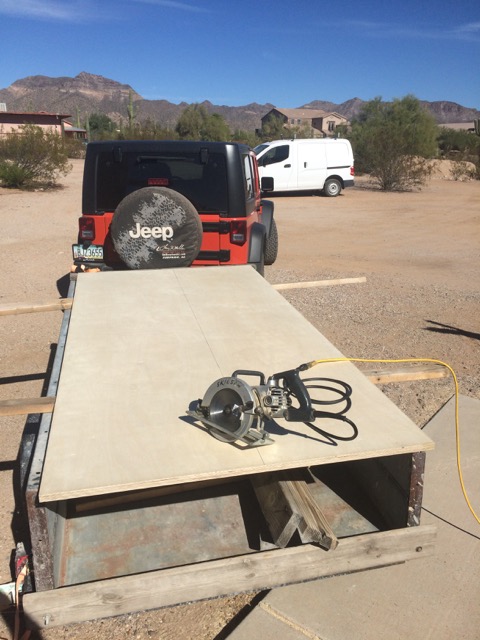

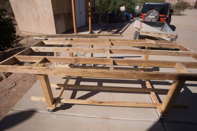

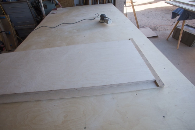

I first build a table workbench that will be 5' X 10' with a 1/2" top. I used left over 2X4's for the scaffold I built to do the stucco on the shed that is in the background (that I need to finish :roll:) The wood was kind of bad from being outside in the sun but I had it and made it work with a lot of shims.

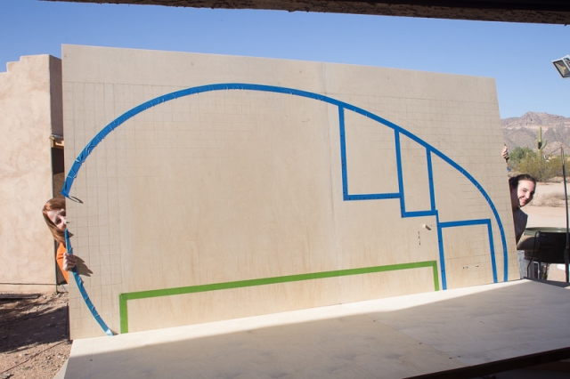

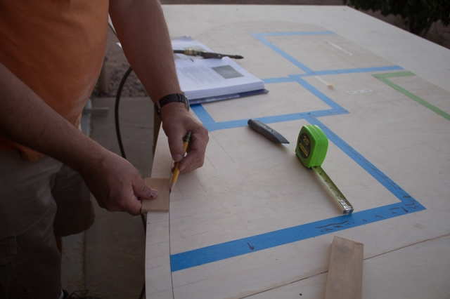

Next was making patterns. I used some 1/4" BB for that. two pieces with a half lap joint to a 5X10ish size. I made two patterns so I didn't have to cut the first one down. My wives best friend also wants a teardrop so there may be a V2.0 at some point. And I'll have the patterns.
Started some layout grids and then kind of eyed it up from there. A disc sander with 50 grit makes a great eraser. :lol:
After a few tries we got a profile we liked. The green tape is the mattress, blue tape are the cabinets.

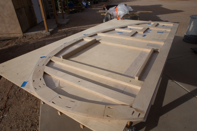

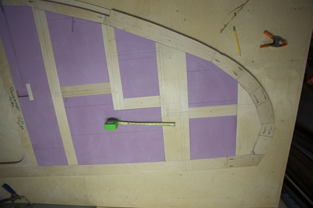

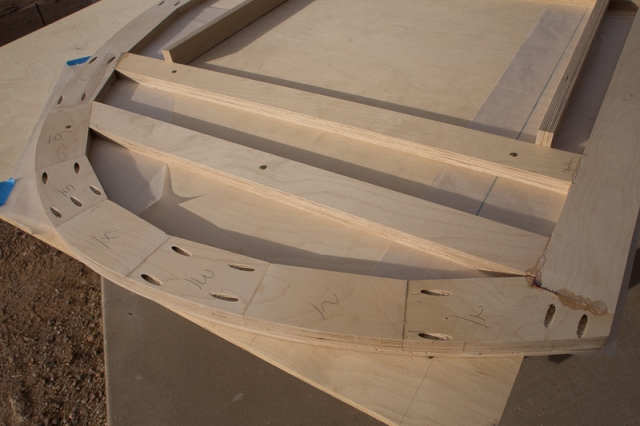

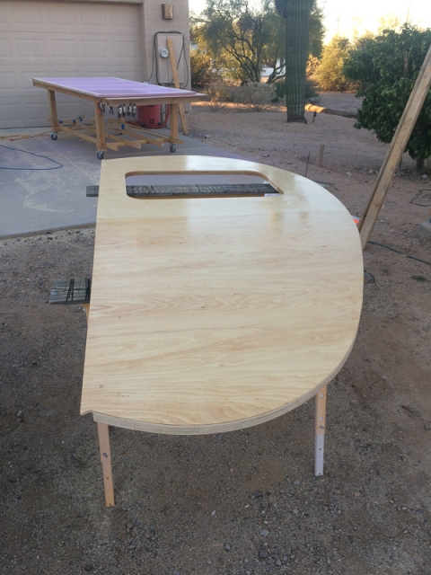

More half laps joints in 1/4" BB for the sides.
Laying out the headliner at 1 5/8" on the pattern.

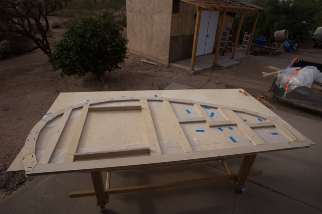

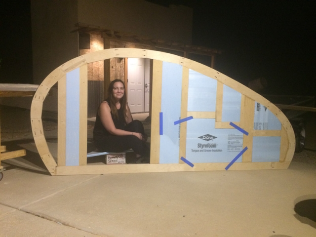

I built the inner wall using the skeleton method, the missing pictures are of building the skeleton. Here it is finished.

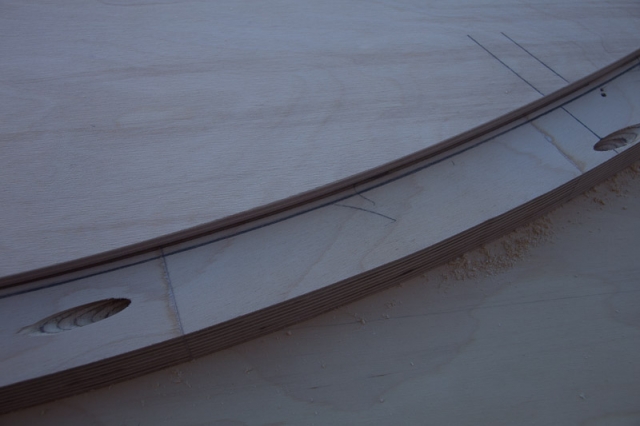

I used the jig saw and cut close to the line then cleaned up with the belt sander right to the line.

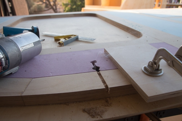

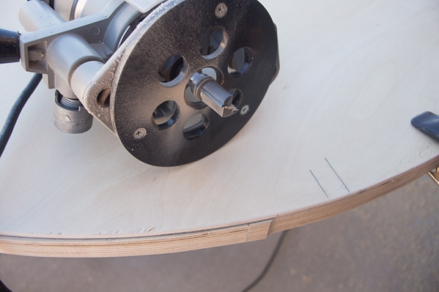

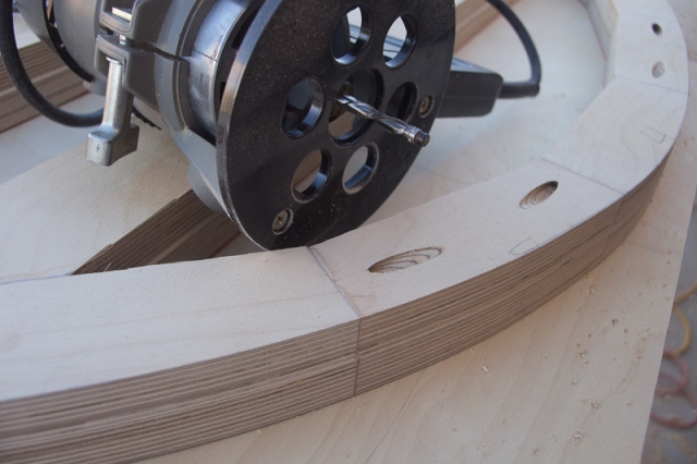

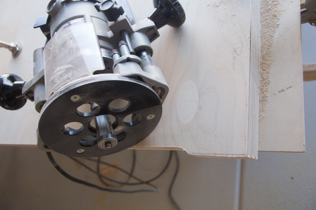

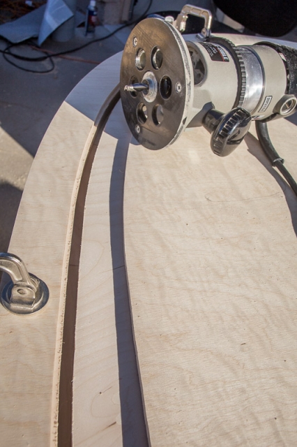

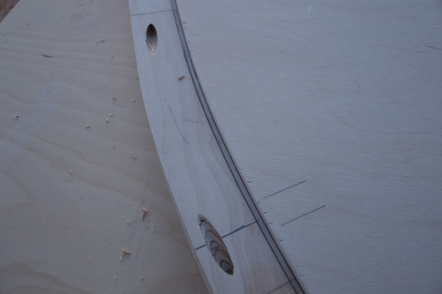

Then I copied the pattern to the skeleton. I didn't want to use the 1/8" router bit like it says in the manual. I don't think it's safe using a RotoZip adapter in a regular router and I was routing 1" material.I could only find 1/8" bits in 1/2" length. I uses the jig saw and cut the center of the two lines. I figured I can clean up to the line with the belt sander again when I have to install the cut offs between the spars.
Then I used the router with a flush trim bit to match the pattern to the skeleton.
I cut the other skeleton the same way and then used the first skeleton at a pattern to train the second.

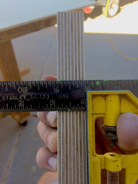

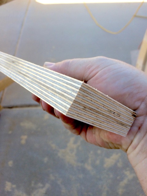

For my inner wall I used what is called 1" Baltic Birch. I say called because all BB will come in metric sizes and I was told it was 25mm thick but it was just under 24mm if I recall. So that meant the rigid foam all had to be sanded. Not hard to do just more time. But it was easy to work with just cutting a bunch of 3.5" wide pieces out of a 4X8. But BB is heavy (so much for lightweight) but it is stable and strong.

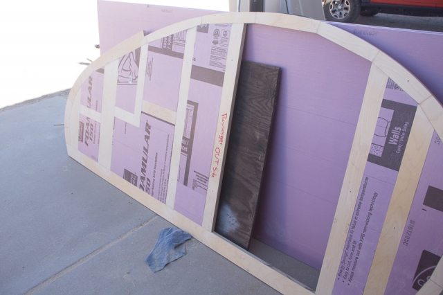

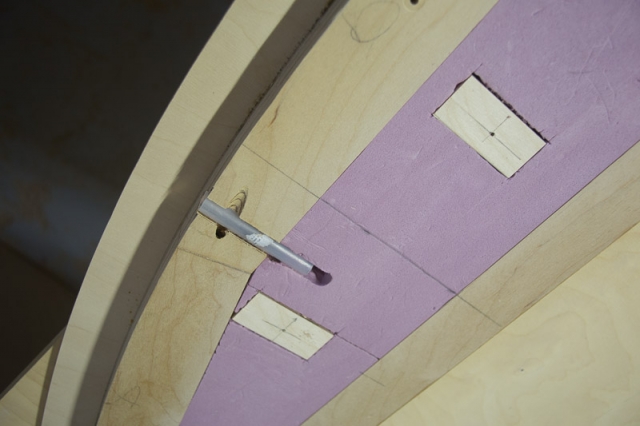

Once I had the skeletons walls done I cut all the foam to fit, easy to do before the outer skin goes on. I still need to finish the rough in for the door. I did that after the outer skin was put on.

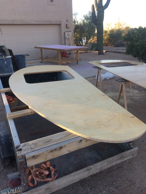

Postby KTM_Guy » Fri Feb 09, 2018 12:57 am
A little more tonight.
It's starting to look like the teardrop.

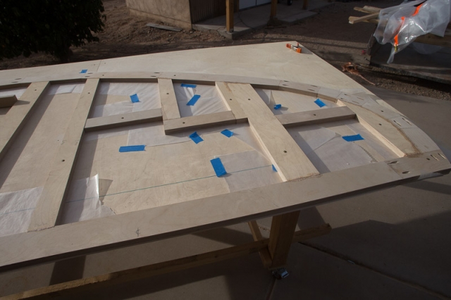

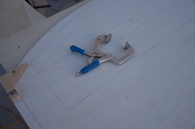

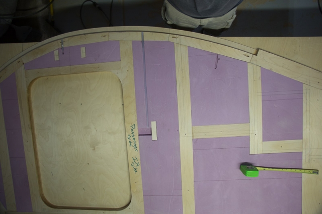

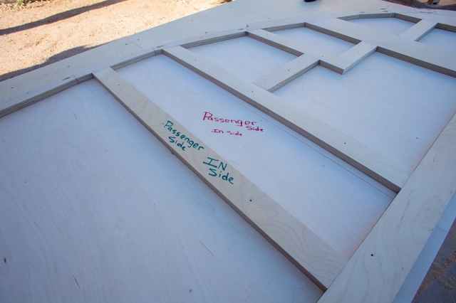

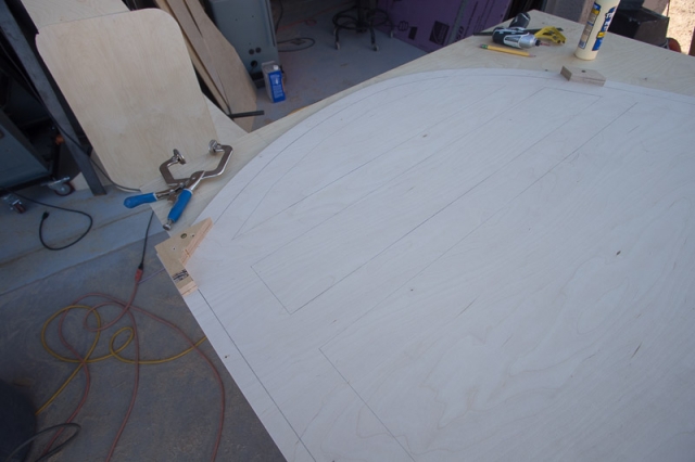

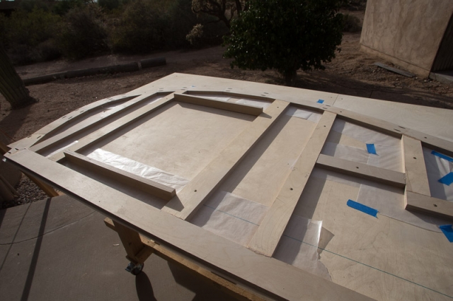

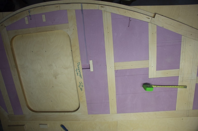

I'm marking the outer skin where to put glue for the skeleton. Everything was labeled with colored markers to help eliminate mistakes when glueing. In this case the other side of the skeleton is marked in red "passenger outside". Same colors get glued to each other, never different colors.
Some brackets were added to help aline the skeleton once glue is applied.

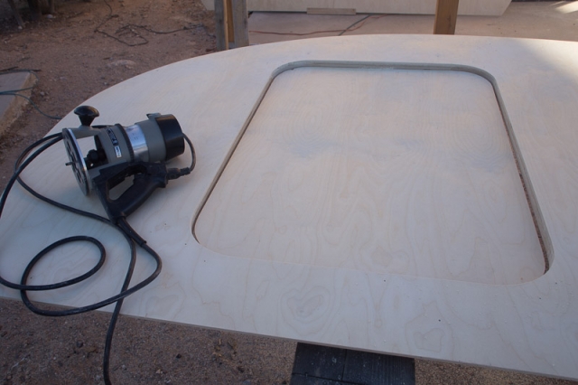

Cutting the outer skin door out.

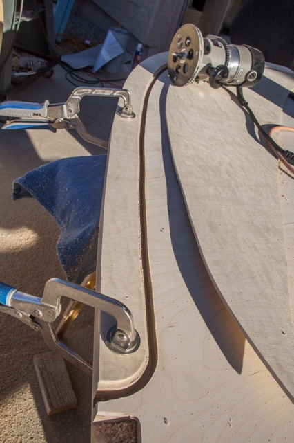

Once the skin was glues on I reinstalled the foam glueing it in place. and then sanding it flush with a disc sander with 50 grit paper. I also used the poly water tubing in 1/2" OD for raceways for electric wiring. Also wood blocks were added for screws to hold on the switch plate and the outdoor light above the door. Sorry for the bad pictures.
If you look close in this picture you can see smoke, I routed the groove in the wood and a shavings were hot enough to melt the foam, I'm glad I noticed it and didn't go in to eat or be done for the night. :frightened:
A few coats of epoxy on the outer skins.

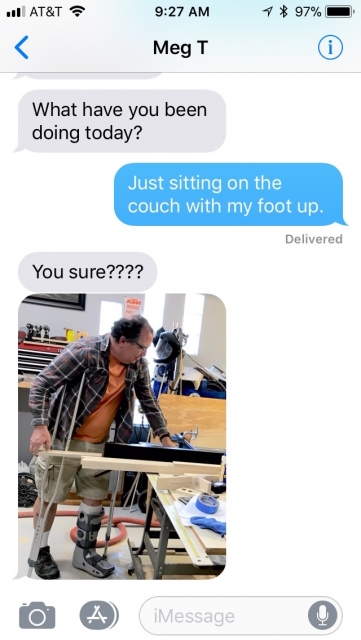

Postby KTM_Guy » Fri Feb 09, 2018 8:45 am
Another setback. :lol: My wife texted me this, :oops: She came home to get something and I didn't even know she was home. So I'm cut off from the garage until I get an okay from the doctor.
This was about three weeks ago, so I am getting close to where I am at now.

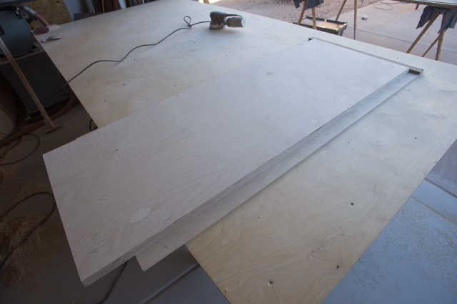

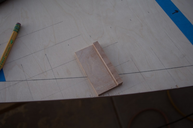

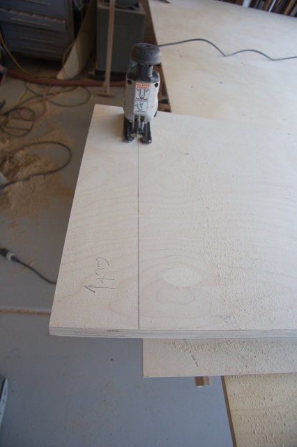

So before the surgery I took some measurements for the cabinets and started getting some wood cut. I don't have a good way to crosscut long panels, so I made a jig to cut them with a flush trim bit in a router. My inside width on my walls is 55 3/16" (or something close to that). that is what the jig is set for. Every horizontal board will get cut this way for the cabinets.
It's just 1/4" BB with a stop on the end.
I do a rough cut with what ever saw is handy which is usually the jig saw.
Then use a router with flush trim bit.

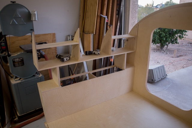

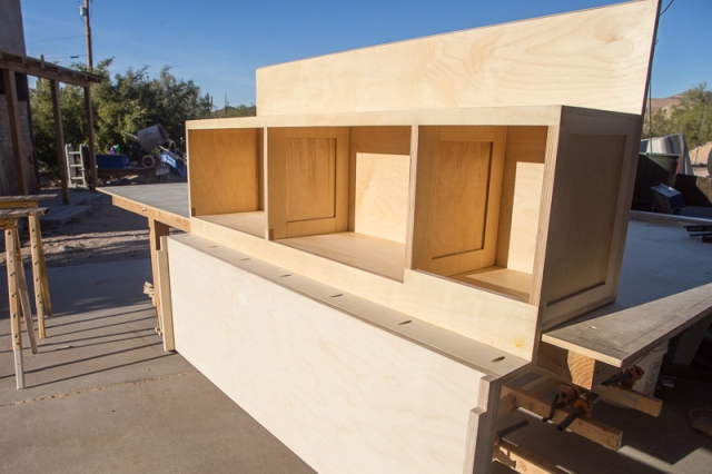

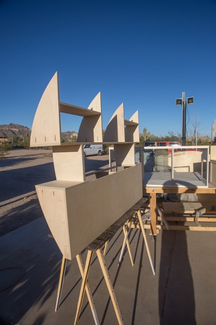

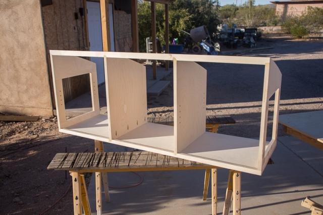

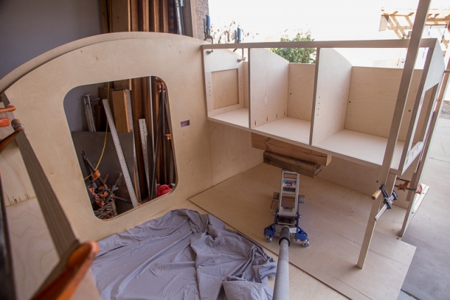

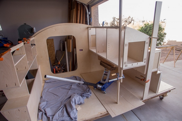

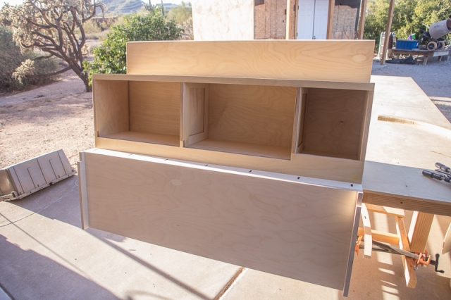

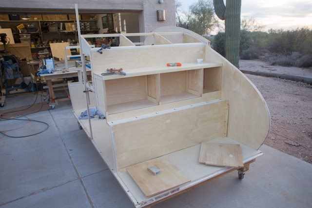

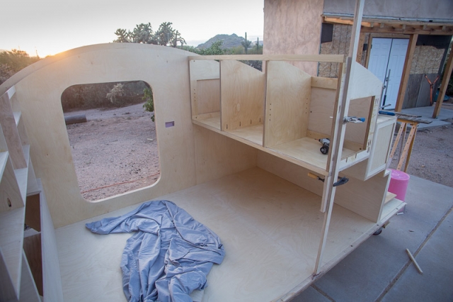

Started to work on the cabinets.
Galley cabinets.
Aft cabin cabinets. Not complet in this pic.
Fore cabin cabinets.

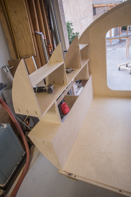

Getting installed.
Moving to the Galley and aft cabinets,
Galley.
Up next is to skin the inner wall of the drivers side and seal. Then get that put up.

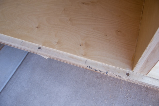

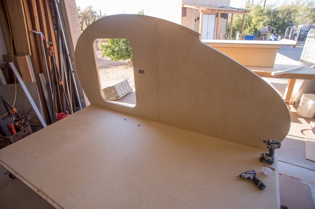

I got the drivers side skinned and ready to put op like the other side. I attached the walls using 3" screws and 1/2" oak dowel rods to help register the holes predrilled for the screws. From the photo you can see the inner wall on the top, middle wall where the holes are drilled and the outer wall on the bottom. It covers over the side of the floor so I can glue to to side of the floor and the top of the floor. Lots of surface area. I was just going to use the dowels to line up the holes but got thinking why not add more and make the rods 4-5" long. I used epoxy to glue the walls and the dowels.
Here is the floor, with the holes drilled.

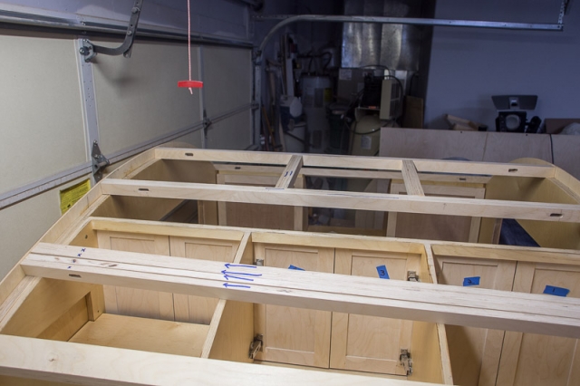

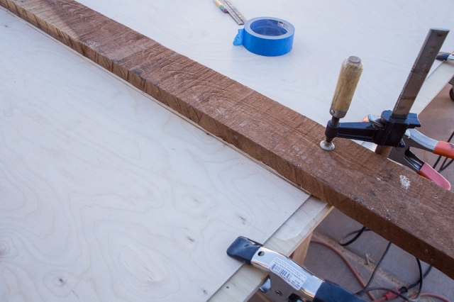

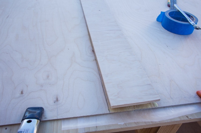

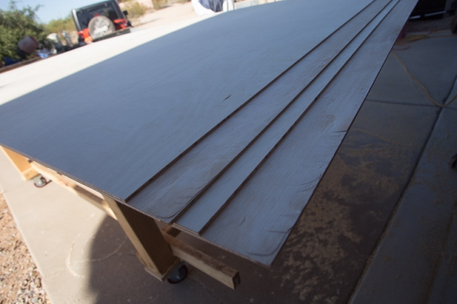

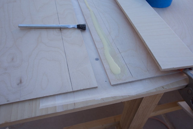

Up next was to make the head liner, I placed the seams to fall inside a cabinet. I spaced the two sheets of 1/8" BB 1/4" apart and clamped a straight edge so my router with 3/8" straight bit would just hit both side and give me a great fitting head liner.
Got the wax paper down.
Clamped with a board the had a bit of warp in the middle.
The plan was to next get the head liner varnished and then installed but the weather was not going to corporate. So I did some other stuff until the weather broke. Got the spars cut and holes drilled for wiring.
I finely got the head liner installed and some insulation cut (just what I had left over from the walls). This is about up to where I am right now in the build. I am back to work now so will have maybe an hour at at night and the weekends to work on it now. My plan is to have the spars and some insolation done by the weekend, then I'll start pulling some wire. My electric will be minimal compared to some builds on here. Most of the wire will home run to the tongue box. Nothing to crazy. Also working on cabinet doors, lots of sanding and varnish.
