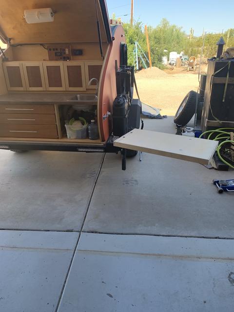

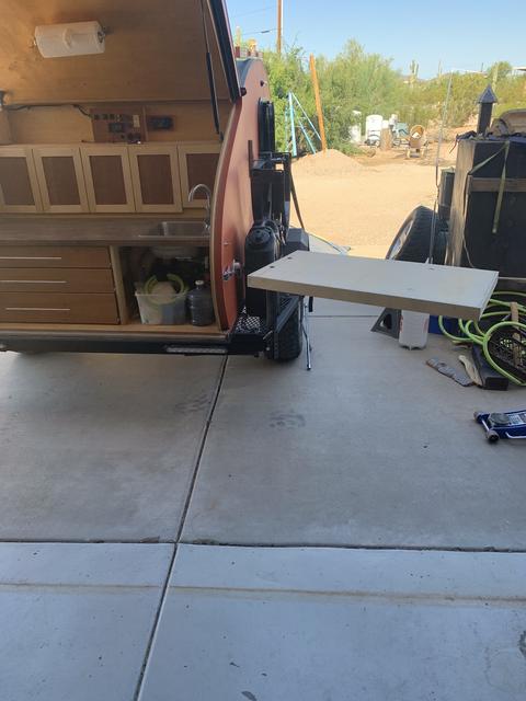

On the rear bumper on both sides I welded some 2X2 tube to be the receiver and used 1.5" square tube to make the stand the table sits on.
This is the passenger side where we put the table we use to eat at. So far about 75% of our campsites haven't had tables, and I really wanted to have a table that was easy to setup and solid. I can adjust the height on the table depending on the ground and which chairs we are using on that trip. It can also be moved up higher to the same height as the galley countertop which is quite high.

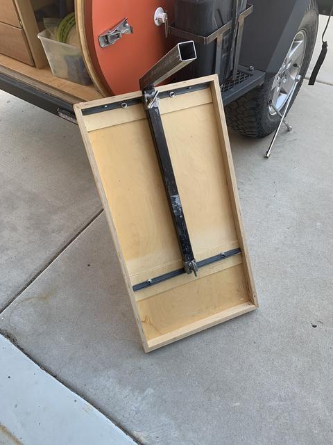

Here is the back side how it mounts.
This is at the low position that works good with our chairs.
And the high position. It's hard to tell from this picture but the table is just a few inches lower than the countertop.
We haven't been using this table much yet. The idea is good, the size is good. The problem is the size of the square tube. It is hard to find square tube that has a good fit inside another tube. It's either too tight or too loose. The ideal size for 1.5" tube is 1.75 12 gauge but it is impossible to find. I had a source for is back home but can't find it out here. So I can have trouble sliding the tube in and out. I could go to 2X2X3/16" but even short pieces of that is heavy. Which brings up another point is the table is heavier that I think it should be.

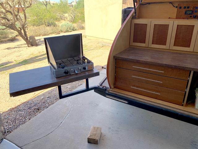

Lets move on to the other side that is for the stove. We use this table almost all the time. The only time we don't is if we get to camp late and are not cooking a dinner. Or if we are getting an early start in the morning and will just cook on the galley countertop.
I have been happy with this setup. It opens the countertop to prep food and plates. It is easy to level the table with the bolts to connect it to the stand. Just as long as the camper is level that is. And it is easy to level the camper with the four jacks. I really like the extra space on the side of the stove too. That said I'm going to try a few different sizes and see if we can get away with a smaller size. Two reasons for that, first is to cut down on weight and second is to cut sound on storage space. I designed to tongue box to fit the two tables and stands, it would be nice to free up some space in there.

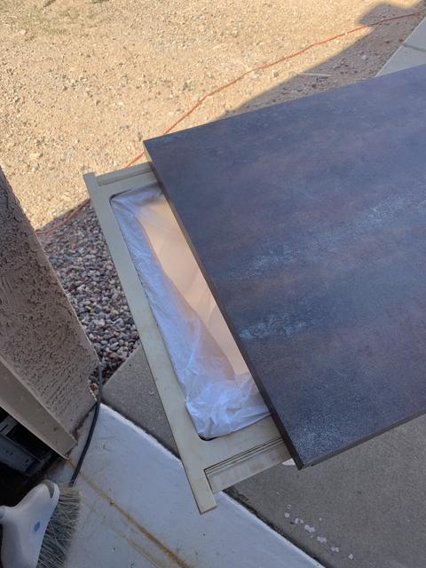

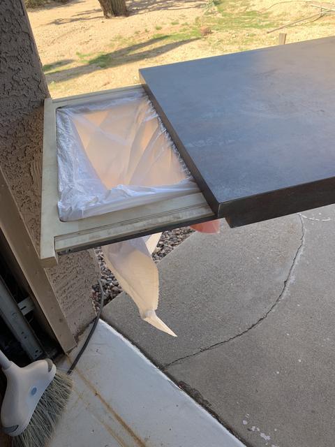

On the end of the table is a pull out where we can hang a garbage bag. This has been great, the bag is secure from wind and it's hard for bugs and bees to get to.We have camped with 50 mph winds and no problem.
