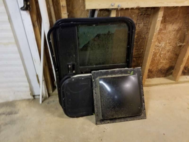

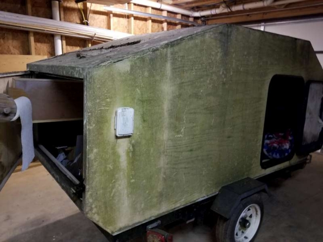

We got 6 years of use out of the Weekender, but a few years of sitting out and neglect, it is time for a rebuild. Demo started on April 28, 2018

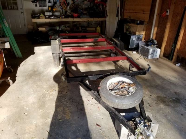

After a few hours of demo All that was left was a trailer, the door and window.

I am going with a 10x5 Benroy on a 4x8 HF trailer. Going to add a 2nd door, and keep existing window. Air conditioner will be reused as well. Will end up with 1 1/4" framed insulated walls and ceiling, and 2 .75 inch insulated floor ( to clear wheels. ) It is gong to have a maple interior, with a cedar stripped exterior. Time for the fun to begin!

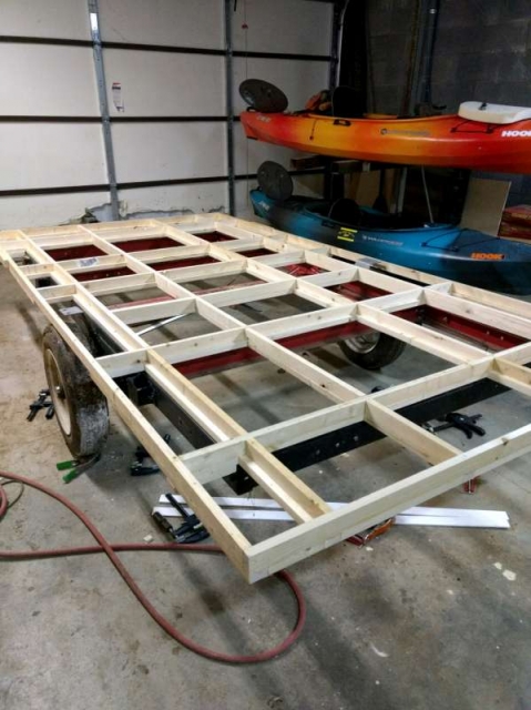

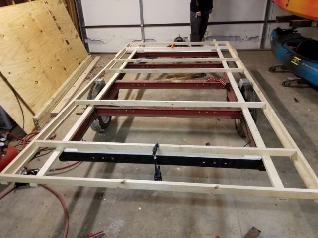

April 29, 2018
Starting framing floor. I am building a littler thicker in order to raise the floor enough to clear the wheels. I am thinking about going with a wider axle and 14 inch wheels, but wanted to have the option to keep existing. We have put over 10k miles on it as is, and I still have the 2 spare packed hub that i purchased in 2010 with the trailer that have never been used.

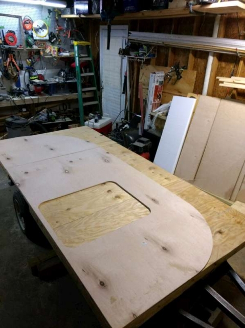

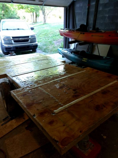

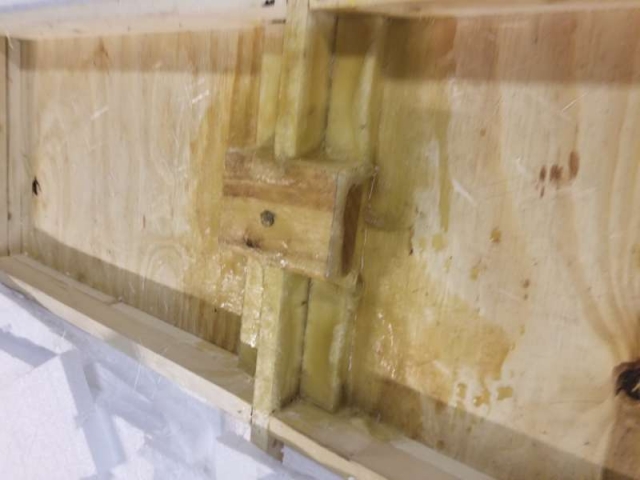

Postby Carl01234 » Mon May 21, 2018 10:43 am

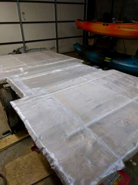

May 5,2018
Floor framed sheeted, insulated and glassed. Went with 1 layer of 6oz and 2 coats of poly resin. Put 1/8 inch spacer in. Glassed 2x4 's for bolt connections. Painted bottom with black hammered.

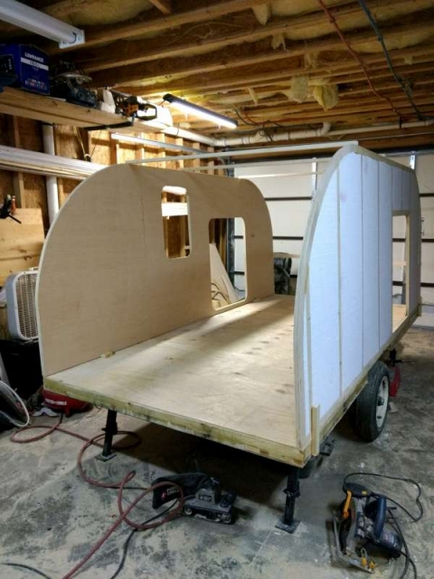

Postby Carl01234 » Mon May 21, 2018 11:00 am

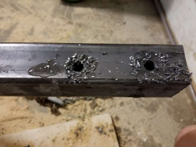

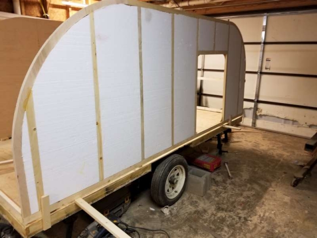

May 16,2018
After a week break to ponder, I took a long 4 day weekend and got quite a bit done. Began wall construction. The walls are 1x2, inner skin of 1/4 maple and 3/4 foam insulation. Finished walls in a day. I forgot to get pic of the curved wood wall frames and galley hatch spars. They were all cut from 3/4 maple ply and then belt sanded for conformity. I also added a 2x2 square tube and extended the trailer 18" as see on here. Much stronger A frame now. I also purchased a 2" couple that matches my boat trailer. Very quick install, just drilled out the hole.

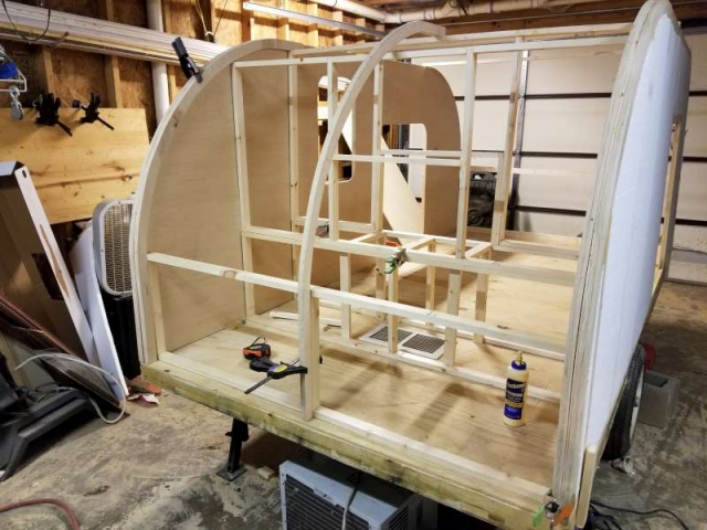

Postby Carl01234 » Mon May 21, 2018 11:07 am

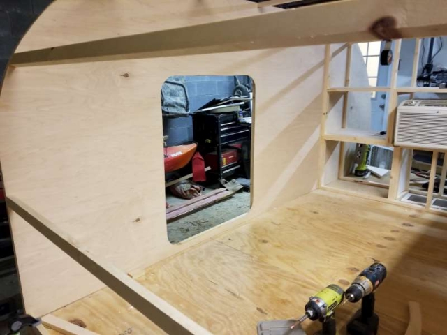

May 18, 2018
Walls went up and began galley framing. Didnt really have a plan going in, so it was a slow process. I love how the maple looks on the inside.

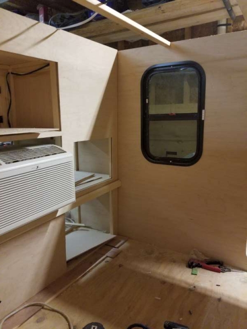

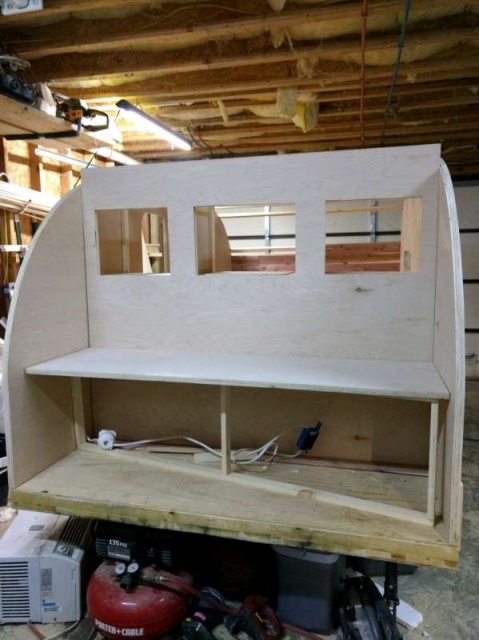

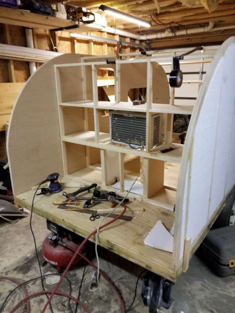

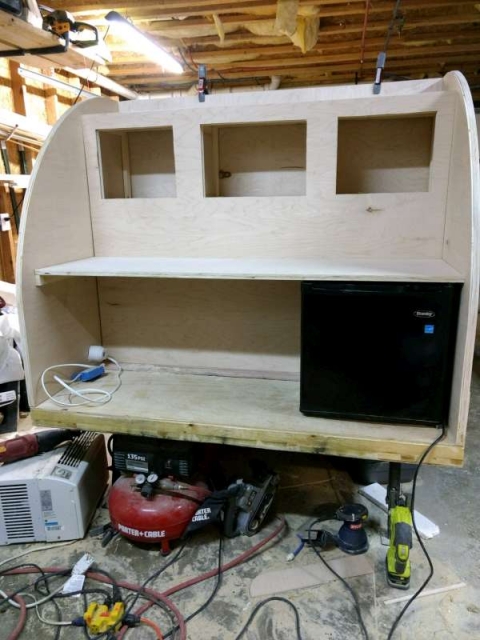

Postby Carl01234 » Mon May 21, 2018 11:14 am
Galley work continues. Fitting for the a/c. On the weekender, I vented the a/c through the floor and it worked well. So, I am doing the same on this one. Did raise the a/c to clear mattress and covers and did lose some space, but it was a good trade off.
Put some test strips up temporarily to see how it will look from outside and the ceiling inside.

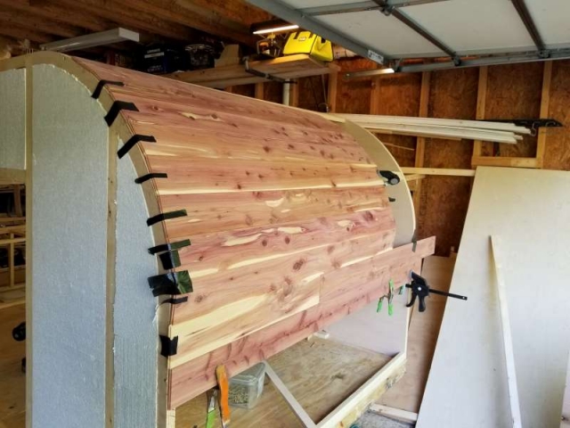

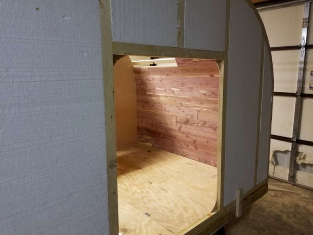

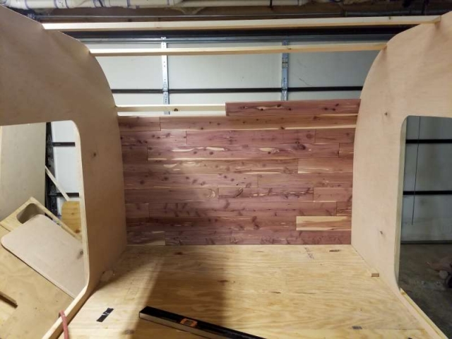

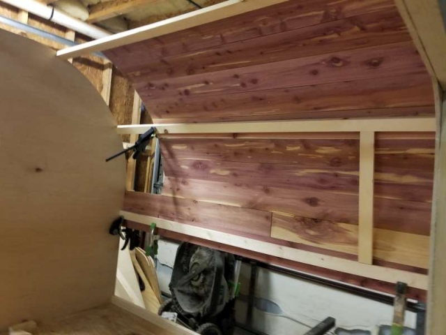

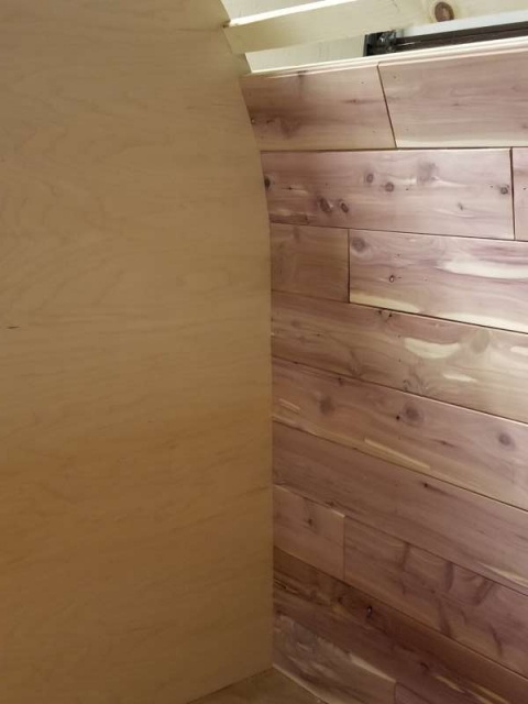

Postby Carl01234 » Wed May 23, 2018 6:20 am

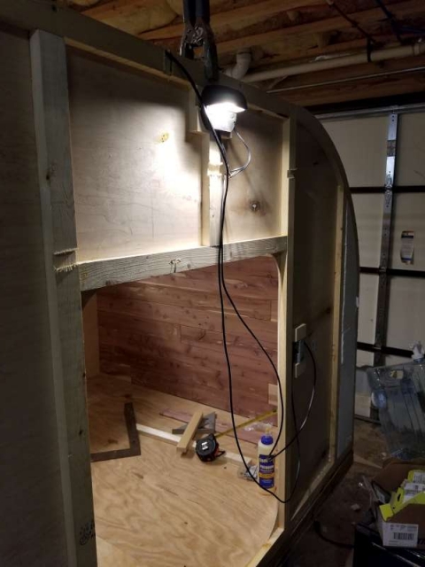

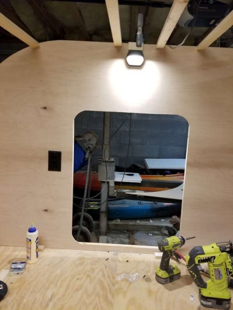

05/22/18
Started installing the ceiling. I was not sure how the cedar was going to bend around the radius, but it went on very easy. Going to take a lot of time installing these on both sides, the ceiling an the roof. I m trying to get a good enough corner, where no additional trim will be needed on the inside.

Postby Carl01234 » Fri Jun 01, 2018 5:53 am
May 31, 2018
My last build a weekender, didnt have much of a galley. This is definately the slowest part for me. I have the galley side cabinet opening cut, top shelf is finished, and an now ready to cut cab side cabinets out. Then on to final electrical. The other door, hinge and trim are being delivered today. Vintage Technologies were great to work with. Placed order on Tuesday and tracking says it is out for delivery. Very fast, knowledgeable people. :thumbsup:

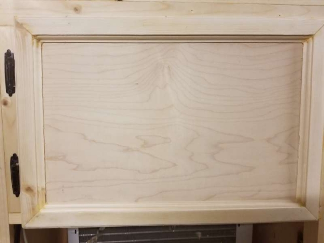

Postby Carl01234 » Tue Jun 05, 2018 7:49 am
June 4 ,2018
Got the window fitted. I remember having trouble getting it sealed last time, and it looks like the seal doesnt quite fit right on this window. I had to use lots of caulk on it last time. I took my time and made sure the opening was as small as possible this time, hopefully it seals better. Did a mock up of the cabinet doors. Take it easy on me, I an no carpenter.
