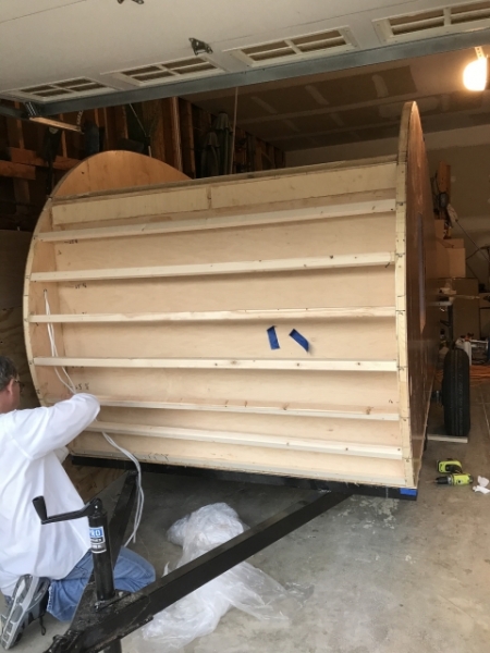

Stand up the walls. We placed vertical pine sticks into sidewalls to catch screws from end walls, pine-to-pine all he way through. Since the outer skins are pretty, we didn’t want screw head showing outside, used Kreg jig on end walls.

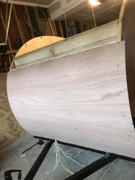

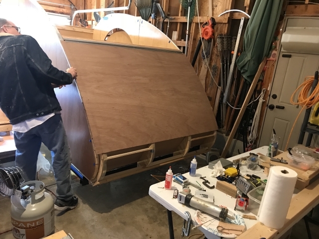

Skin the front. Put in cross braces to catch screws, used glue too. That ¼ inch marine plywood does not bend well, screw heads were on the verge of pulling right through, had to tighten them gradually across. It worked.

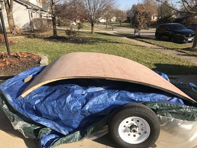

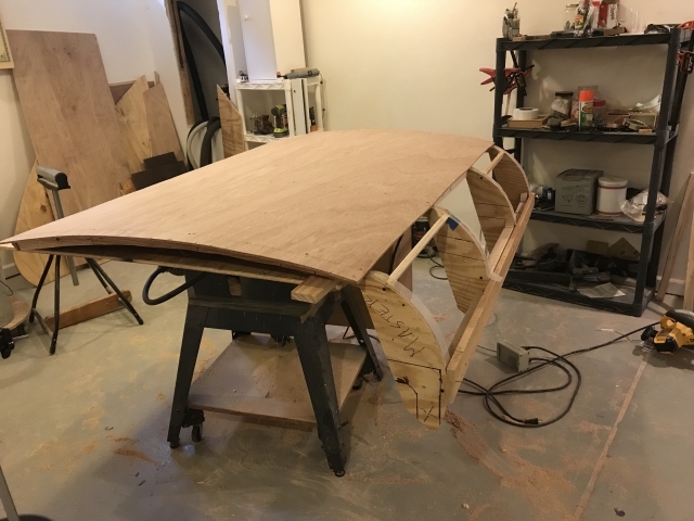

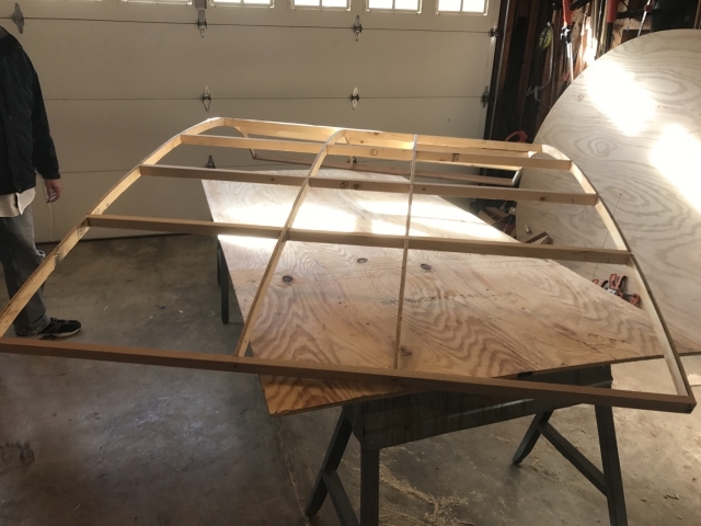

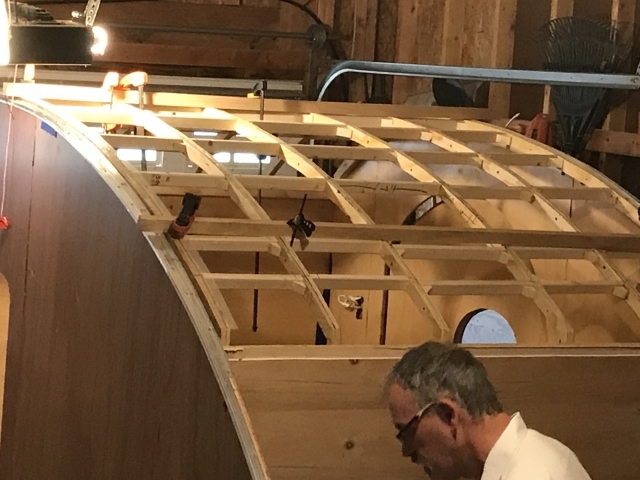

Make a main roof frame. It’s essentially the same as a galley hatch, just bigger. We had a catastrophic failure first time skinning the roof panel. The frame was too light and the skin forces broke it. It had four ribs each a single thickness of ½ inch plywood.
Version 2.0 had 12 ribs, making six stringers each double thickness. Added a reinforcing layer of fiberglass tape with epoxy on top and bottom edges. More weight again…It worked this time. Had a bit of spring back. When I was a schoolboy I built balsa model airplanes that had wings that looked like that. I guess I never got over it.
And we finally get a panel.

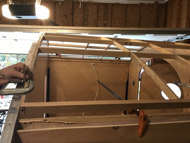

On another thread I chatted with Mr. Lahey about how we ended up putting straight edges and clamps all over to get the ribs to align. If you look closely you see two longer oak straight edges clamped across the ribs, then clamped to the cross members to pull all the ribs up tight against the straight edges keeping things aligned. Also notice a full set of little triangular wooden gussets glued in at each corner.

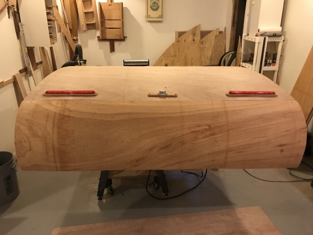

Made a galley hatch, ½ inch plywood ribs, ¼ inch skins inside and out.
The radius on the tail end is only 10 inches so we used bending board. It’s not rated for being wet, so we are relying on extra coats of polyurethane

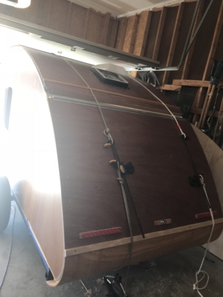

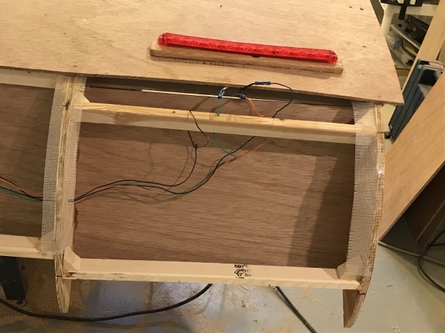

Test fit the galley hatch then assembled it. Spent a lot of time adding oak sticks to edges of the hatch and at the matching wall locations at hinge. We wanted hardwood to hold those highly stressed screws on hinges.
We used ropes and clamps to hold galley hatch in place while we screwed on the hinge.
