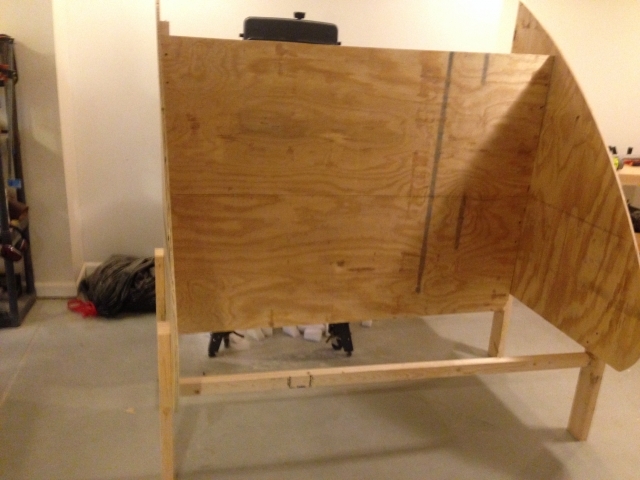

So when we got started building it was winter. We used ½ inch cheap plywood to make a full size mockup of the galley and counter top. Recall we have a full size template so it was pretty easy to make exact shape sides. We built the upper cabinets first, then the countertops, before any walls or roofs. All inside while it was cold out.

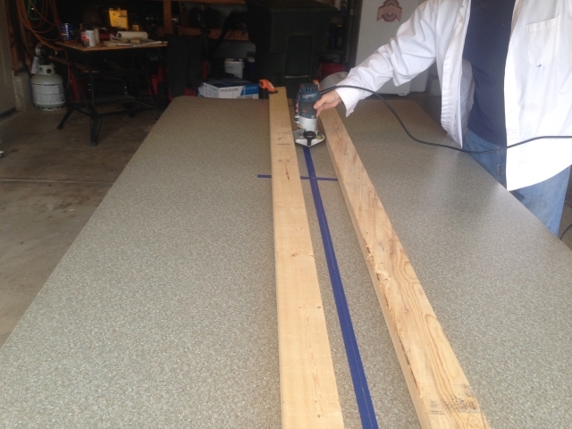

made up the countertops. Used 1/2 inch marine plywood then glued on formica. Cut a full sheet into two countertops.
That's a pair of straight 2 x 4's guiding a trim router with a small straight bit

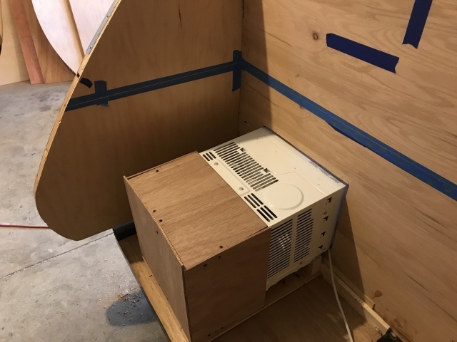

Here’s our window air conditioner. We boxed in the back end at just the right places to capture only the outgoing hot exhaust air. That air box has an open bottom. We cut a vent hole in the galley floor and glued window screen across it. The air conditioner vents downwards blowing out that vent hole.
WARNING! Put a divider under the counter to prevent the air conditioner from pulling air down through the cooktop, and install a large intake louver for the air conditioner. The air conditioner can pull the stove flames down under the countertop and start a fire.

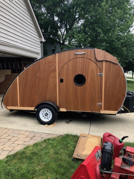

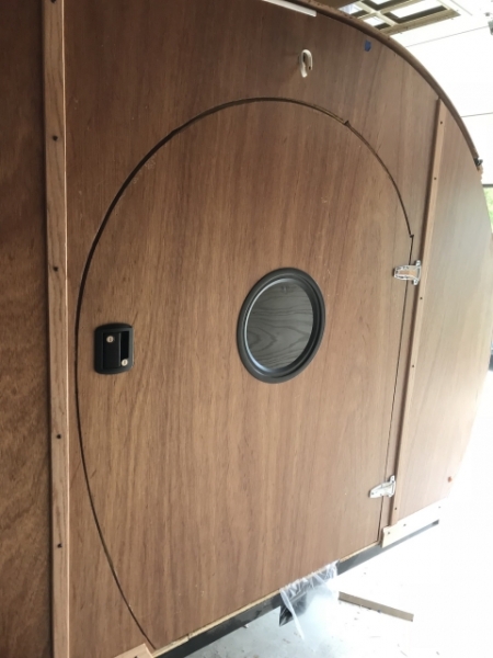

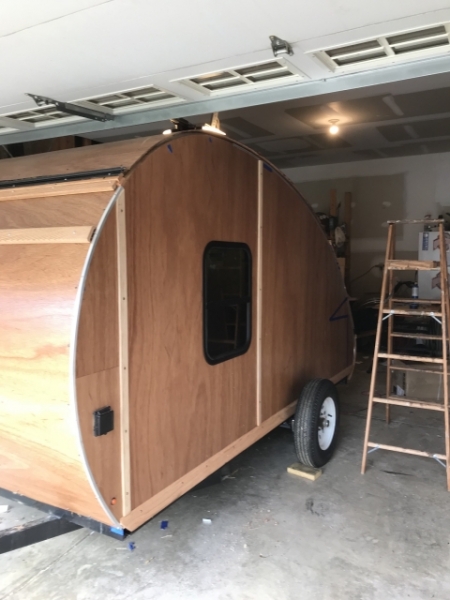

We had work to do on the entry door and sides. The entry door was much trouble. It took lots of fussing with a sharp block plane to get the fit right, but it’s done. We resawed oak to make thin battens that we glued and screwed over the seams. Keeps out water; adds strength; and covers some ugly. We have battens across all the seams, vertical and horizontal on the roof and hatch.

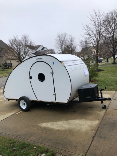

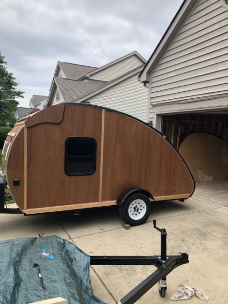

But next step is the second trailer.
We have the frame with axles, wheels and finish floor all built and done for the second trailer. When we made the walls we made both sets, so the walls are ready to stand up.
My buddy wanted the wood siding you see above. We used 1/4 inch marine plywood, meranti, with Helmsman Spar Varnish polyurethane for all outside surfaces, and we used prefinished maple plywood for all inside surfaces.
However I prefer not to have wood siding . My exterior surfaces are built using 1/4 inch birch plywood as the exterior skins on the structural insulated panels, and we have a stack of prepainted aluminum skins to cut and add. All my exterior surface will be white metal like a cargo trailer.

Postby Aguyfromohio » Tue Jun 26, 2018 8:02 pm
The driver side, window and shore power receptacle

Postby Aguyfromohio » Mon May 13, 2019 8:38 pm
So here's the white one with the roof raised and the upper windows installed last weekend.
Notice the full grown man standing in the back corner, plenty of head room. That's my trailer building buddy Mike, he owns the wooden version.

tony.latham wrote:And door seal details, please.
Tony you have keen eye. You can't see the main door seal because it isn't installed yet.
The door and door frame have a matching step profile, and we'll be sticking on small foam weather stripping from the home store on that surface.

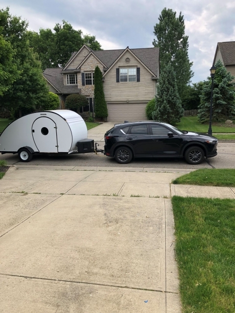

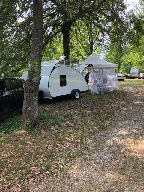

Postby Aguyfromohio » Mon Jun 03, 2019 1:56 pm
So here we are pulling away from the house on our first trip. I did tow it once before, a couple miles to a certified scale to get a weight so I could get tags. But this was the first trip other than that one.
We went about 160 miles to camp with friends at their property.
The trailer towed very well, tracking straight with no wobble or fishtail. I admit to being a bit terrified of getting on the freeway the first time and rolling at high speed.
We had it as fast as 70 MPH and it was all OK. I set the cruise control on 65 and all was good. That little Mazda CX5 as a tow vehicle really rose to the challenge and did fine. But it is woefully under powered at about 180 hp, so on the freeway at every grade it shifted down to fourth gear, and on steeper freeway grades it went down to 3rd gear. Fuel economy was cut essentially in half, getting just 16 mpg overall. But the engine temp stayed cool and it pulled strongly at those higher RPMs as needed.
Here we are set up at camp.
