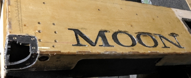

Postby OP827 » Sun Jun 06, 2021 10:09 am
woodslanding wrote:A plastic place in town has 4X8 .020 thick sheets of "PETG Thermoplastic Sheets (transparent)" for $13. That's a possibility.... .030 goes up to $23. but others preferred cheap vinyl cloth on sale from your local fabric store, and walmart seems to have the stuff dead cheap. https://www.walmart.com/ip/Magic-Cover- ... s/23554847
It's funny that I was also looking at these PETG sheets available in my area. I do not know what "G" means (have to ask the supplier) in this material name, but looks like it's a most economical solution out of all plastic sheets. It probably makes sense to leave its protective film on for first trials or use wax to ensure separation. As far as vinyl from walmart of fabric store is concerned, it sure will work, but since it is actually not as flat as more rigid PET film, the resulting surface will have to be more wavy and chasing bubbles could be a bit more complicated. I would say that testing is still required on small scale before attempting the real large surface.
EDIT: "G" must stand for Glycol or "ethylene glycol" as it is one of the Polyethylene terephthalate's chemical reaction precursors.
woodslanding wrote:I suppose I'm going to a lot of trouble just to keep from sanding, but I hate sanding.... and I'm worried my hands are already getting a bit of sensitivity to plastic dust. And though I'm using a mask, I'm sure some is getting in my lungs too.
Me too, so finding a cleaner solution to save time and personal health is well worth it. That is why I am also looking at just using premade skins, but then need to come up with a good solution for covering the sandwich panel seams.
woodslanding wrote:...
I do have some glass going over plywood, though most of it is foam. Did you not coat the plywood with epoxy first, or did you still have the problem of starvation even after that? I figured I'd coat the plywood with epoxy first, but hoped that wouldn't be necessary with the foam...
I did NOT coat plywood with epoxy first, it was a "dry on dry" 1x6oz glass layup. I was trying to save time... So going forward it makes sense to wait some time and saturate plywood and glass thoroughly and not to squeeze epoxy away from the laminate too hard. Again, some more experience is needed here. I must say that some plywood pieces came out OK and yes, on the foam I did not really see similar starvation happening. I was using the gift wrap film since then and would still use it to save time (and actually epoxy), but the latest lamination I did for bathroom area roof stiffeners got the gift the thin film stuck pretty good, so I had to sand it off :oops: . That is why I am looking for a thicker PET(Polyethylene terephthalate) film. This method works only on flat or non-compound curve surfaces that can be made of sheet goods, which are foam boards and plywood sheets.
