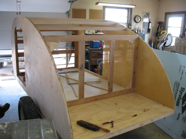

Postby bbarry » Fri Jan 07, 2011 7:26 pm
Sorry, I appear to be hijacking your thread a bit.
You are correct: there is a full frame under my first build, I was drawing a parallel as my axle force also enters the body inboard of the sidewalls (just spread much more due to the full frame).
I wasn't very clear, the bulkheads I was talking about were not chassis frame members, they were integral parts of the body. Below you can see the rear bulkhead and there is another at the head of the sleeping area.
Similar structural features (not full height) might allow for a minimalist frame, but I can see why it should be at least somewhat different than the ultralight. If you do end up designing a custom chassis, I'll be curious to see what you think would be best.

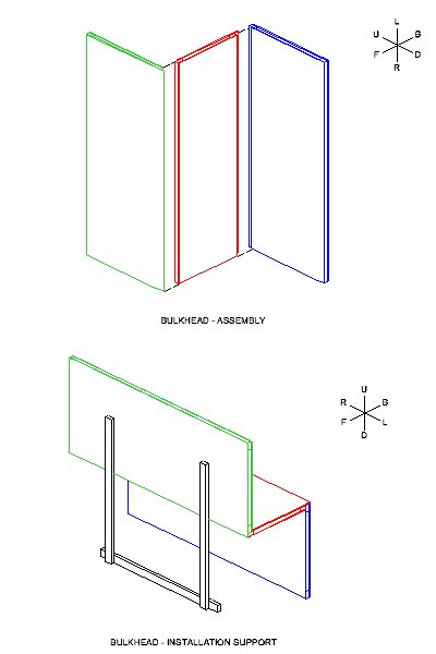

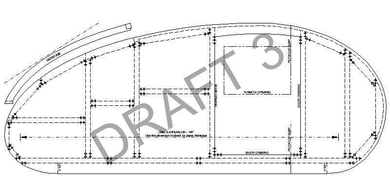

Postby angib » Sat Jan 08, 2011 10:58 am
Actually, I did get 75% of the way through doing a set of plans for soemone to sell in the US. The idea was that you would get a full-scale paper CAD sidewall template:
And then a complete set of step-by-step plans to build a Cub/Modernistic, like this draft section on the bulkhead:
But it never got finished, which didn't disappoint me as I never was happy with the idea of selling plans for which I hadn't first built a prototype.
