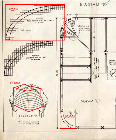

Postby GPW » Sat Apr 30, 2011 8:24 am
If the rounded corners are the problem , just make them out of foam , shape it like you want , and then fiberglass over it ... Easy !!! Maybe do all the roof edges like this and make it really "bread loaf" rounded ... No extensive woodworking or metal skills involved... :thinking: Love those old designs ... :thumbsup:

Postby aggie79 » Sat Apr 30, 2011 6:07 pm
GPW,
I like your thinking. I do plan to skin it with glass cloth and epoxy, so I adding the foam corners would simplify things.

Postby GPW » Sun May 01, 2011 6:41 am
Thanks Tom , I've always loved those Rounded trailers... and am Not a metal working guy , but Foam is so easy to cut and shape ... The glass just makes it permanent ... I guess if the Old Timers had these materials available they would have used it too instead of cutting all those little wood arches .. That's a Lot of work .. :o

Postby aggie79 » Sun May 01, 2011 10:15 am
Rob,
That is an interesting picture. I have read that several of the breadloafs had canvas roofs and Masonite skins. I guess the fiberboard corners would be similar to Masonite.
At one time, I had kicked around the idea of using sonotube for the curved edges (covered with glass cloth and epoxy). It seems though that curves are actually elliptical rather than radial so the sonotube can't make that shape.

Postby GPW » Sun May 01, 2011 11:50 am
Gosh , that is an awful lot of seams to deal with .... No wonder they covered them with canvas... :o
I recall the old mentions of fiberboard , being like a type cardboard ... :roll: guess once it's sealed and painted (and covered with canvas) it' not going anywhere... :thinking:

Postby Wimperdink » Mon May 02, 2011 6:47 pm
Not sure if this would work or not with my limited experience with fiberglass but..... What about Fiberglassing over a little more than half of a large beach ball with some epoxy/mat or lay it up with strips of cloth paper machete style. Do all your smoothing and sanding. Then all you would have to do is cut along the equator, then quarter it after its all dry and peel the plastic from the ball out.
You could design your side, front, back curves all to the same radius as the beach ball your using.

Postby GPW » Tue May 03, 2011 7:53 am
W, that should work !!! Cool idea !!! :thumbsup: How about fiberglassing Inside half a proper size plastic ball ... that way the outside would be slick and ready to finish ... no sanding and filling .. get 4 corners too .. :thinking:
Posts: 14375
Postby Wimperdink » Tue May 03, 2011 11:11 am
GPW wrote:W, that should work !!! Cool idea !!! :thumbsup: How about fiberglassing Inside half a proper size plastic ball ... that way the outside would be slick and ready to finish ... no sanding and filling .. get 4 corners too .. :thinking:
I thought about that too but I couldn't figure out where to find a plastic ball large enough and hard enough to maintain its spherical shape long enough for the epoxy to dry. Gotta remember when you cut it in half or almost in half that its going to loose its strength to maintain shape. Also it would have to be a decent sized ball to get the radius right.
How big do those styrofoam balls from the craft stores get? Just fiberglass over it and leave the foam in place for insulation.

Postby Wimperdink » Tue May 03, 2011 11:29 am
Also I suppose if you wanted to go through the trouble.... You could use one of those big rubber kids balls..... (The ones you always want to rip out of the rack at wallyworld and throw at your buddy) While its aired up, submerge half of it into a plaster bath.... then when its dry cut off the part that still sticking out, and glass the inside of it, break the plaster, quarter it, and peel the rubber off and have a nice smooth outside finish.

Postby GPW » Tue May 03, 2011 1:25 pm
W, EXACTAMUNDO !!! :thumbsup: Guess it would only be practical if you were going to make a Bunch of them ... :roll: Now the ideal thing to do is make a mold and include some tabs for attachment coming out the sides/bottom , the whole corner slight raised to accommodate the roof and side material .. Install the corner then sheet over the edges ... :thinking:
