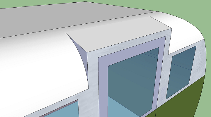

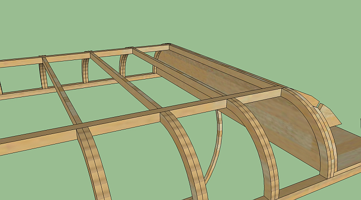

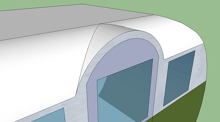

The beauty of Tom's idea to merge a Westcraft back end and an American Homecrest front end is that there are no ball corners. The only double curves are at the back corners and since it wraps around a much larger curve I think with enough ribs some 1/8" ply, fiberglass, epoxy, plenty of Micro bubbles and a little patience you could come out with a pretty fair corner.
Doug brings up some really good points the first is the front and back upper cabinets, they are in all the vintage photos as well. They not only hide the tough to deal with inner corners I personally think that they add much needed structure to all those merging curves. Kill two stones with one bird if you will. I would plan on it being an integal part of any breadloaf design. If you want to keep your roof that is.
The other point is the door, the first thing I noticed when I started drawing a breadloaf is that the side curves cause problems with the height of the door. Either those original ones were really tall or you had to stoop at the door. The two options I came up with were the slanted dormer like you actually see on some of them.
Or the round dormer that makes me think of a Bowlus. Now there is a tough camper to build, but oh so cool.
The drop floor or drop footwell Tom mentions would both help, with the door issue for sure and then there is always stooping, which should be second nature to anyone use to an actual teardrop.

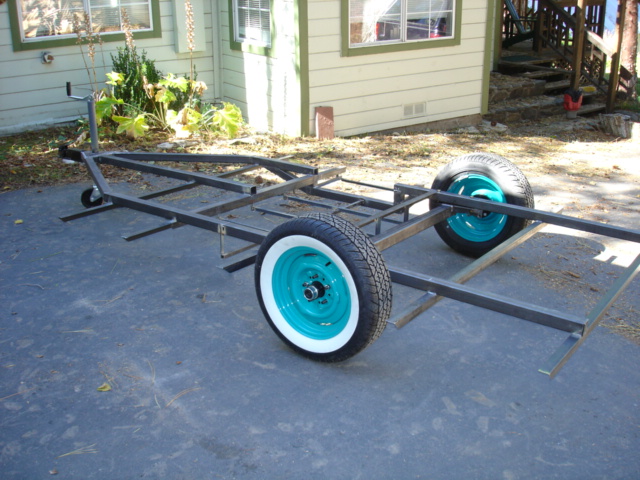

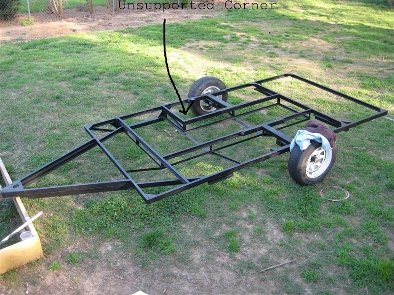

On the frame discussion. Sorry to those who have seen this already.
The rotational forces that result from using torsion stub axles concerned me as well.
In the photo below the driver's side was solid when tested with a load, however the passenger side axle would rotate mildly. The outside corner of the drop floor (near middle of trailer) would drop slightly under increased G's as the inner passenger side rail that would normally provide support could not be tied to the forward transverse due to the short leg of the drop floor.
My solution for the problem does not show in the photo. I welded a run of angle from one side of the trailer to the other (outer rail to outer rail ) under the drop floor under the unsupported outer corner of the drop floor pointed to in the pic.
Additionally, if the drop floor frame looks odd at the door it is because I had yet to remove a the section of outer rail visible in the photo where the door was to later be.
The camper has left the ground many times while in tow and loaded without discernible flex or incident.

Postby aggie79 » Thu May 12, 2011 9:36 pm
John,
Thank you for the picture and your experience with the stub torsion axles. If I go the drop floor route, I'm going to have to do something like what you did or have "arches" built on the frame rails.
Take care, Tom

Tom, You might get away with the straight axle if you drop the floor only back to the axle, so it all depends on your design. With your idea being a larger one this might not be feasible tho, but just a thought.
Thomas
2bits
2bit Member
Posts: 5013
Images: 16
Location: Lake Tawakoni, TX
Postby john » Thu May 12, 2011 11:16 pm
If I were doing it again, this is fairly close to what I would do. The only difference would be that I would drop the entire floor forward of the axle.

Postby doug hodder » Fri May 13, 2011 9:28 am
I used a full regular torsion axle in this frame. How it works out is that I have a small step between the floor and the bed, 5" high and maybe 1'deep. It works out fine for height on the bed and sitting on the edge of it.
The axle-less spindles would provide a full low floor all the way to the bed, but the more I think of it. It would keep the rear of the trailer lower and run the risk of dragging, so I'd have to put a lifted portion back there anyway. I'm thinking that maybe the cost of those spindles wouldn't be worth the dough or hassle to keep a floor that low.
On the Nomad, I have a raised portion on the front dinette, and head clearance is minimal for me at 6'2" with the canned ham profile. The Bread Loaf profile will give more headroom so I think I'd just do the lifted front portion as well, again to prevent dragging.
