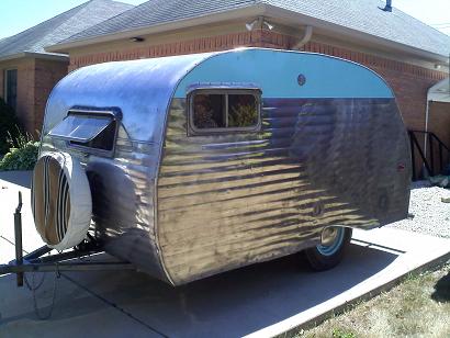

Postby prohandyman » Mon Sep 05, 2011 4:08 pm
Bright anodized is what this aluminum is, then creased.
Here is a pic of my '60 Scotty that I polished from a very oxidized finish...alot of work but worth it.

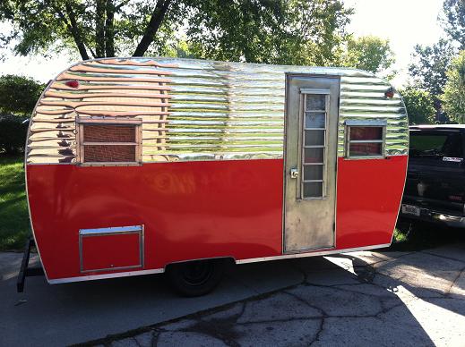

Postby prohandyman » Thu Sep 29, 2011 2:41 pm
Well drug the Yukon out in the sun today. Taking it to Newport Hill climb tomorrow. Whew...alot of work...I think I will stay with teardrops and Tiny-er
travel trailers.

Postby Verna » Thu Sep 29, 2011 6:21 pm
Pretty!!!! With that shine, you're going to be blinding people driving near you on the road, Dan!!!
