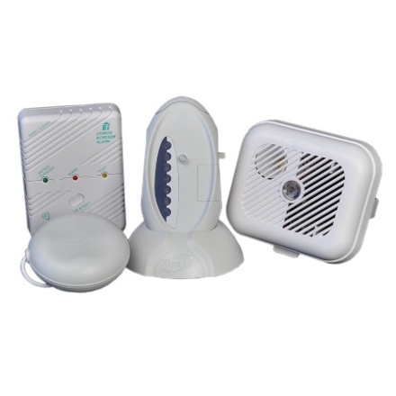

It might not a bad idea to mention here that, in any small space with combustion appliances, CO is a significant hazard.
It too is heavier than air in, in most of these trailers, folks are sleeping on the floor. If you're running appliances while you sleep, a roof vent won't give the CO anywhere to go. The primary symptoms of CO poisoning (drowsiness, dry mouth, and headache) will go unnoticed while you're sleeping and it's cumulative, so minor exposure over several hours will still allow it to build up in your blood.
I don't mean to sound like a Nervous Nellie: the risks can be mitigated safely and quite easily and will make camping much more enjoyable....but they do need to be addressed with any combustion device and this IS a safety thread after all....
A CO detector installed down low is cheap insurance and will jar you awake before the concentration gets too high.

There are many co alarms out there.
Travel type and house type
Several brands look around and see what will work for you.
In my house I have one we got at HD and it has a woman's voice come on that says either fire or carbon monoxide and a loud noise.
