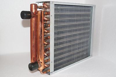

Postby lrrowe » Thu Feb 11, 2016 11:53 am
MtnDon, Shadow Catcher,
Look at the premade hot water/air exchanger I stumbled across today. A 12" x 12" is $68.
http://www.ebay.com/itm/Water-to-Air-He ... kdKt24HSyQ
When my system needs an upgrade, I may consider it.
In fact, I may see about a larger one for my radiant hot water heat in the house going through a larger one put in my air handler.
Bob
