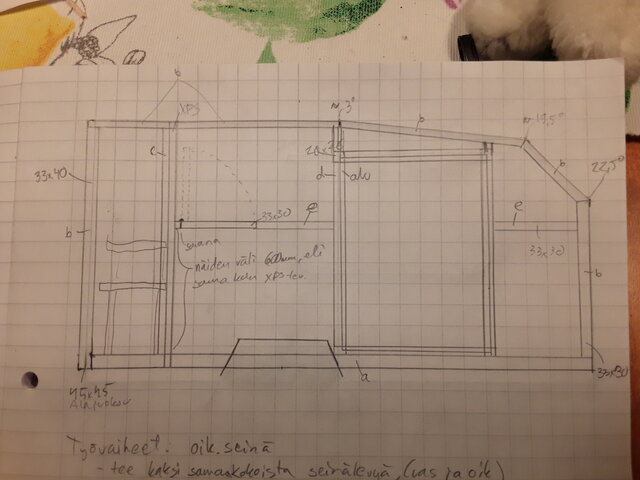

Only have simple plans on paper, as this project was supposed to get me away from the computer and reliev stress. But here I am, loosing sleep with construction ideas flying around my head and brain solving problems while my family is still sleeping on a Sat morning. :lol:

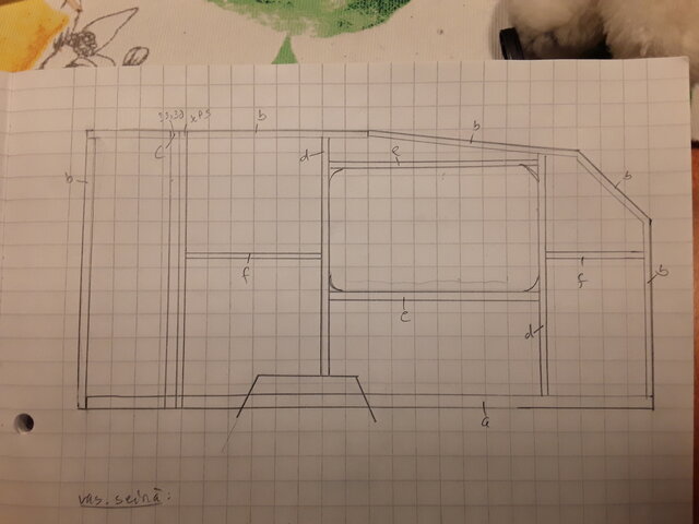

Is there a reason you want wood in your build. Is it your preference or do you feel you need the wood to make it strong? You can do away with most, if not all, your wood structure shown in your drawing above. You just have to have faith that the foam and canvas is plenty strong by itself.
My builds use wood in the floor, 1/4" wood inserts around the door and 1"x3" lumber for shelf facings. There are a few places I use roof flashing. The rest of the build is all foam and canvas.
Something to consider is that XPS foam contracts and expands faster than wood and the less you wood you use the less problems you will have. I have been beating on this trailer in the back country for a few years now . No problems at all so far. You can check out the channel for other trips I have taken the trailer on.
Good luck! George.

Actually I spent quite a long time planning and trying to make up my mind about going full foamie, woodie or hybrid. I'm confident foamies are durable enough for my usage, but as this was supposed to be a fun project for me and i like working with wood so this hybrid felt like the best option to me. This also gives me the benefit of getting to experiment with new stuff (XPS, PMF etc.) on this being my first build. I have a feeling this will be my learning project that will maybe someday be followed by a little bit bigger and fancier build.
And I found a suitable glue in my local harwarestore, a water based contact cement. It held up really nicely in my tests.
