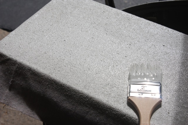

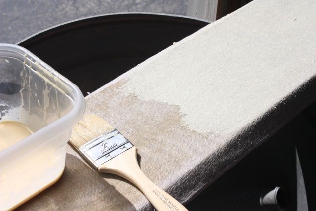

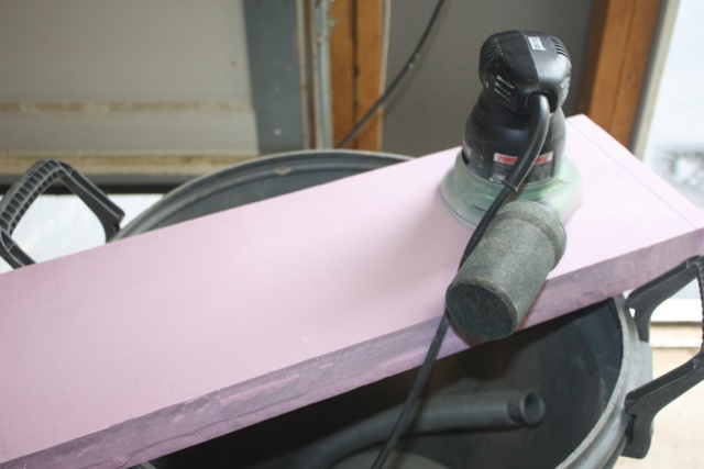

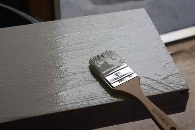

Okay, I went out and did another sample... I realized that I really like the adhesion of the exterior latex enamel on wood, but I never tried it on canvas...
So here I am doing up a sample on canvas...
And last, but not least, here's the titebond II sample I started yesterday. I've added the thinned out titebond II to the top... I noticed that the cloth was only about 80% saturated. Maybe I should have done what Anita did, add the diluted Titebond II at the same time. I'm wondering if that will hurt the full strength glue underneath... Probably not!
Anita, I will revisit my samples after they have cured a bit longer. Cone is right, the adhesion will get better. Also, the larger the surface area the harder it is to pull off, as you experinced pulling the cloth off the side of your trailer. Can I ask, why did you pull the cloth off the sides?
