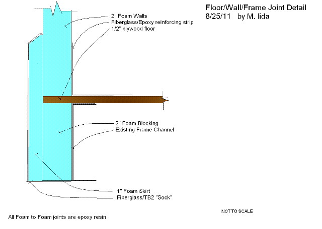

I think I have finally figured out how I want to attach the walls to the floor and frame. I've attached a sketch below. I used Paint to draw it, first time I've used it, leaves lots to be desired.
Anyway, do you think this joint will work? There are also bulkheads in the front, middle and rear for attachment and strength. I'll be using epoxy for all the foam to foam and foam to wood joints and the entire outer surface will be covered in fiberglass and TB2. I'm thinking of not using any adhesive between the foam and the frame since the floor is bolted to the frame and the foam is epoxied to the floor. Do you think that's a good idea? Anyway, I think this will work but I worry I've missed some engineering principle.
So, Is it a go or "no go"? :thumbsup: or :thumbdown:
Your feedback is truly appreciated!

Looks Good to me ... :thumbsup:

Postby Wobbly Wheels » Fri Aug 26, 2011 9:37 am
Hey Mel,
I've been playing around with epoxy and foam as well and I have one suggestion, but it's really only an opinion at this point.
The epoxy doesn't saturate the foam the way it does the wood fibers so those joints might not be all they could be. What might work better is to glue on the skirting as shown, then drill down through the floor and into the foam and epoxy dowels in. That will take any shear loading and will avoid a weak line where the epoxy and foam meet. If you have a table saw, shallow cuts down the dowels' length will allow more surface area for the epoxy to bond (or fluted dowels if you can find long ones).
I assume you know that you'll need a fillet on that inside corner and it just didn't make it into the drawing. Give SketchUp a try instead of Paint - it's another free download from the Google empire.
I've also found that cabosil seems to be a better thickener than wood flour for bonding foam: not sure why that would be but the difference is noticeable.
Have you thought about your layup for the outside yet ?
I'm thinking two units of ~6oz (one 90 and one biax) and veil for the finish but I'm still looking for ideas

Postby mezmo » Fri Aug 26, 2011 3:26 pm
Hi atahoekid/Mel,
What are you using for an inside covering? I'm an advocate of
redundancy/backup within reason and possibility. One such
scenario for that would be to use a 6in high 1/4-1/2in thick "baseboard"
glued to the foam at the bottom of the wall [you could dowel through that
into he foam if wanted] and have a cleat at the juncture of the baseboard
& floor that would screw into the wall and floor, and then reinforce that
with the fiberglass tape/cloth and resin, with the fillets as mentioned by
Wobbly Wheels/Brian. The cleat may not be necessary with the fiberglass
and resin and filet, but that's a personal decision.
Also, I'd glue/epoxy/silicone the block of fill/spacing foam to the steel
frame. Whatever extra holding help that'd give is a plus, but I'd mainly
do it for frame corrosion protection in the 'future'. If the foam is just
butted against the steel frame with nothing between them, it is an open
joint allowing water and road grit to intrude and act like an abrasive
slurry to eventually cut through the frame paint and then become a
pocket of/for corrosion over time.
Good Luck on the build as you go along
Norm/mezmo.

Postby atahoekid » Fri Aug 26, 2011 11:21 pm
GPW - Thanks for your approval. It takes a load off of my mind. I'm really trying not to overbuild as is my tendency, yet I don't want to build too light and have it fail. You seem to have struck the balance that I haven't been able to do yet.
Wobbly - The dowels are certainly a consideration, I will look at when the walls are up and before I seal the inside walls. Thanks for the sketch up reminder. I played with it for a while and I do think it's a whole lot better program than Paint. As far as a covering, I'm going light. I'm looking at 1.4 oz cloth set in TB2 instead of epoxy like GPW did in his build although he only used the fiberglass tape in the corners. I think I would get the same ultimate result without the expense and major mess of epoxy
Mezmo, I'm planning on lining the interior with a very thin plywood, maybe some paneling if I can find some that doesn't look tacky. Maybe FRP panels. Somewhat up in the air! Just something to provide a bit of additional strength and rigidity
Thanks for the thought about bonding the foam to the frame, I hadn't thought about the moisture and grime. I will definitely bond the foam to metal somehow.
Thanks for all the replies. It's nice not to have to rely on my own thinking!

Postby GPW » Sat Aug 27, 2011 5:28 am
Mel , overbuilding with Foam doesn't seem to have the same weight consequences as building with wood ... and with a good outer skin and a ply (paneling) inner skin it should be Very STRONG !!! :thumbsup:

Postby atahoekid » Sat Aug 27, 2011 10:17 pm
GPW wrote:Mel , overbuilding with Foam doesn't seem to have the same weight consequences as building with wood ... and with a good outer skin and a ply (paneling) inner skin it should be Very STRONG !!! :thumbsup:
Unfortunately, as I am thinking/planning about the build, I keep hearing myself say "Maybe I should put a piece of plywood/wood there". That is going to add up to a lot of weight if I don't stop myself... :? :shock: :?
