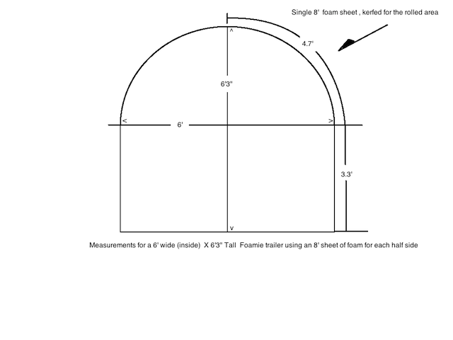

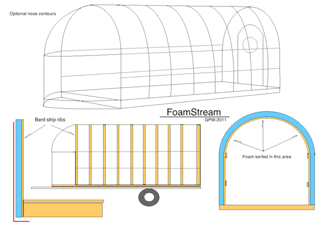

The thing about using foam is its easy to make interesting shapes with very little extra work. Having angles makes the structure stronger

starleen2 wrote:Making the front curve – remember the ¾ inch lamenting strips in the first few photos (go back and you’ll spot em’) – they are for the front curve. I did this on the Ladybug and it worked really well – so I’m doing it again. Here you see it being glued together.
Gotta love them clamps
Done. I added a few staples to secure everything and prevent delamination. A little touch up with the belt sander will level any imperfections. Now I need to make one more like it – except in the reverse and then on to the framing. 50 # Bag of sand makes for a good weight
