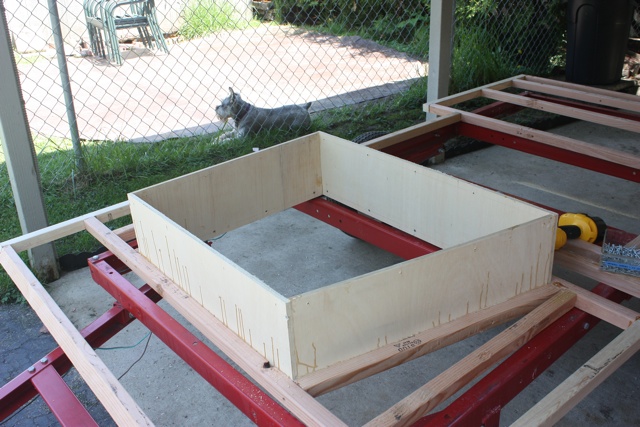

Besides working on the keyed attachment method, I also started working on the dropped floor...

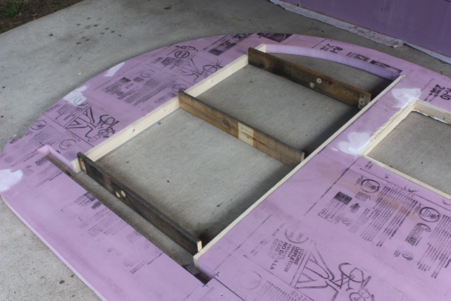

I also cut out the door, and I glued in some side supports for the door frame

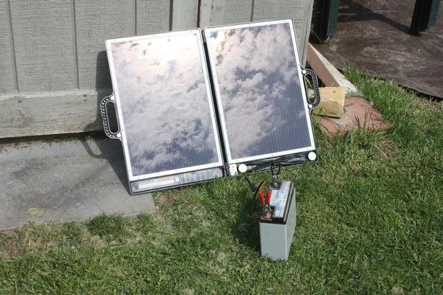

And now that I am whipped, I dragged out the solar panel and the battery which I'll be using on the 10' standie
It doesn't look like I got much done, but I've been out there working on that stuff all day. :duh:

Nice depth to the dropped floor Mike, what's the overall outside height going to be?

Steve_Cox wrote:Nice depth to the dropped floor Mike, what's the overall outside height going to be?
Steve,
As designed at was to be 84" from the ground to the top. But that was with the axle above the springs. I've left the axle below the springs, which will drive it up another couple inches. :shock:
