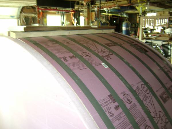

Today I attached the sides to the floor and added about half of the roof. I decided to try out the construction adhesive made for foam by Locktite. Seems OK but the Gorilla glue might have been better. I'll let you know how well it holds after it is completely cured. I'll be adding more pictures tomorrow or Sunday. The point is, with just half of the roof added, the structure is starting to feel rigid without the benefit of the skin yet.
