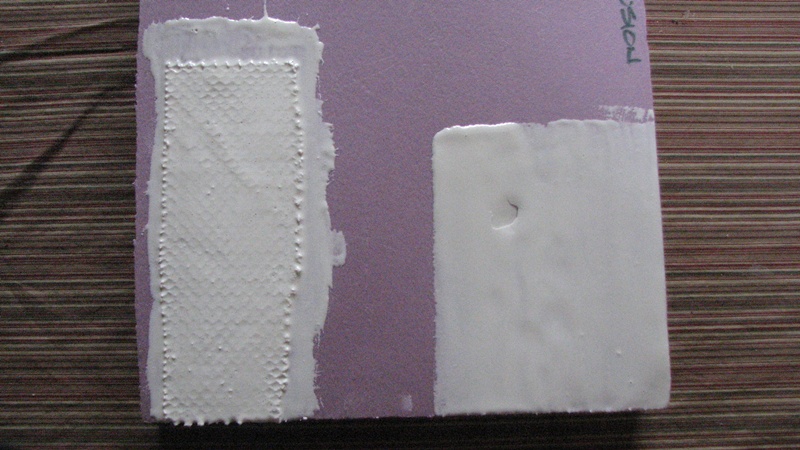

eaglesdare wrote:the foam fusion dries clear?
have you tried a foam to foam joint yet? or is that what you said you will be testing next? i will be interested in that.
thanks for doing this. what i don't like is the "skill" needed to apply and get that even coating. i don't think i have the "skill" or patience needed for that skill.
but i like what you have, that i am seeing so far.
swampjeep wrote:can the coating be sprayed? that should leave a very even thickness, unlike a brush or trowel.
atahoekid wrote:swampjeep wrote:can the coating be sprayed? that should leave a very even thickness, unlike a brush or trowel.
On the Hot Wire Foam Factory website, they state that it is sprayable. It's pretty thick so I think you'd need pretty good equipment. I agree with you that you should get pretty nice coverage doing it that way. I'm going to send a question to my contact at HWFF and ask about spraying. I'll post their answer here.

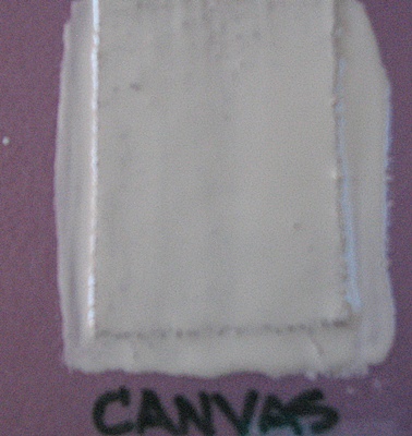

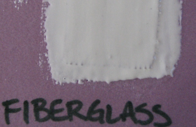

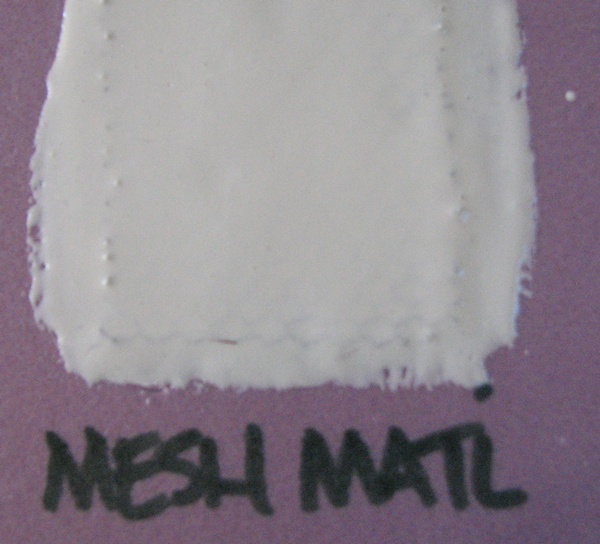

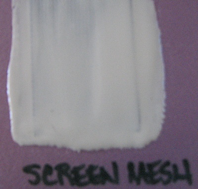

linuxmanxxx wrote:Can you get a closer shot of the first one so we can see how it looks like laying over the weave of the screen and different things?
