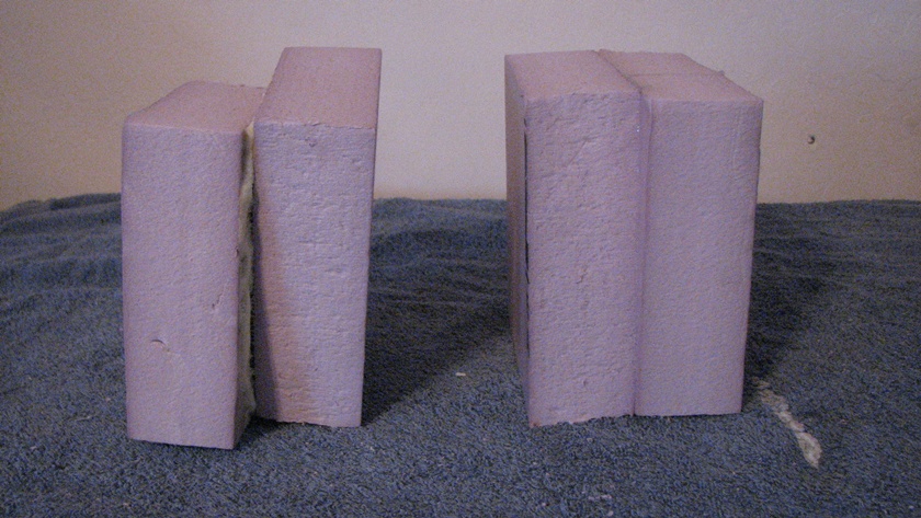

Here are the rest of the test samples that I put together with Gorilla Flue and the Foam Fusion.
Below is the joint sample made with Gorilla Glue. After letting it cure for almost a week (don't know that you need to wait that long, I just couldn't get to it for that long) I tested the joint till it broke. You can see from the sample below that it is the foam that broke, the glue held well.

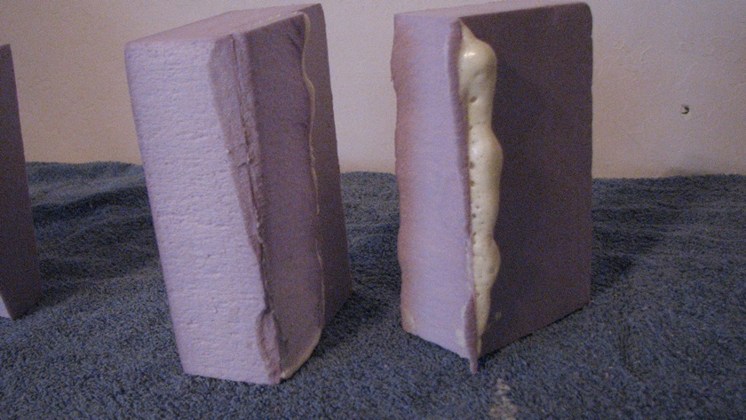

Below is the sample made with Foam Fusion. Like the Gorilla Glue it took broke at the foam, the glue held well.

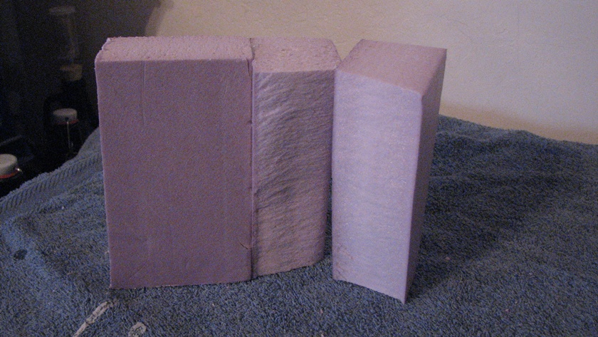

Below are the face glued samples. I could not break either of the joints
Here are my conclusions about the two different glues. They both work well, they both make incredibly strong bonds. Foam Fusion may take a bit longer to cure. HWFF suggests that I should use less glue. Gorilla Glue may cure a bit faster but it is messier to work with.
You can't go wrong with either glue. It's your choice.

Thanks for doing this. Did you apply any clamping pressure when gluing up? I used some solvent free contact cement on a sample the other day and when I pulled it apart later it also did not break on the glue line. Only problem I can see with contact cement is that the surfaces to be joined have to match as perfectly as possible so pressure needs to be applied to make sure there are no gaps. Contact cement is not a gap filler as gorilla glue appears. How was the Foam fusion in that regard?

I’d think the FF glue would require close tolerances , whereas the gap filling property of the GG could be used for “coarse” construction , used to great advantage on mine ... :oops:

For the joint and edge to edge test (earlier post) I used some light pressure with a clamp. I intentionally used a rough surface where I could just to see if it affected the joint. From what I could tell it makes little if any difference. For the face to face joint it was smooth surface to smooth surface and I weighted it down with a 5 gallon glass water bottle.
